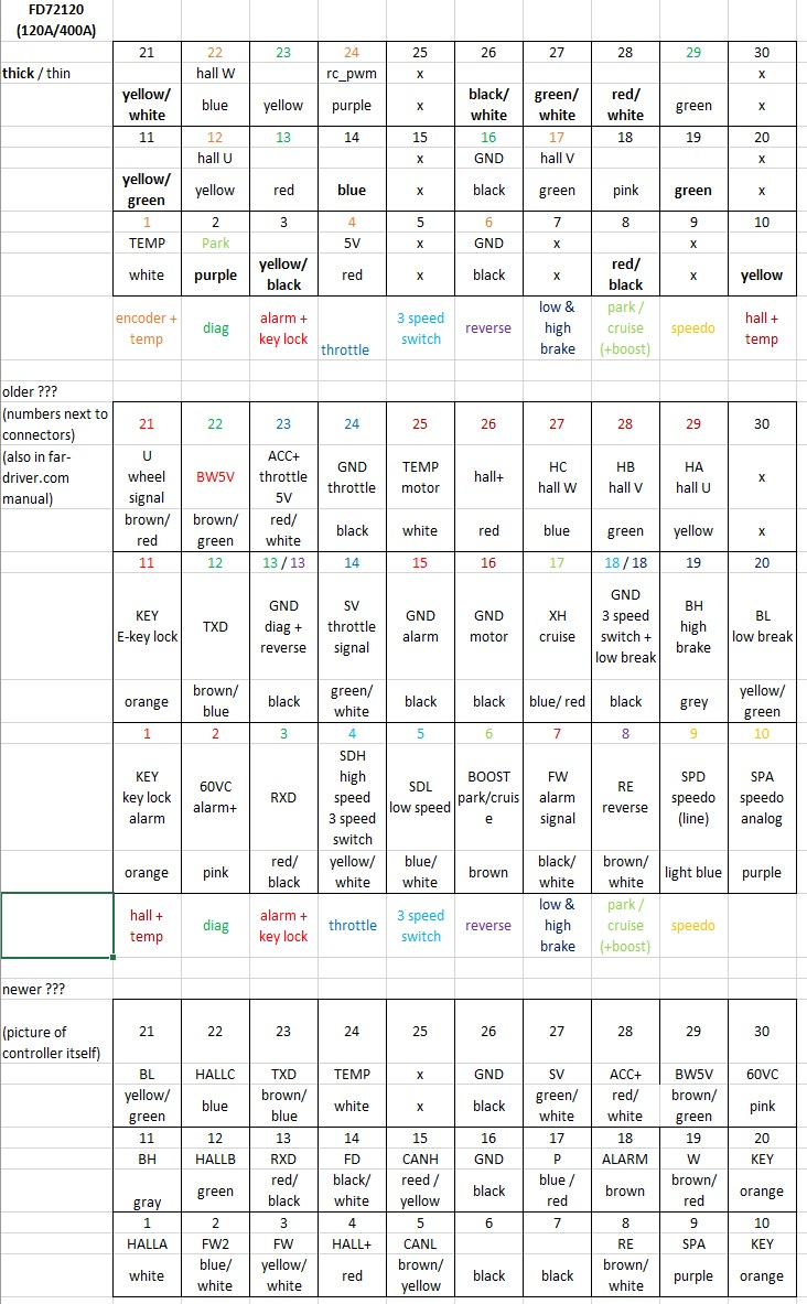

This is colors of actual wiring = our colors (I hope you have same colors). I made it few weeks ago when I was thinking about different controller so I needed to find encoder wires. See that 7 pins is unused ? Yes, some wires splits and go to two connectors but still it makes me believe that those unused pins are for functions that our "custom" controller made for Dayi does not support.
This is "wiring definition" that can be found on Aliexpress etc. As you can see, colors are totaly different from ours. And there is only one pin unused (30, do not look at free 22, it is explained in next text).
This is wiring pinout from manual downloaded from far-driver.com, totaly different from previous one. Again, colors does not match our colors. What matches is that again only one pin is unused.
This is harness picture from manual downloaded from far-driver.com. Check nr. 22, in previous picture it should be blind (no wire) but here it is 5V for diag so I guess it was forgotten to be written into previous picture.
I took harness that came with 72680 and it is similar to that tab from Ali (2nd picture) so I made this tab - I followed every wire to the connector and because it is easy to distinguish them I was able to describe every wire in tab. This is wiring pinout of 72680. Hope I did not mistake somewhere but I am pretty sure I did not. I also hope that this tab can help switch some options to correct pin (at least this is how I understand it works - controller can be said to take signal for specific function from specific pin).
According my previous tab I corrected numbers of pins in harness picture.
If I will not be able make bike work properly by controller settings, there is only one way left - change the wiring.
Because as you saw on first tab, our actual 30 pin connector has 7 pins unused, it has to be replaced with 30 pin connector that came with 72680.
Then is only one options - cut off actual 30 pin controller lets say 20 cm from begining, follow every wire to every connector, put proper wires into proper (female) connectors and connect them into connector of new 30 pin connector that came with 72680 so every wire will be on proper pin of controller.
Second option would be unplug and take off complete wiring and make new one starting from new 30 pin connector, but this option would require lot of new wires (if you do not use old harness).
Damn, I thought it would be easy plug and play replacement :) :) :)
