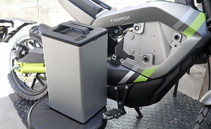

Tromox Mino B - Removal of cowling
https://mihiro.sakura.ne.jp/shimoken/mino-b-004.htm
