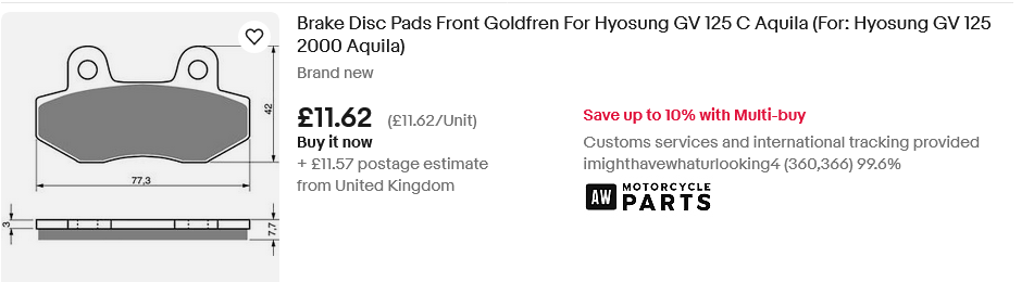

Hello Miguello80,Miguello80 hat geschrieben: Mo 1. Apr 2024, 22:50 ...
Does anyone know where can I buy it ? Or even better same dimensions (70x35 mm body / 67,7x31.6 mm pad) but different brand ?
These - Reeco RL8062 B6 114901 (for front brake calipers WITHOUT red "buttons"):
look for brake pads for: "Hyosung 125 GV Aquila 2000", they are the same and will fit for our E-Odin 2.0.

I am affraid that these fit only calipers with red buttons, not in my HSK calipers, they are wider (77 mm).jeff-jordan hat geschrieben: Di 2. Apr 2024, 12:27 look for brake pads for: "Hyosung 125 GV Aquila 2000", they are the same and will fit for our E-Odin 2.0.
Do you see the difference ?
yours: my: I would be happy if I am wrong

to confirm my previous post I asked my friend with calipers with red buttons to bring me his front brake pads and compared it with my front brake pads, see the photo, and as I expected it did not fit my caliper. I found a seller on Aliexpress that says "official Reeco seller" so I contacted them and they answered that they do not have these pads in stock because they supply with them OEM manufacturers directly. After I explained whole situation they offered me a custom production. But one batch is 16 pairs
Finally they said that they will make a small portion for aftermarket in less than a week.
