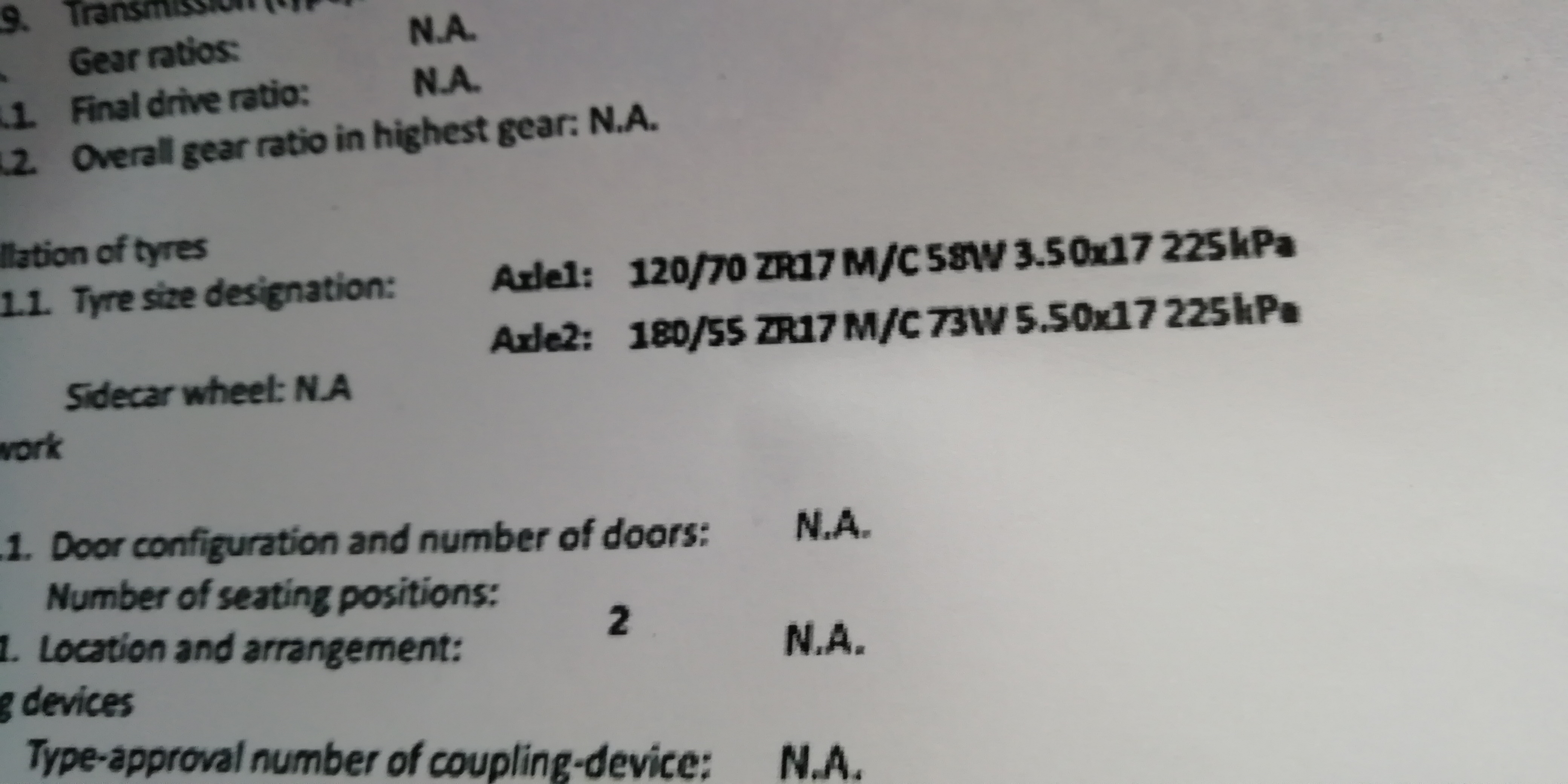

Hi guys,
well, nobody sent me COC list for 10kW so I am not able to ask DMV and find out the law requirements for changing 6kW motor for 10kW
At least, can anybody look into his 10kW COC list and tell me what size of rear wheel rim is written there ? 5.5" with 180/55 R17 or 6" 180/70 R17 ?
Thanks.
Thanks.

Re: E-ODIN - Diskussionsthread
Hi Miguello, bei mir ist allerdings von Anfang an auch ein anderer Vorderreifen eingetragen, da Auslieferung mit MAXXIS-Reifen war.Miguello80 hat geschrieben: Fr 23. Aug 2024, 16:07 Hi guys,
Oh man, thank you !Zimmermännche hat geschrieben: Fr 23. Aug 2024, 18:47 Hi Miguello, bei mir ist allerdings von Anfang an auch ein anderer Vorderreifen eingetragen, da Auslieferung mit MAXXIS-Reifen war.
So the same as 6kW Odin. I believe 10kW motor should fit into 6kW's swing arm, if it has the same 230 mm dropout (width inside the swing arm).
My buddy will ask his friend with connections in China to try to buy two 10kW AMR motors. There is no chance to buy that motor separately, at least here in Czech Republic.
Because there is no informations about "AMR" motors + they do not have temp sensor, I am looking also on QS and Yuma motors. But it seems that they do not produce 10/11kW motors on 5.5" rim, only 12kW on 6" rim but that is not so important, 180/55 R17 will fit 6" rim so the motor replacement should not be too obvious when 12 kW is over the legal limit
But this is a big future, now I am buying EV so money goes there.
Anyway, thank you again.
