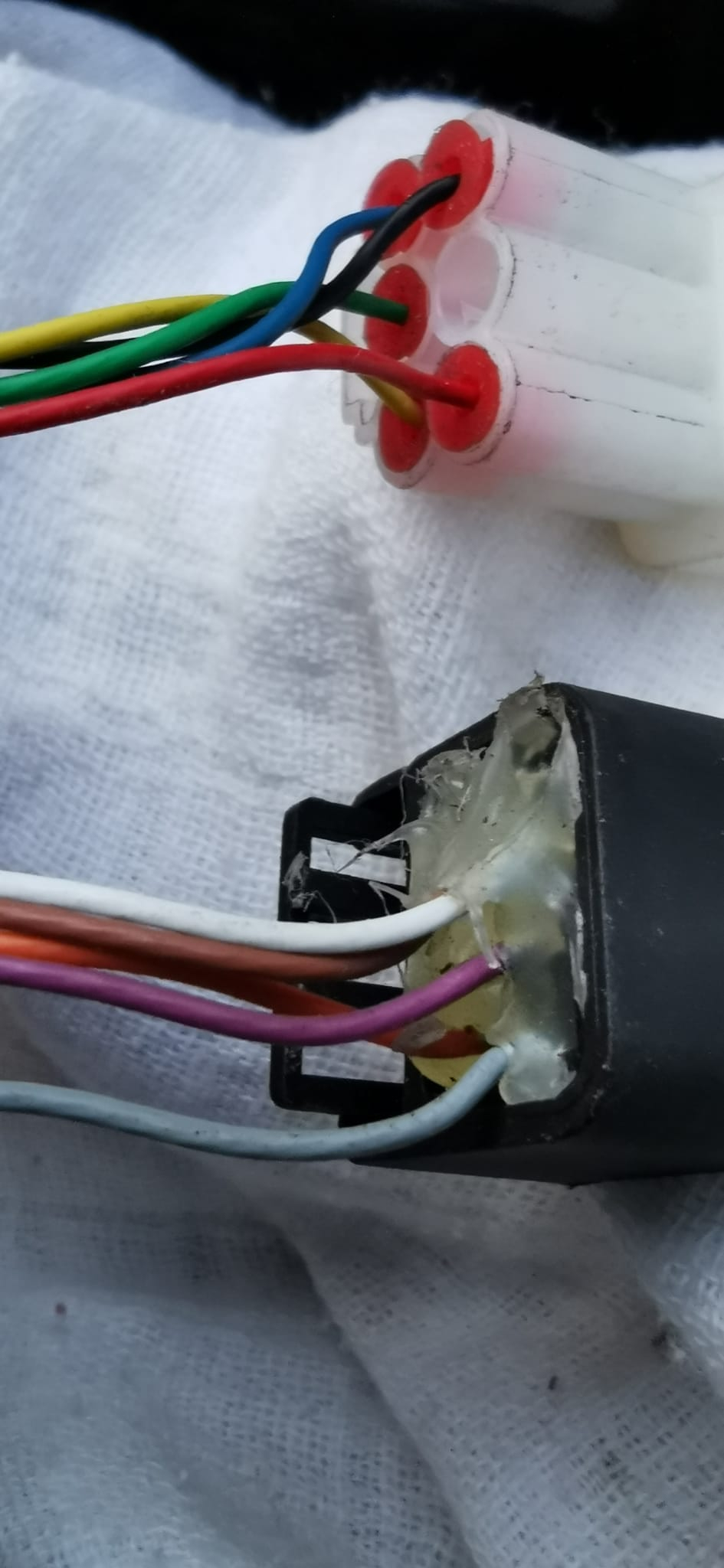

I'd like to ask;
  • I have a white (connected) and a black (not connected) plug coming out of the motor loom, obviously the white is the Hall sensors, what is the black one?

The Black one could be a second hall sensor set.

What are the cable colors going the white and black connector? Pictures are great thing for accompanying such a question ;)
If in both instances the colors are red, black, blue, green and yellow, then both connectors are for the hall switches in the motor, the black is maybe a second spare set of sensors.

MEroller hat geschrieben: Mi 22. Jan 2025, 21:38 What are the cable colors going the white and black connector? Pictures are great thing for accompanying such a question ;)
Yes, but dark yesterday! :D
Today ..
Beiträge: 20430
Re: Dismantling and repairing the motor :o
bob2.0 hat geschrieben: Do 23. Jan 2025, 18:31Today ..
So the white one is indeed the connector for Hall-Switch communication between the motor and the controller. The black one with white, brown, orange (?), violet, and grey cables, however, is of a different kind, and thus hardly is connected to a second set of hall switches in the motor. Sorry I have no clue about that one. Hopefully a Dayi Odin owner here can identify it?
