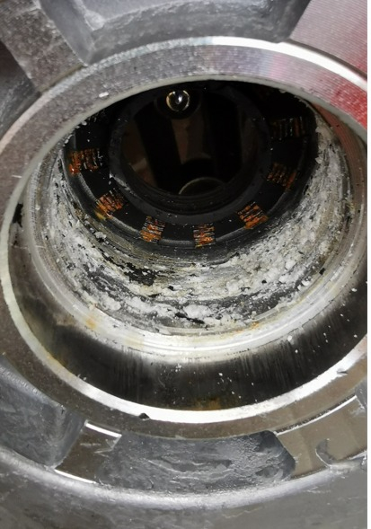

I had some success and some less success with it this morning. I cut the sealant easily with this method;-
WhatsApp Image 2025-01-25 at 13.44.47.jpeg (189.25 KiB) 3720 mal betrachtet
But after that success I made the error of continuing to hammer, thinking the sealant went deeper than that, but I must be up against an inner flange. A few razors shattered and flew off into the garage somewhere. I really do not like sharp things flying around a garage full of motorcycles! :shock: I could not find one piece, I hope it landed safely somewhere. The sealant only goes in <8mm from the edge.
The mistake I made was thinking I could lift the lid up and off the bearing, but it must be quite well pressed in, it is not going anywhere, so I strapped under the table, but there was too much give in my webbing and the table cracked at a weak point (not structural, just cosmetic, hence that is why it broke).
So, yes, thank you, the above will be my method. It just looks awkward to actually hold the wheel in a good way without it dropping on the other side, but I have those guide bolts.

I have used my bearing extractor and several encyclopedias to do this job with relative ease.
I was keen to take time to create a process that was readily reversible. I want to do this backwards to reinstall the stator safely and without bashing the bearing interface.
I think perhaps this motor has been open before, and that is why the bearing surface was the problem, it got bashed and not well sealed. This corrosion was why it was reluctant to move. Maybe this is useful information for people reinstalling their motors?
Once this was freed, removal of the stator using the guide bolts was very easy and not much force. I think they kept the stator very central and it did not scrape across the magnets.
Now it is out, I see several anomalies, the question is which, if any or all, are important ones?
