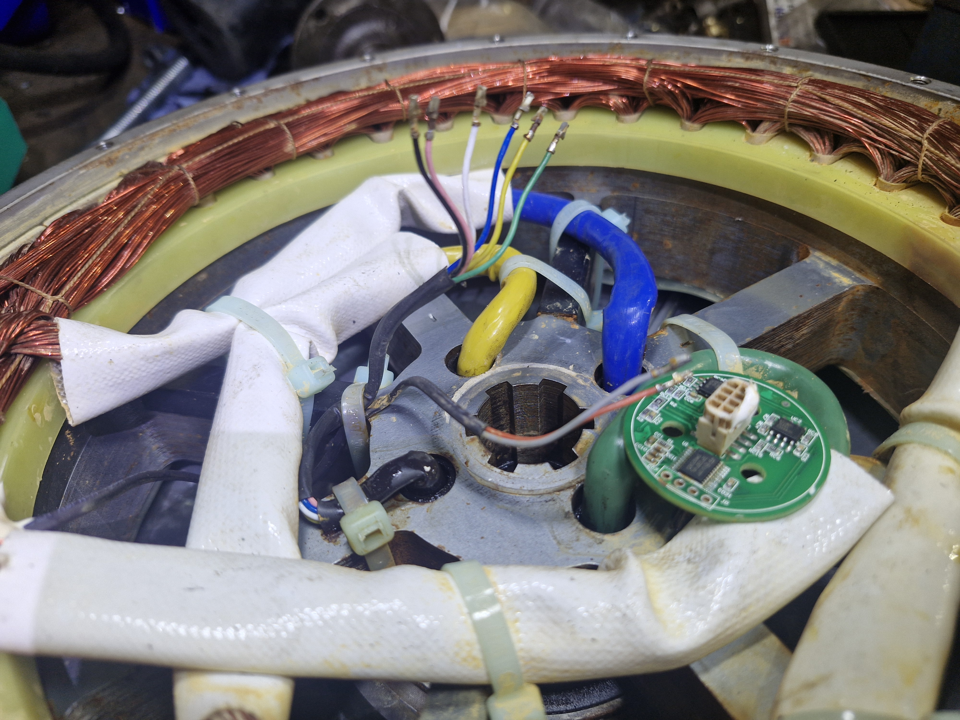

Leider spreche ich kein Deutsch, daher muss ich übersetzen. Ihr scheint aber mehr zu wissen als alle anderen, deshalb dachte ich, ich frage mal. Mein Nabenmotor ist mit Wasser in Berührung gekommen, und als ich ihn zur Reinigung auseinandergenommen habe, sind diese Kabel aus dem Stecker herausgefallen. Ich kann keinen Schaltplan finden, um sie wieder an die gleiche Stelle zu bringen. Hat jemand eine Pinbelegung oder einen Schaltplan, der mir beim Zusammenbau hilft? Silence S01 mit Votol 150-2 Controller. Vielen Dank, Ian.
Sorry I do not speak German so I am using translate but you guys seem to know more than anyone else so I though I would ask. My hub motor got water in it and when I was stripping it to clean it these wires came out of the plug and I cannot find a wiring diagram to put them back in the same place. Does anyone have a pin out or wiring diagram to help me get it back together? Silence S01 with Votol 150-2 controller. many thanks Ian

The round circuit board is obviously the sin/cos encoder, which is also installed in some S01s with Votol. I had already removed it in my S01 with Sevcon, but it is wired differently there, only 4 wires, directly soldered, according to my memory. Hopefully you can find someone with Votol who can have a look at it or has a picture.
I think here there are 6 wires coming from the controller, and 2 of them are just passed through on the board, to the 2 separate ones, putatively belonging to the temp sensor.
I hope you have documented the mounting orientation of the board and the according lid with the magnet. Otherwise you will need to recalibrate it, for what you might not have the software.

thank you for your reply, yes it is Votol and different to the Sevcon setup which has less wires. I cannot understand why the manufacturer would not publish the schematic. I can tell which way it came out, there are marks however if I am wrong there are only 3 possible positions to try?

I would send the Foto to QS- Motor. I think the Motor is from them. I have a question too: The Motor ist open. How long are the Magnetics? 45mm?

I have found this scheme. Perhaps it will help with orientation.
Unfortunately, Silence does not provide any instructions for installing the motor or the battery. That's why these parts always have to be sent in.

Unfortunately this is the SEVCON version?Schnabelwesen hat geschrieben: Mo 21. Apr 2025, 14:54 Hallo Ian,

Ein Schaltplan für den Votol Controller befindet sich in diesem Servicemanual: viewtopic.php?p=354150#p354150

Leider aber nur für die Variante mit Hallsensoren.Gerold hat geschrieben: Mo 21. Apr 2025, 18:03 Ein Schaltplan für den Votol Controller befindet sich in diesem Servicemanual: viewtopic.php?p=354150#p354150

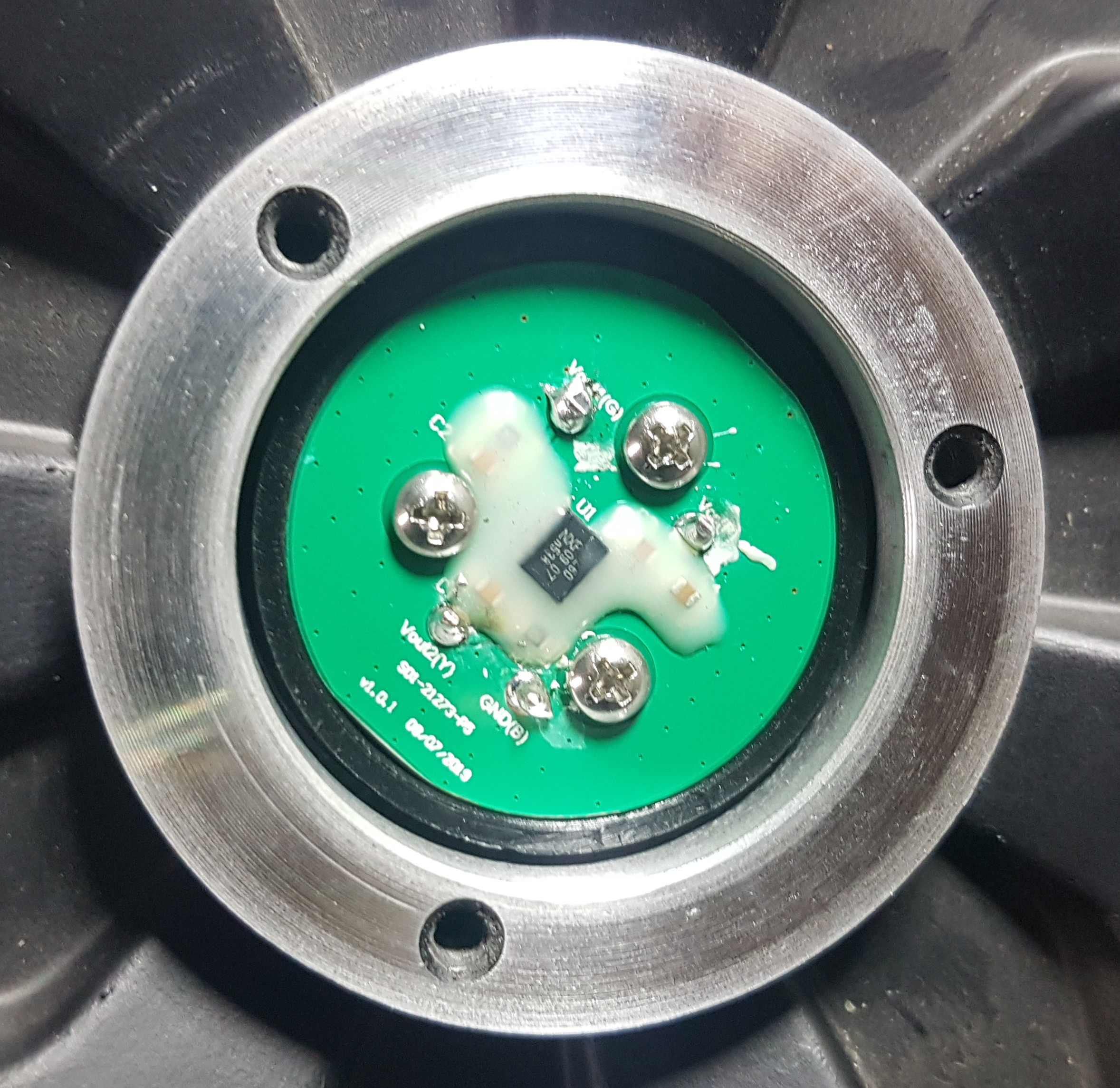

Evtl. sind auf der Platine (Rückseite?) die Anschlüsse beschriftet? Beim Sevcon-Encoder ist das der Fall, siehe Bild. Dann ließen sich die Adern evtl. mit Hilfe der Anschlussbelegung am Votol die Adern zuordnen.
Einfacher wäre es aber, jemand mit Votol und Encoder würde schnell den Deckel aufschrauben...
