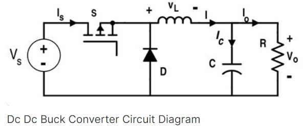

Imagine there is huge 1000A 72V source sitting on the output, Vo.
Imagine it is 'OFF', that is, S is not running. It's powered down but plugged in.
Imagine diode, D, with Vo across it, failing closed. Or capacitor C failing, which is the other common failure.
What happens next?
THAT is why I have installed a fuse in the charging leads on the bike.

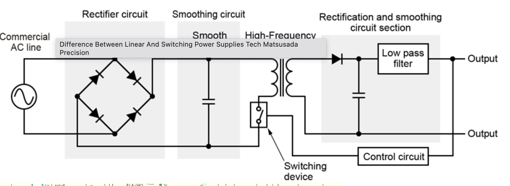

Let`s stop it. Simplified this is how the DC part on the primary side is working. But the battery is connected to the secondary side.
You are currently surrounded by millions of fine working SMPS (switched-mode power supplies). Please don`t make things up.
Very simplyfied schematics:
picture is stolen from:
https://www.circuitdiagram.co/switching ... planation/

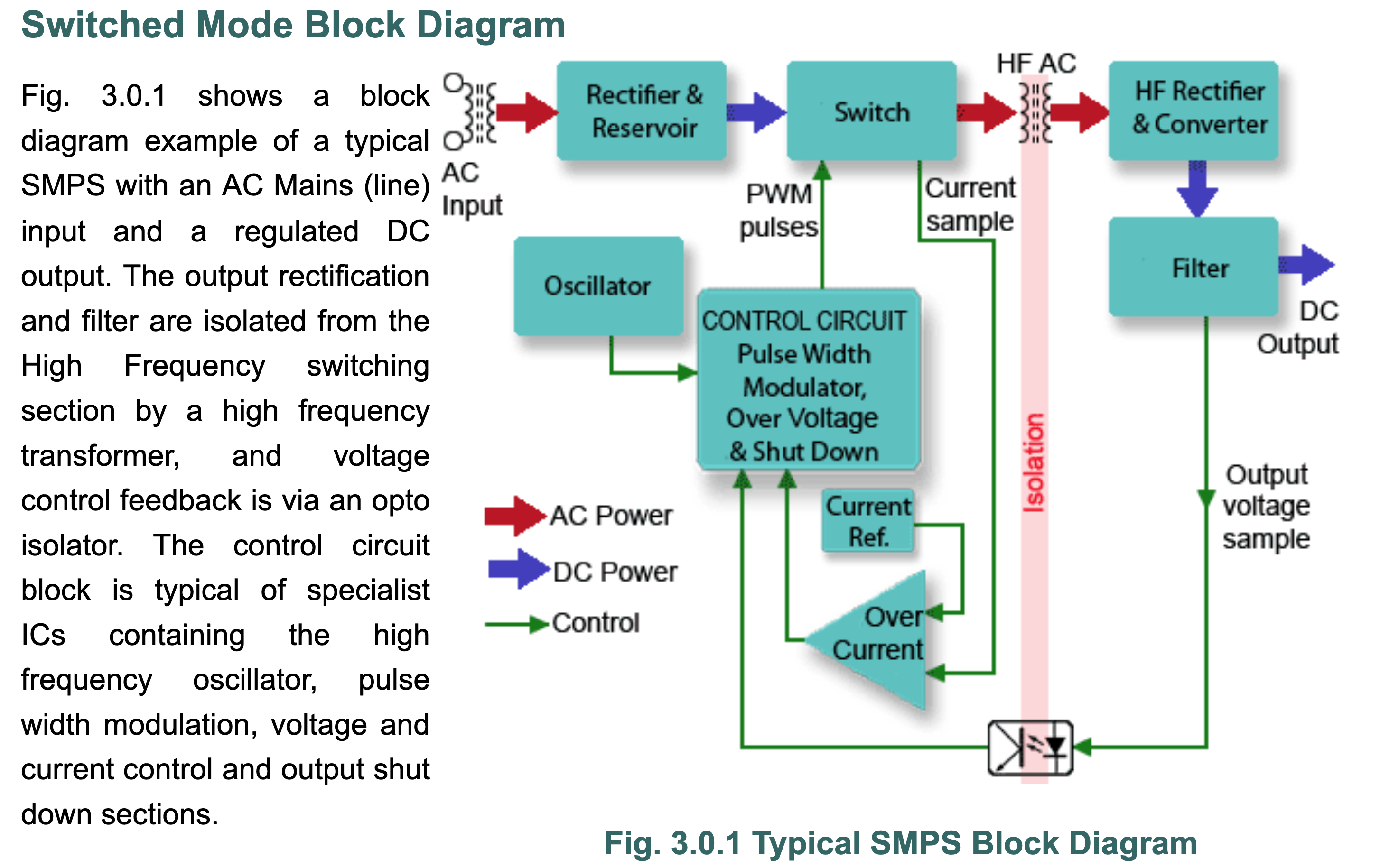

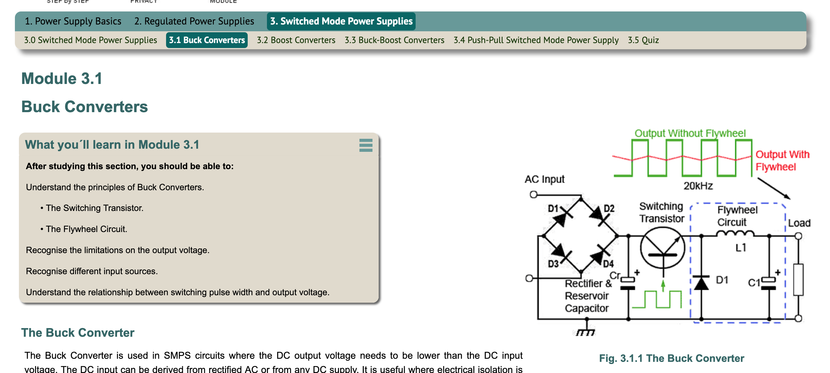

Reverse picture search took me to the source: https://www.learnabout-electronics.org/PSU/psu31.php
This is the beginning, the missing part, the whole story: https://www.learnabout-electronics.org/PSU/psu30.php
The important difference is the isolation from mains! There is a Control Circuit for trouble-free and safe operation.
So please kids, don`t try this at home!
