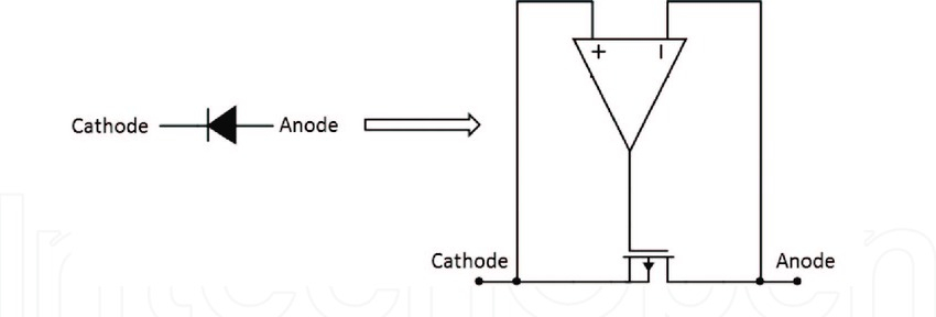

I'd not go so far as to offer specific advice to try a thing out, because things can go 'bang' in an instant with a big battery very willing to dump 100s of amps across any mistake you make.
I was just putting forward the thoughts I had to set something up. If my thoughts what I might do helps you decide if there is something you want to try, then I wish you good luck.
I worry about the consequences of getting it wrong. I'd be inclined to install a diode to an external pack, so the power can only go one way. But diodes are lossy and that was my thinking behind using the DC-DC converter. It would substitute for a diode and only allow flow in one way.
There are also mosfet-based active diodes with nominally zero voltage drop. But these need to be connected across the full voltage, and the ones you can get ready made tend to only go up to 60V or so.
You'd have to make your own circuit for higher voltages/currents.
I think that is not too dumb, and I'd construct it in a 'safe' way with a high resistor bleeding volts into a bootstrap circuit, so that there is no direct path for the battery through any singular components of the active diode.
thanks for the "rough draft" ill keep that in mind
