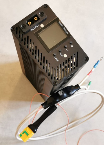

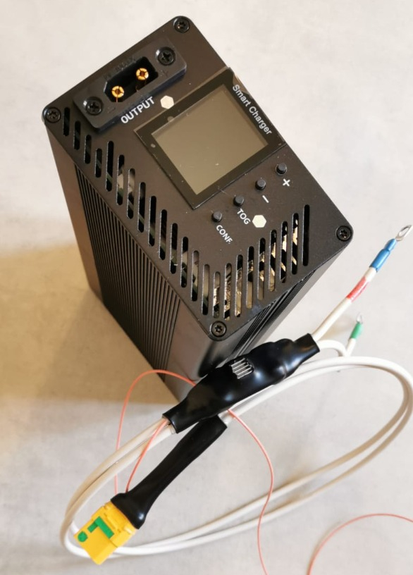

I've now made up a lead with an 'ideal diode' and run it up to 20A. The charger starts getting warm, even the (substantial) mains power lead.
But the lead I made up seems fine. The ideal diode has a little heat sink. I put heat shrink over it, and then cut out a little window for the heat sink to vent. It was barely detectably warm at 15A, but it was warm (not hot) at 20A.
The whole of the ideal diode board warms up at 20A (I guess did not help wrapping in heat shrink) but just 30~40C. There does not seem to be any hotspots at where I soldered the 4mm^2 cable to it, I think it is the board itself, and the cables draw heat out of it.
I tested the lead on a lead acid battery (as the voltage can be set down to 10V) and tried short circuiting it (on the far side of the diode). It's fine. It seems 'safe' as a way to stop battery voltage getting out but letting voltage in.
Part of my plan is also to use this lead to set up a couple of 36V lithium packs I have, in series. These should add 15Ah or so of extra capacity for an additional ~6kg in my top box.
I'll run longer tests at 15A and 20A later, but it doesn't need charging atm. It seems OK.
