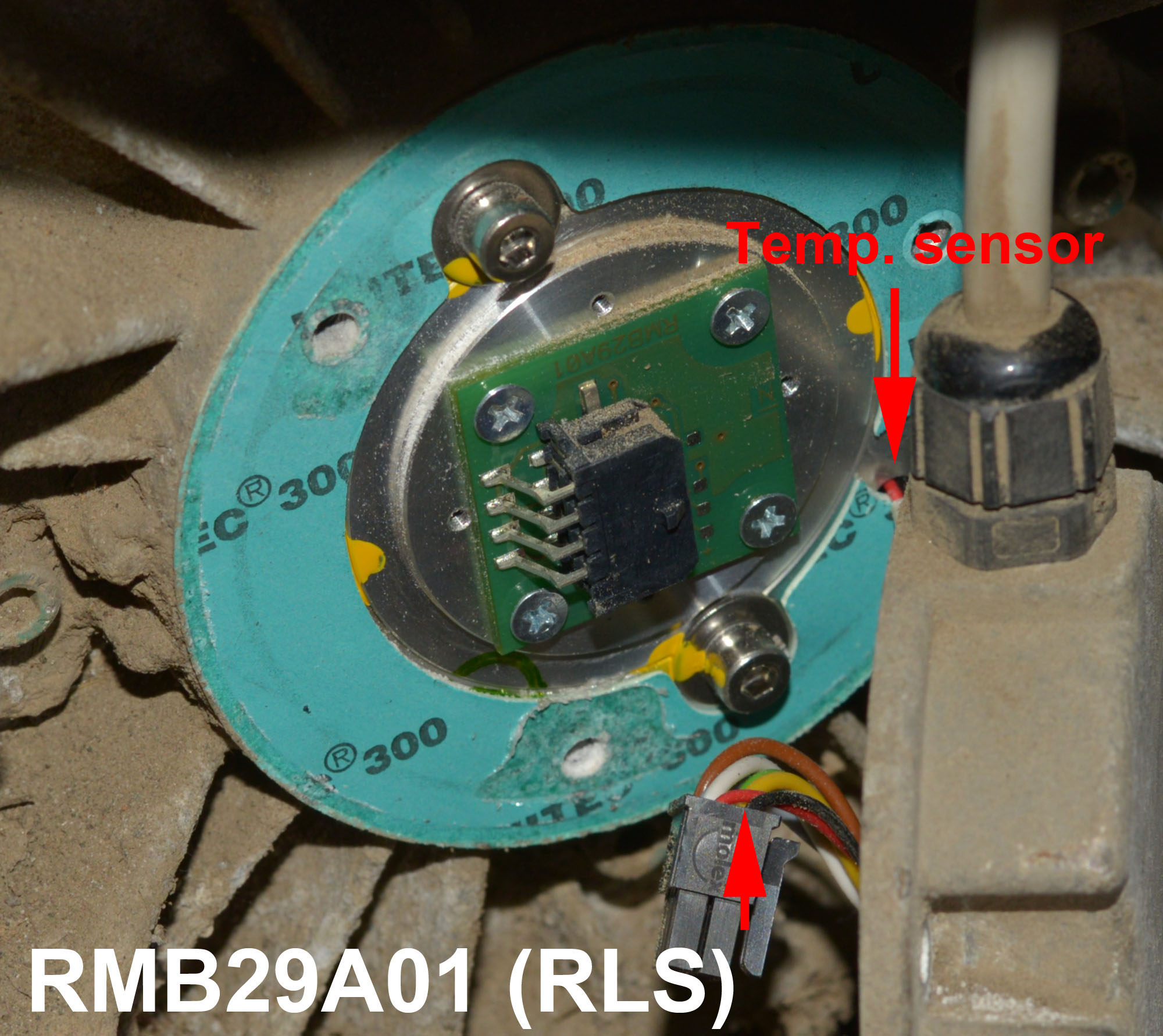

I have my e-Vivacity for 2 year + some days, means out of warrantie! I has about 5000km and it all went well until last weekend, after a full night charge:
When I try to turn on the scooter it shows the engine temperature at maximum and it shows a blinking engine in the screen... :?
Can anyone help me ? I assume that is the temperature sensor from the Engine, how can I repair it ?
Thanks in advance

For a test, simply connect a 560Ω resistor between NTC connector of the SEVCON plug and GND. (which is scooters metall chassis). http://fs5.directupload.net/images/160518/him63ayo.jpg
The KTY130-84 sensor (cheap) is the red/black wire coming out of the motor underneath the encoder case , as to be seen @ the thread linked by Dirk above. App. 500Ω @ 15°C. Unfortunately you probably can´t replace it w/o disassembling the motor.
PS: Maybe its just a conn. prob., just check the wiring all the way up to the SEVCON plug .
