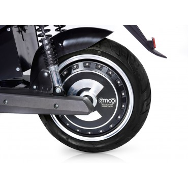

There are a lot of bolts visible on the motor. It appears that the outer layer is a separate part. Does anyone know if it is possible / safe to unscrew the outer layer of the rim so that it can be repaired by a rim repair company?
(the picture is from the S3000 Novum, the S4000 Novax looks similar)
Thank you for the insights! The Emco Novax however has a rear-wheel motor.

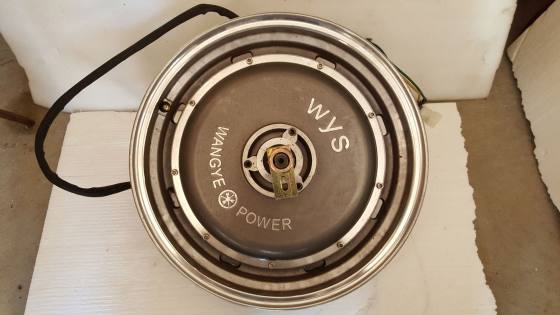

Maybe this can help you:
Zum Verkauf steht ein neuer 14" Radnabenmotor mit 48V/4000 Watt. Der Motor ist noch nicht verbaut gewesen.
Für private Projekte ideal geeignet!
Neupreis 900€
Verkauf als defekt, ohne Garantie, ohne Rücknahme und ohne Gewährleistung!
Finanzielles:
Preis: Festpreis 200.00 €
Kontakt:
Name: Krain Elektrofahrzeuge
Straße: Spinnerweg 61a
Stadt: D-53783 Eitorf
Tel: 02243-9161760
Mehr Infos: Webseite
Anfrage senden: Kontakt
Bilder:
[4000 Watt Motor für Elektroroller NOVAX von Emco (neu) Bild Nr.1]

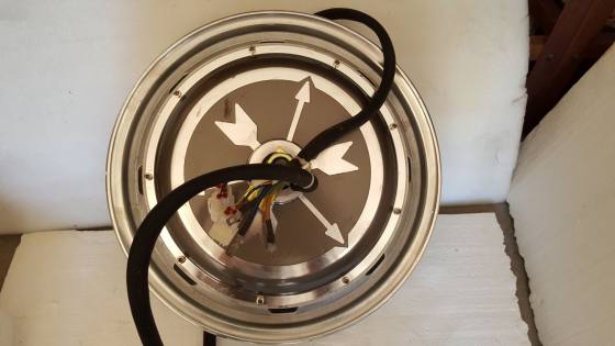

Re: Felgenschaden erfordert komplettes neues Rad + Motor?
I am not sure why the rim repair shop thinks they cannot repair the rear rim with the motor inside. Ist is still quite a standard alumiminium rim, after all...
You would however need to detach the Motor/Wheel from the rear fork and also detach the cables from the controller (three phases and a 5-Pin connector for the Hall-switches). Only then can the tire be taken off and the rim worked on.
Ensure you document all the cable colours BEFORE you disassemble so you can propperly reconnect them to the controller.
The tire place just needs slightly higher clamping jaws, and the wheel should be placed on the turntable with the shaft at the top where the cables come out. One person must hold that shaft still (with a vice grip or wrench) while the machine takes the tire off, else the cables will suffer damage.
Only if you want / need to disassemble the motor you will have open all those screws, get that lid off while carefully threading the cable through the lid's bearing, and maybe need to disassemble the 5 pin connector as it will most probably not fit through the bearing.
Once you are that far set the other end of the motor shaft on the floor, maybe on a piece of wooden board to ensure no damage to the thread, and then apply your whole weight to the rim / tire to free it from the stator and the monstrous magnets in the rim. Continue to firmly hold down the rim while someone else lifts the stator completely out of the rotor/rim.
BEWARE: only do this if you REALLY know what you are doing, the magnets are immensly powerful can easily cause the worst crushing injuries to fingers and the like, or even cut one off!!!
It might be a good idea to cover the magnets inside the rim with some packaging tape in order to keep them clean from any iron or steel chips that might come close. You will never be able completely clean off any iron powder that the magnets attract!
Now you have a rim like the rim shop knows and they can work on it without worries.
Re-assembly goes the other way round: firmly place and press the rim to the ground while another person sets the cable-less axle with stator through the rotor's bearing and seal, and then as slowly and controllably as possible gently reduce the downforce until the magnets pull in the stator with might.
When you retighten the lid on the other side be prepared for multiple magnetic jerks with every bolt you screw down. Once they are fully tightend the rotor should once again cog freely around the axles without any magnets rubbing on the stator.
Or contact Krain like Peter suggested

Wenn ich es richtig sehe, sind nur die Lagerdeckel beim 14" 4kW Novax Motor abschraubbar. Auf der Innenseite der Felge sind die Magnete. Die Felge ist quasi der Motor. Das Krain Angebot ist mit Euro 200,- für einen neuen, ungetesteten Motor günstig. Ein Foto vom beschädigten Felgenhorn hat der niederländische Kollege ja nicht eingestellt.
