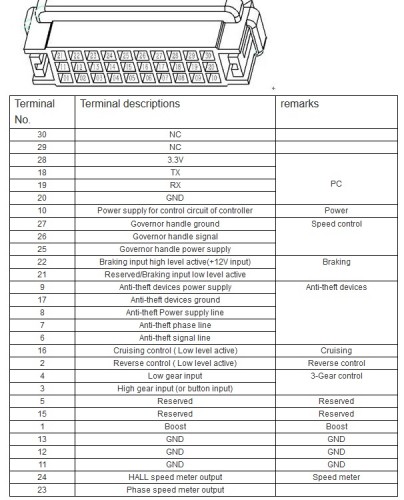

I have a problem with programming this driver - HK2X or lingbo
do you know which pins are suitable for connection? in one of the instructions I get out of 13 and 23 from my factory plug which is connected and used for programming that 18tx and 19rx pin and 28 3.3V and 20 ground. lingbo software in each version gives "timeout". I have such a converter: https://botland.com.pl/pl/konwertery-us ... k-usb.html

Hello sperzu,
I tried 2 USB/TTL adapters. Only the one with the chip set CH340g worked (see ebay-link) It costs only 3 €. It ist importent that the adapter use 3,3 V and not 5V.
This ist the connection plug arrangement from the Controller. I think you have to invert Rx an Tx. (18=Rx, 19=Tx) This is wrong in this template.
Michael

Yes, I just bought it today and it worked TX and RX are the other way around. It works. Now the question I always wanted to ask :) How to speed it up;) the speed limiter is turned off. can any of the parameters still change?
