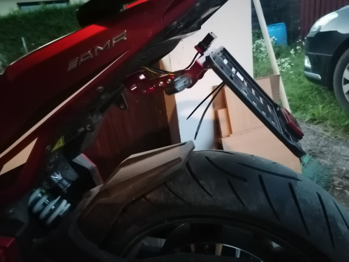

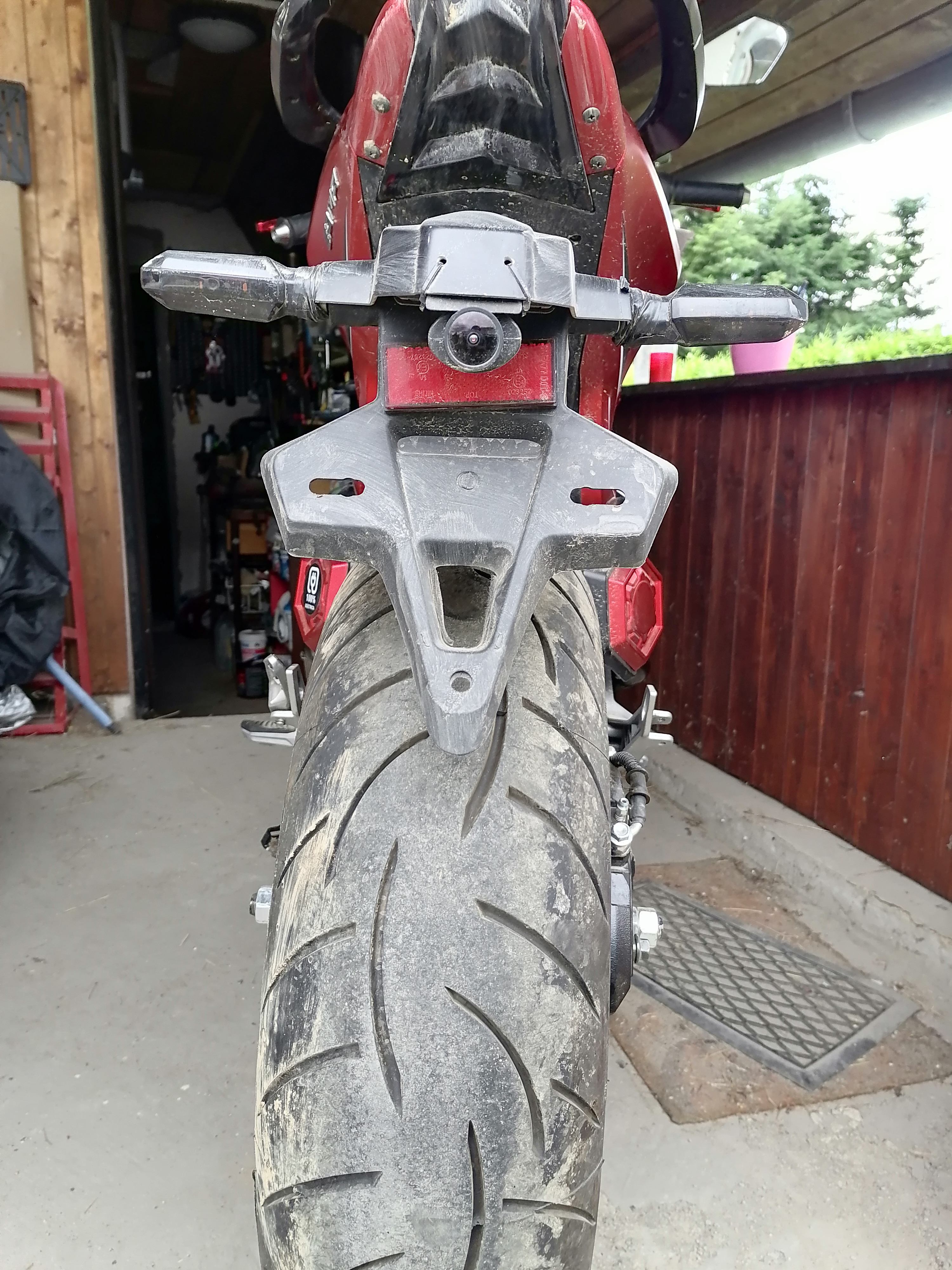

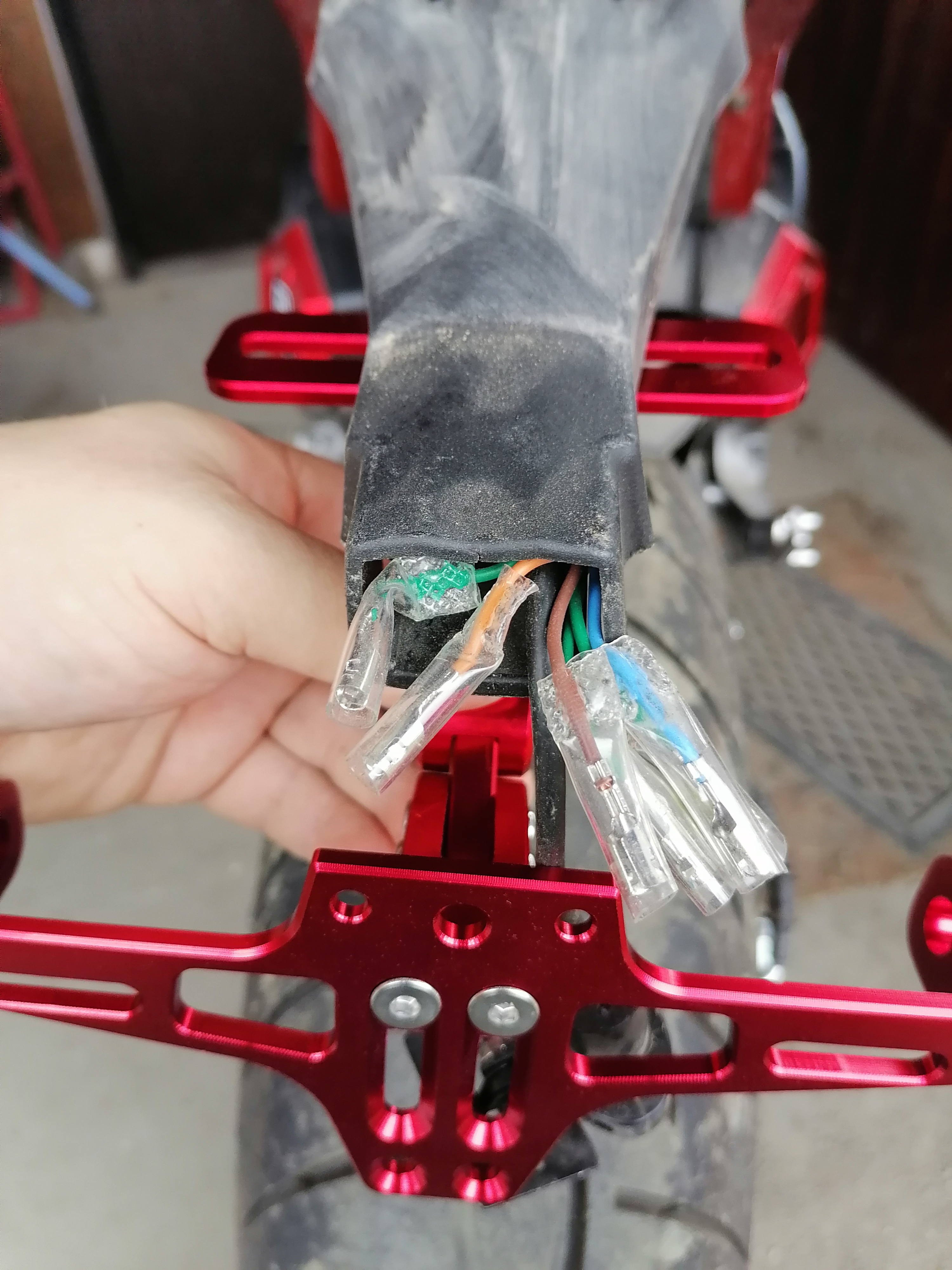

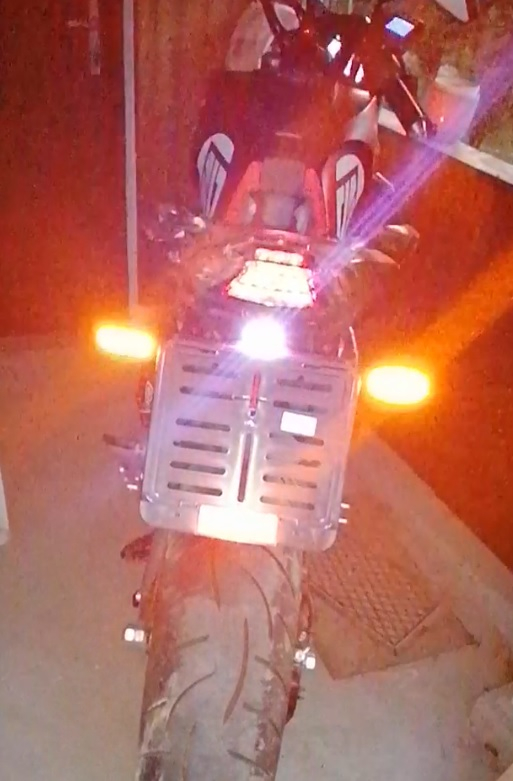

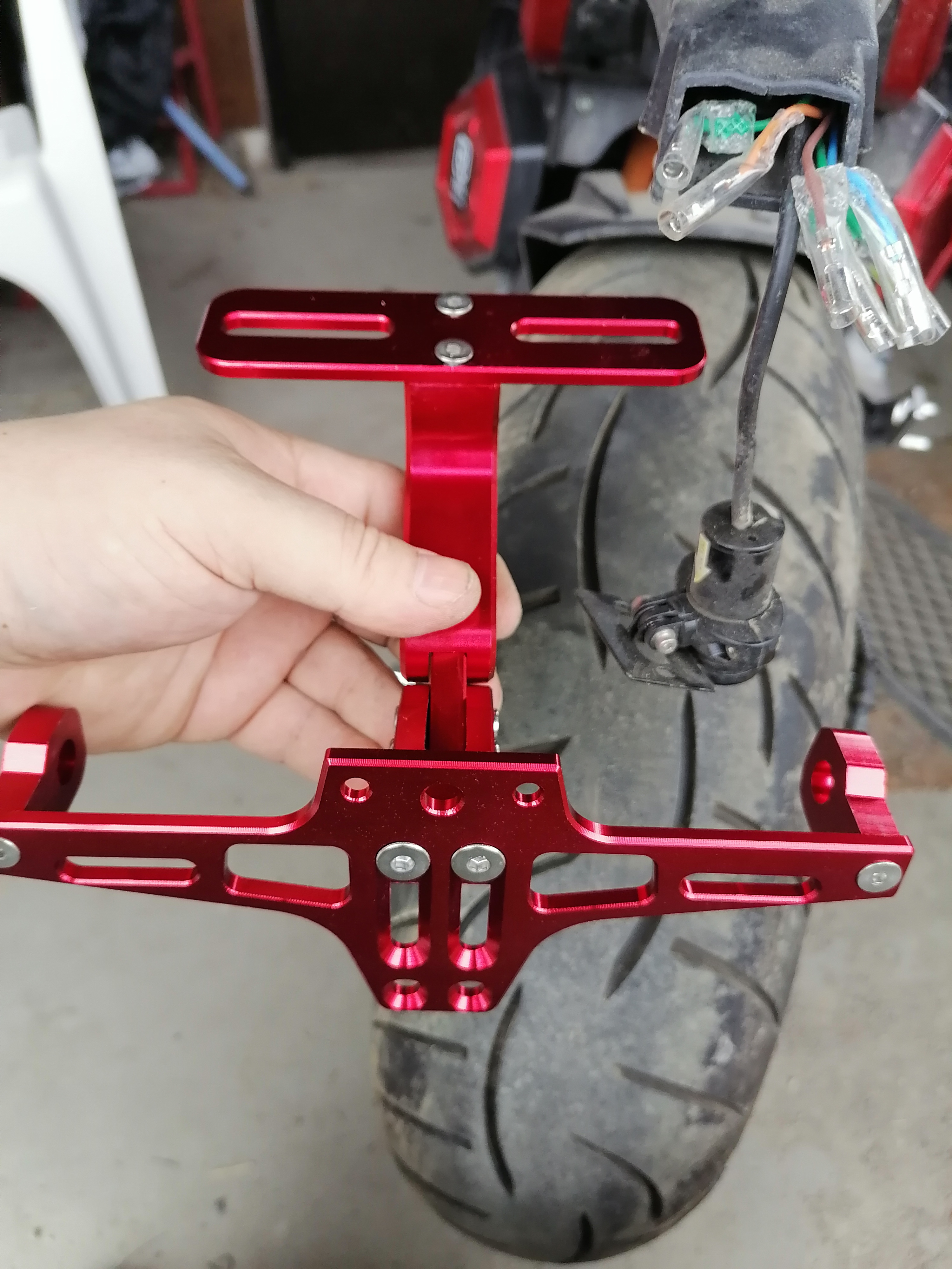

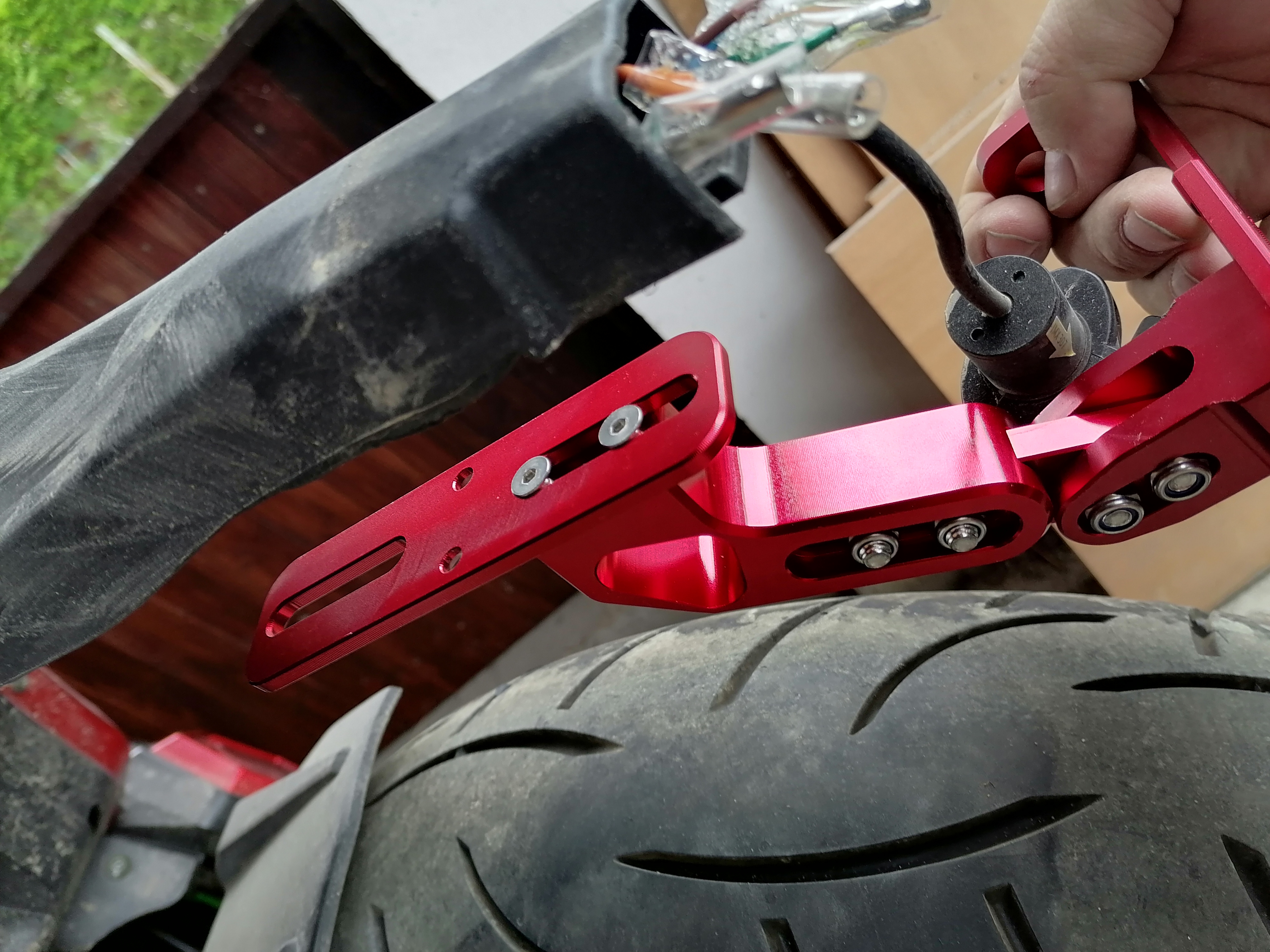

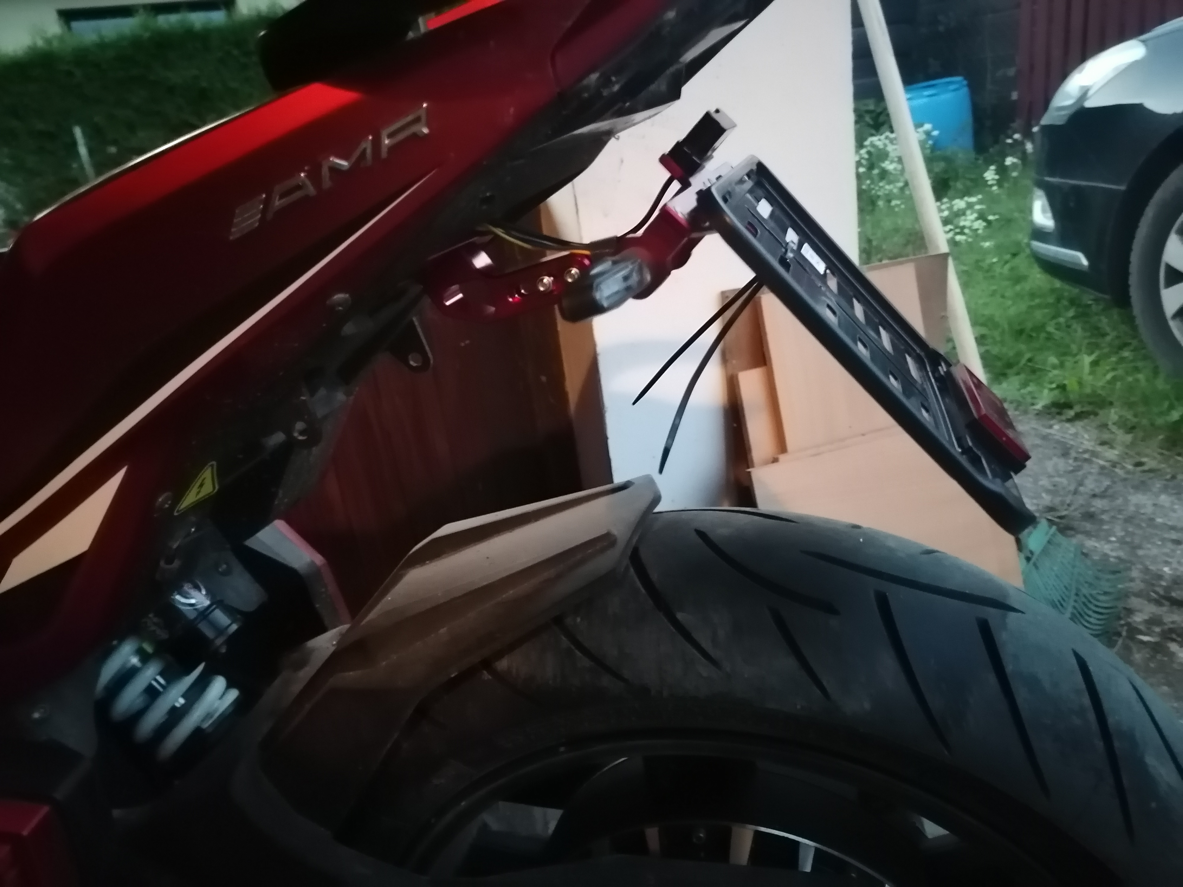

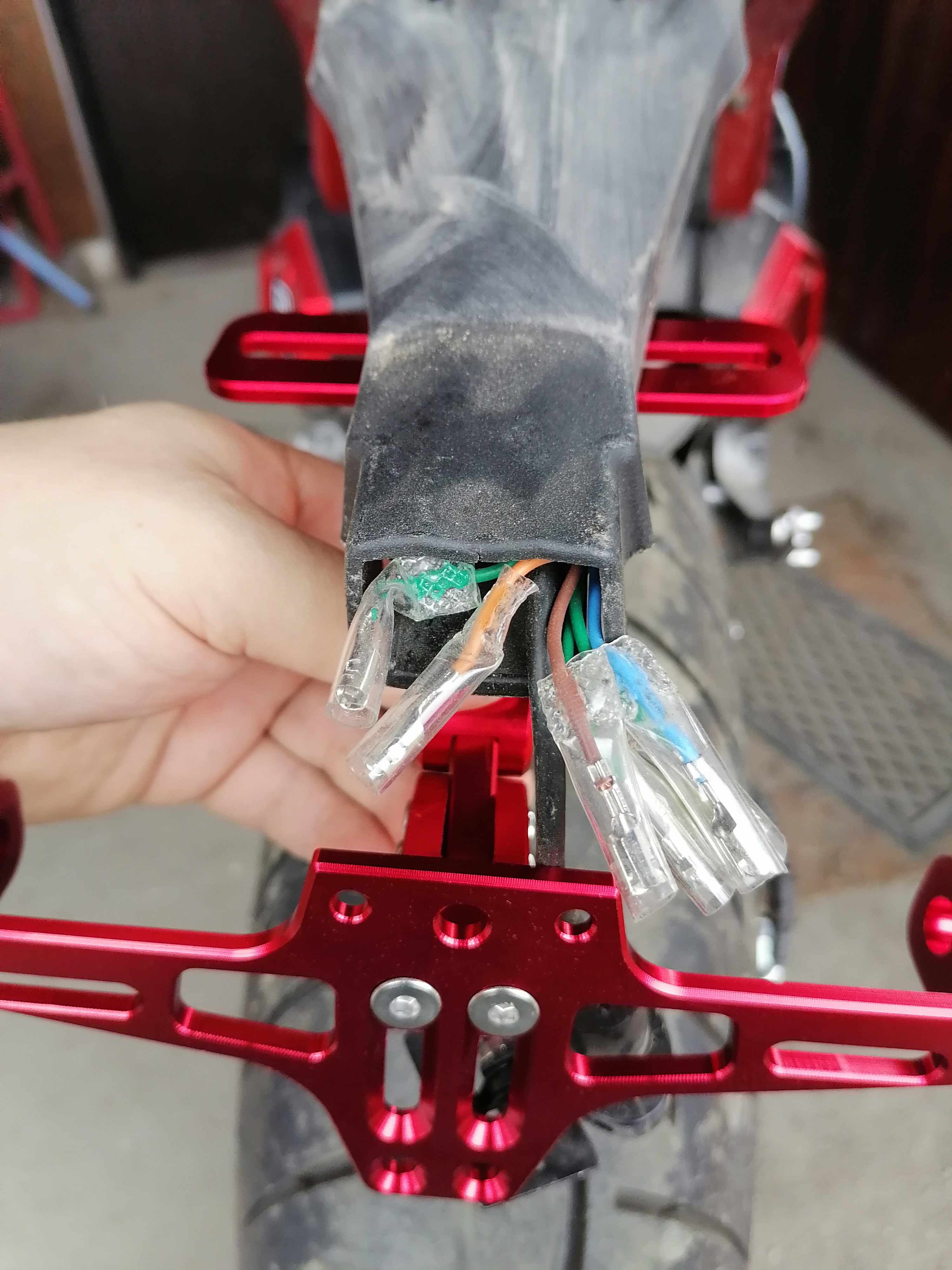

Hi guys, another inspiration - new plate holder with (flexible) turn lights.
At first I planed to mount it under that factory "tail" and remove only factory plate holder with broken turn lights but finaly I removed it completly and mounted it with two bolts and nuts to (factory) metal plate under the seat.
My rear shock absorber is 265 mm. New plate holder does not colide with rear tire, not even on big bumps. In case of need it can be moved more to the rear so it can be even further from rear tire.
Homologation ? I do not care. It is functional and I like it, that is important for me
I would put here video with flashing turn lights + plate light on but it is not possible so soon on my Youtube channel.
More important is to finalize settings of new controller (72680), great torque up to 70-80 km/h but then very slow up to 95 km/h, so it needs better field weakening setup + fully charged battery
Factory plate holder: New one:

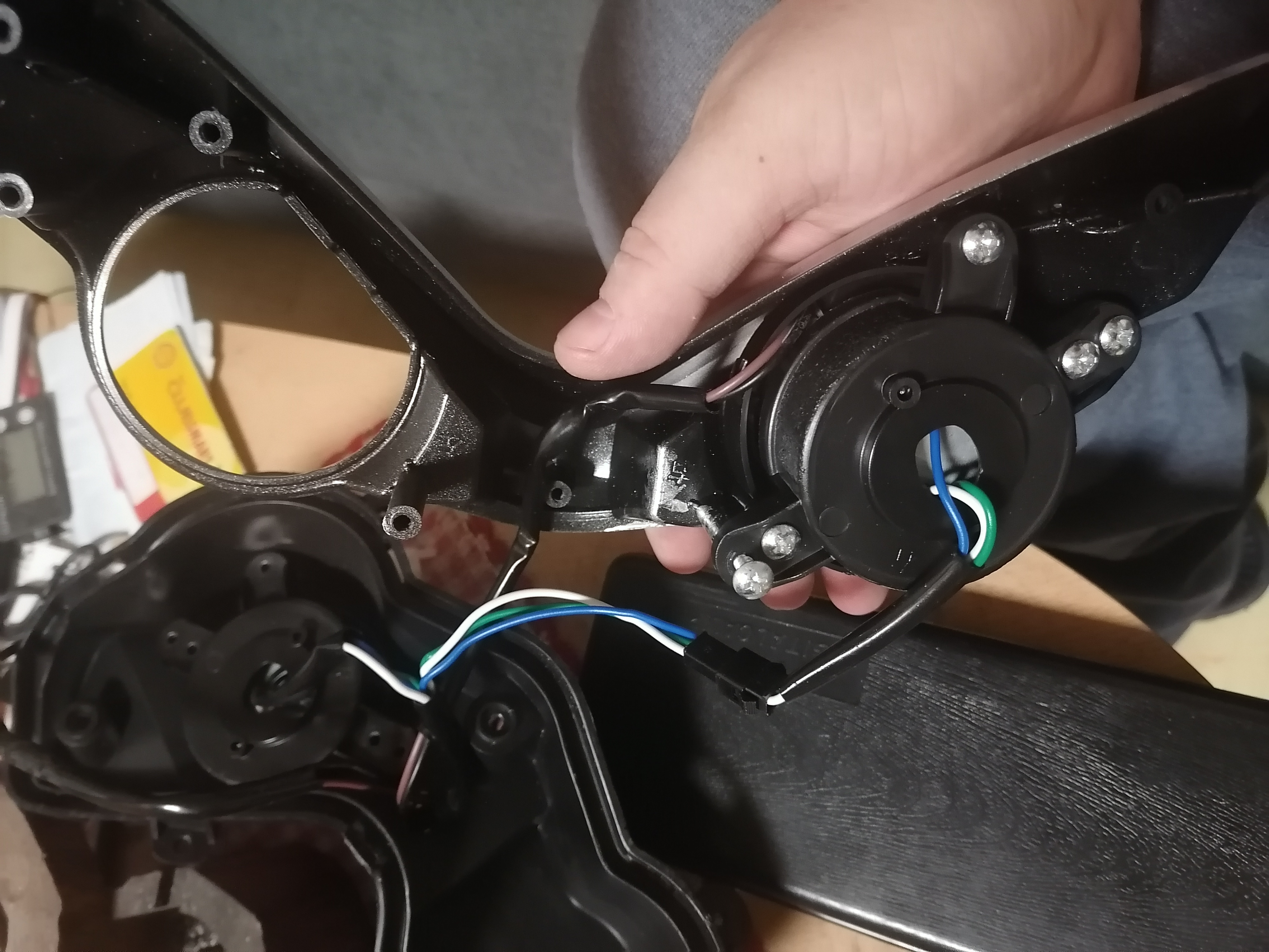

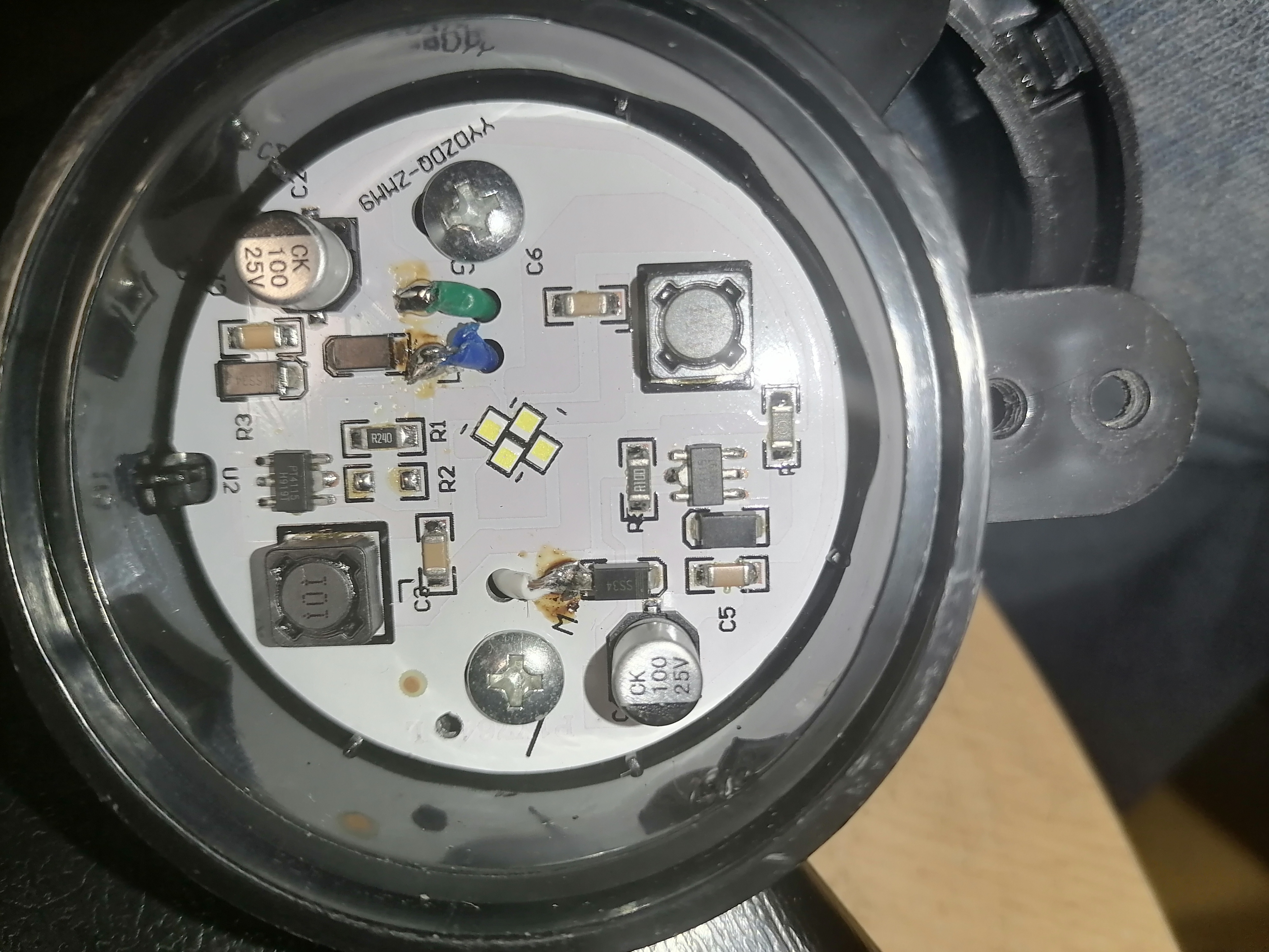

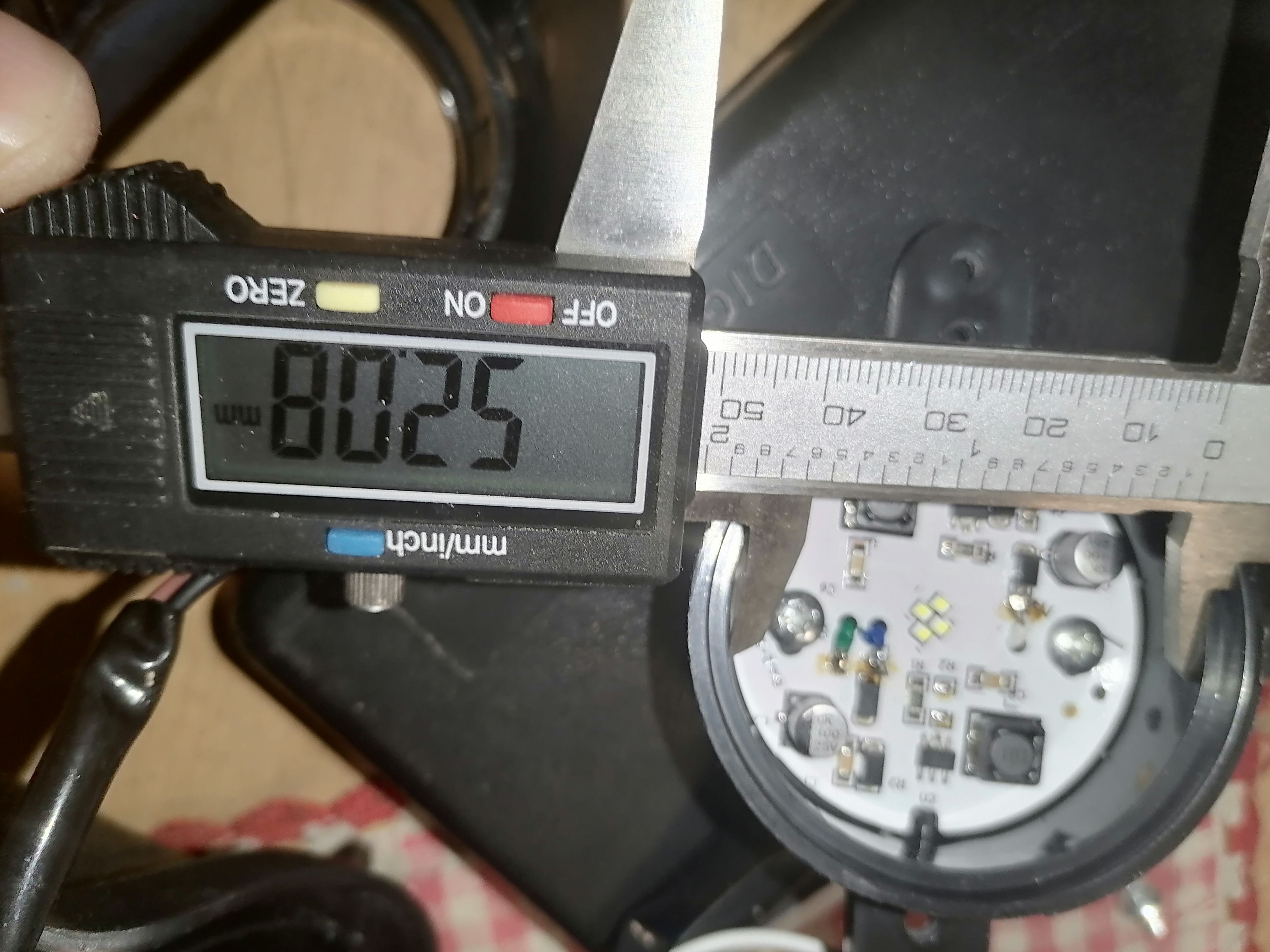

Headlights. Has anyone upgraded it yet ?
I did some photos, it may help somebody.
Sorry for quality, I was in a hurry.

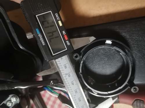

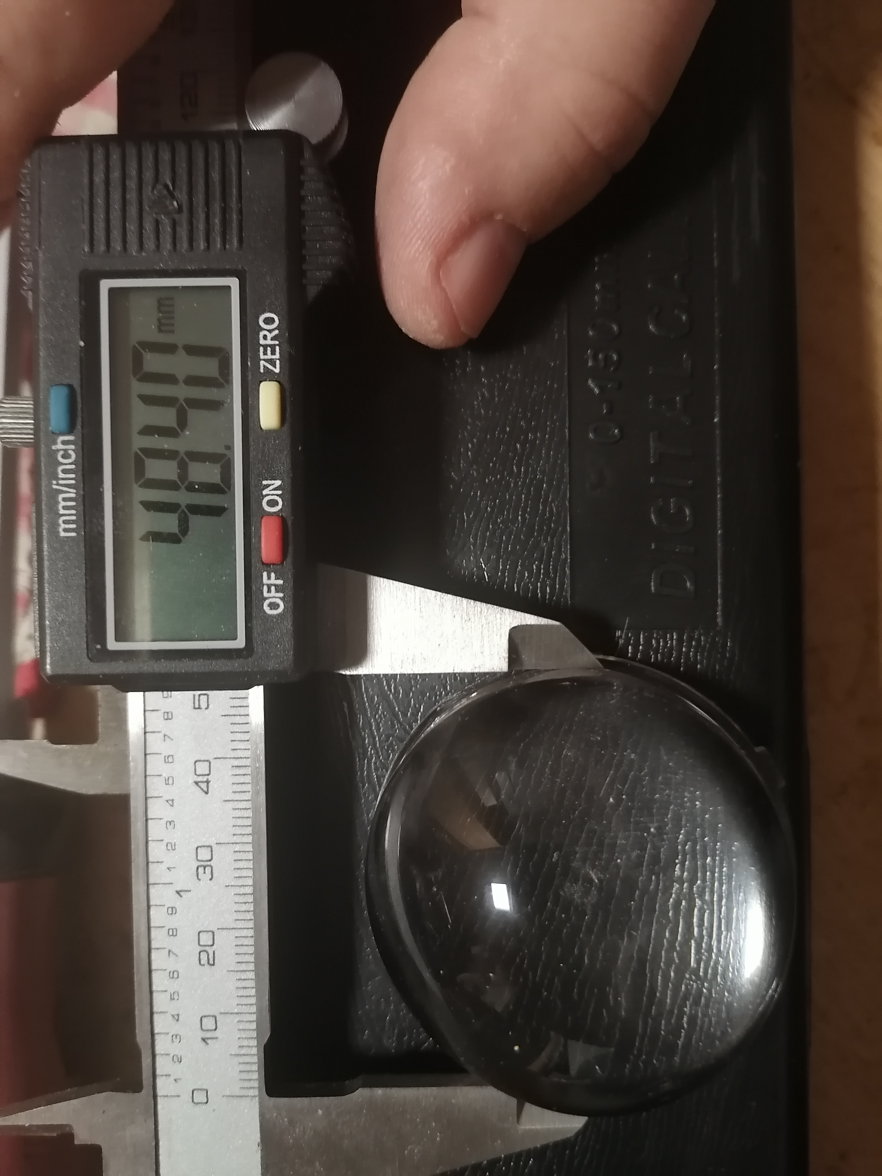

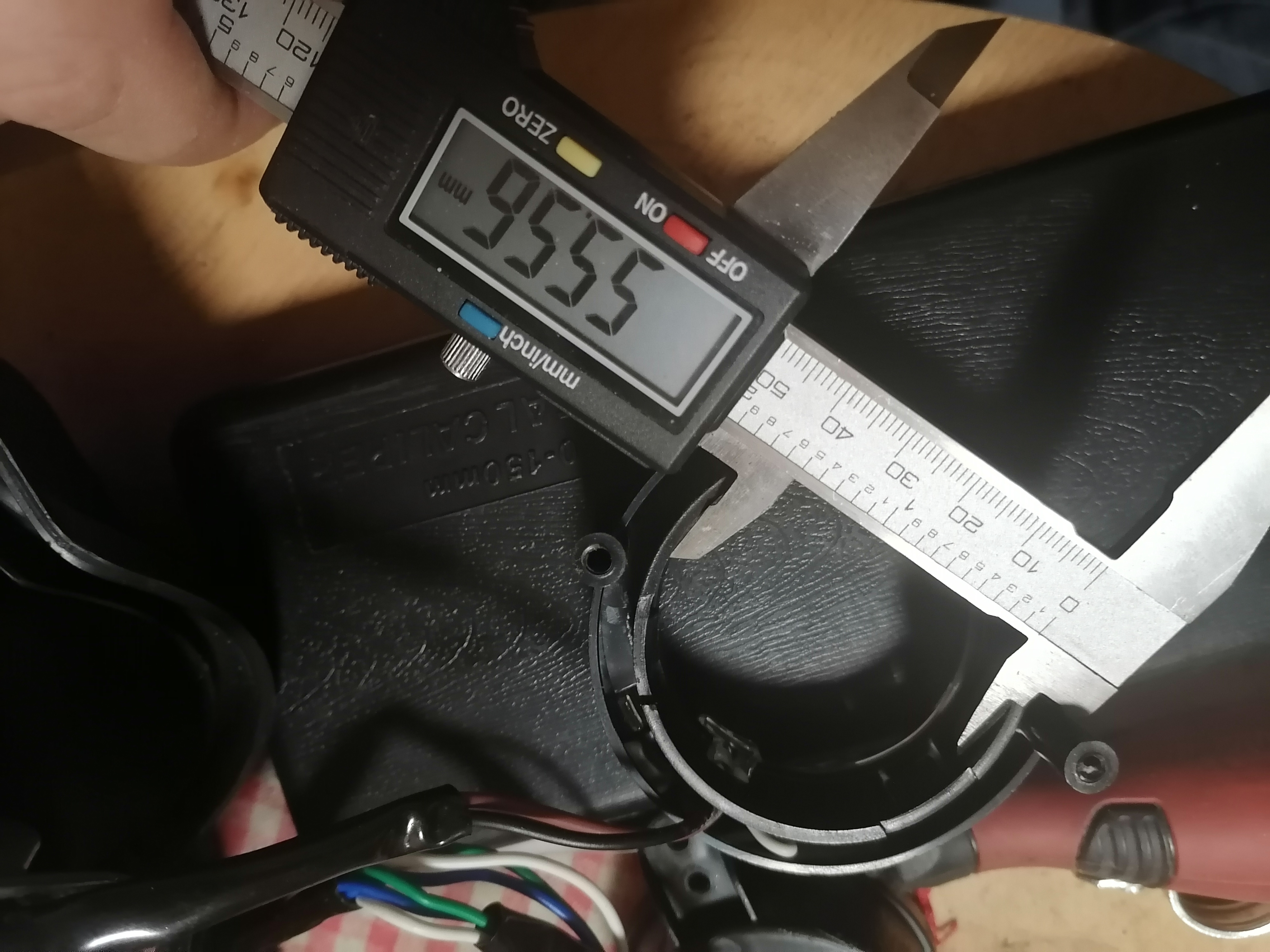

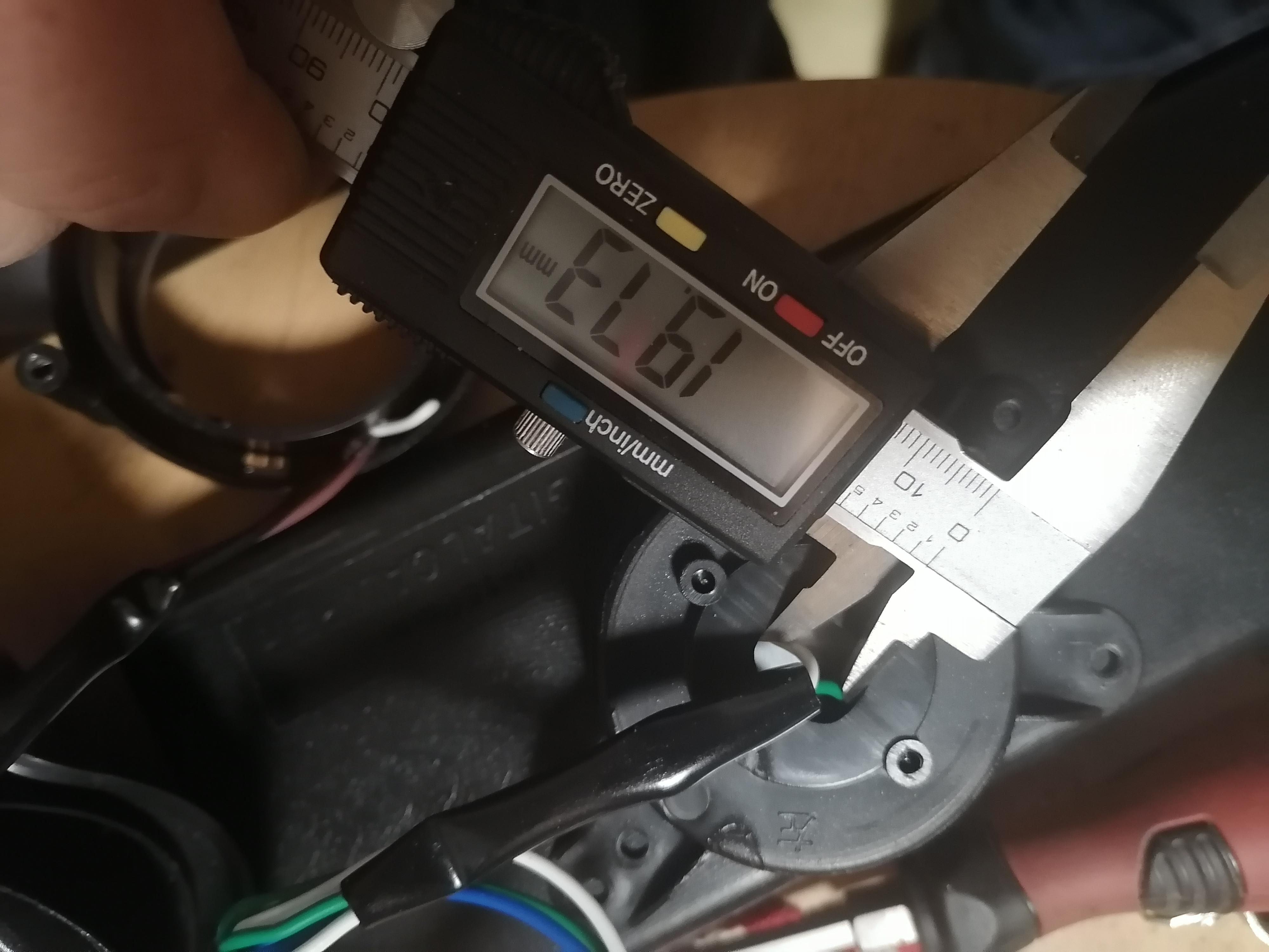

Bulb is pretty small and also there is not much space behind it (about 70 mm) and smallest 2,5" bi-led projector are about 135 mm so it depend how much space is behind back plastic cover where are all wires. It could be a not so easy job to fit bi-led projector in so I rather measure twice before I spend lot of money.
I have found some LED boards but nothing specificaly for motorcycle/car high beam/low beam headlight but that factory lights works as "L1 and L2 connected to switch wires" (+ angel eyes) so I will look for anything with similar PCB.

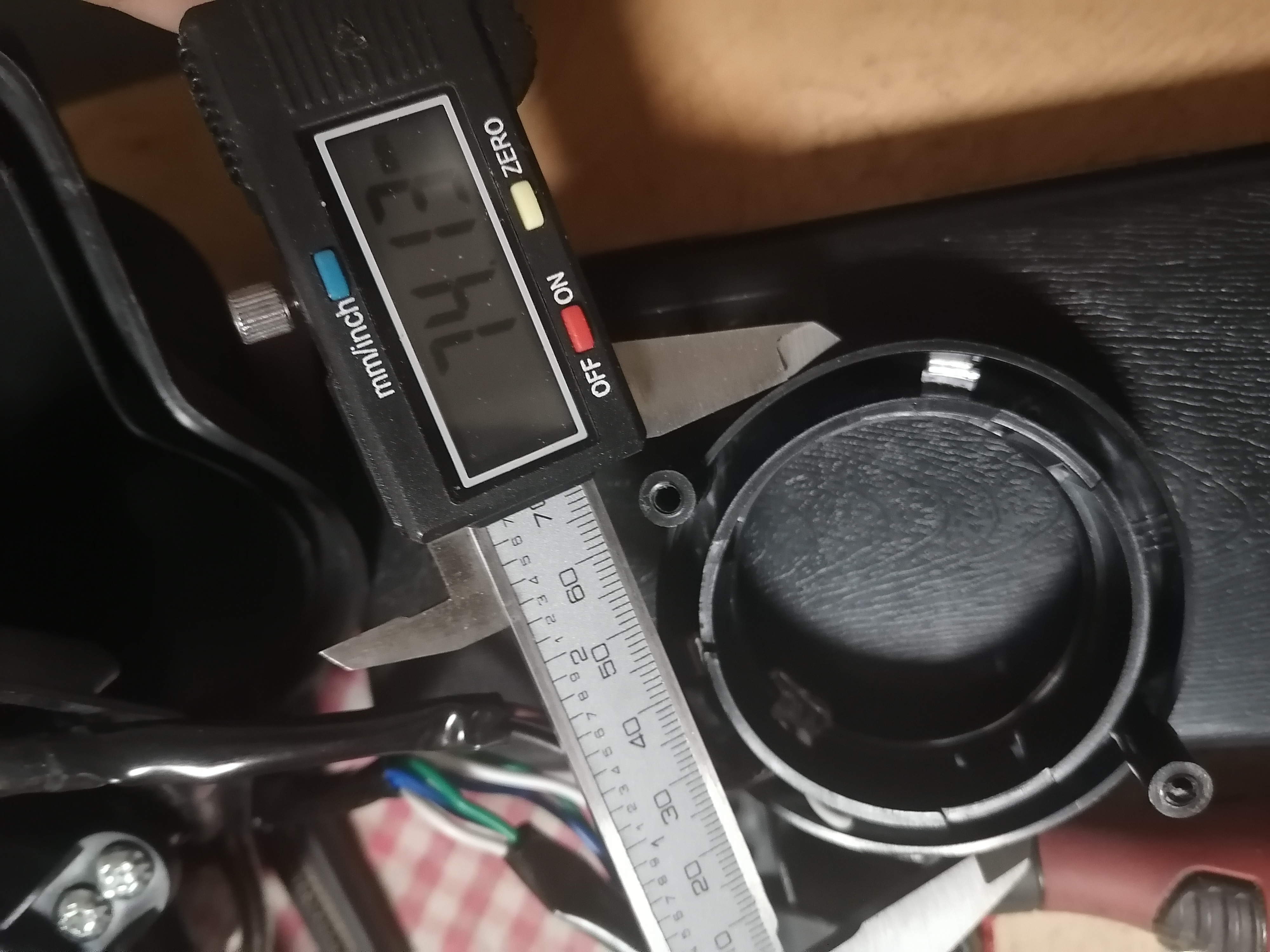

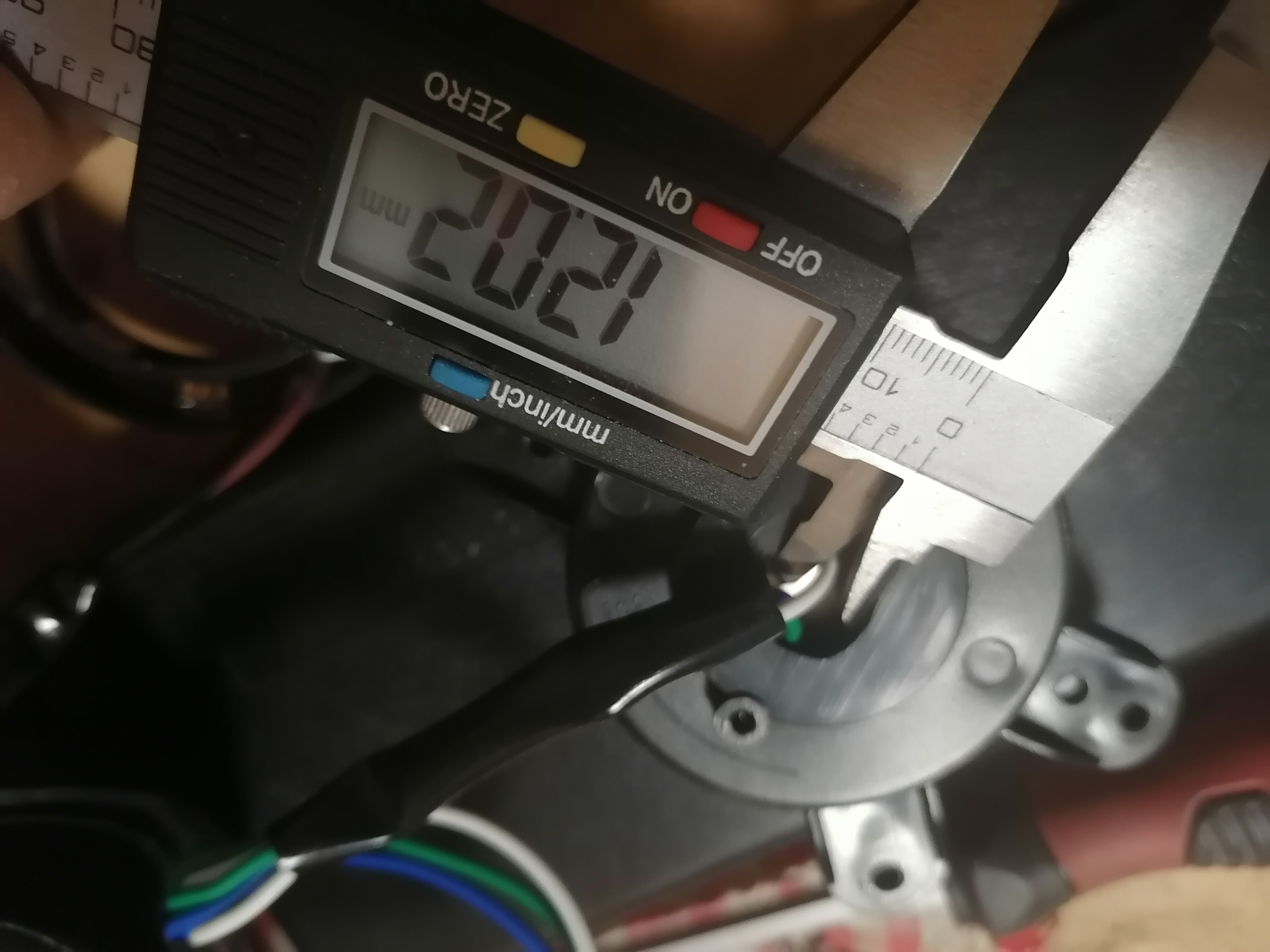

Headlights part II
These should fit: I have to measure angels rings and decide.

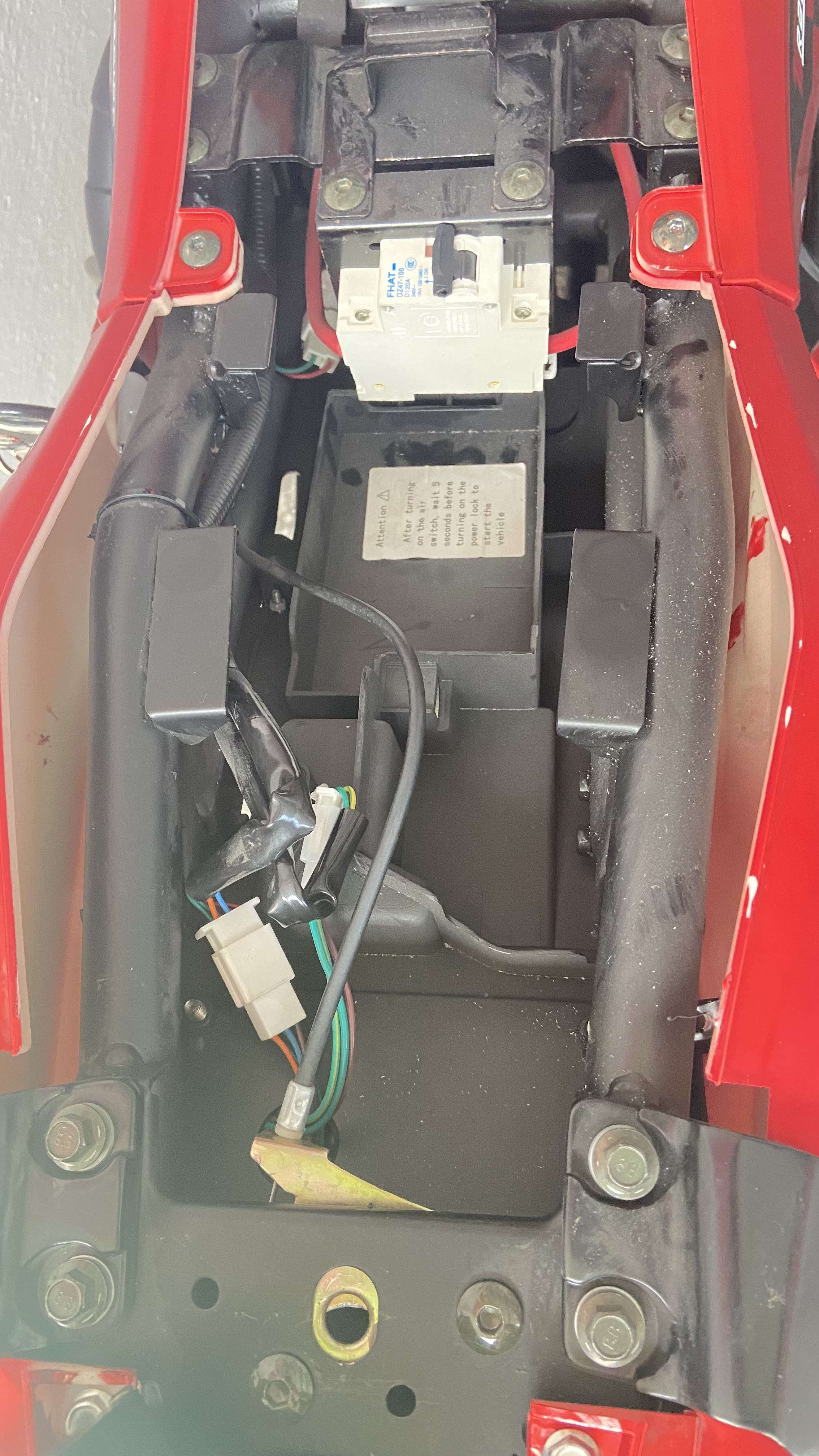

Hi buddy, welcome in our E-Odin familyTaTaPuH hat geschrieben: Mi 15. Nov 2023, 17:16 Hallo zusammen, heute habe ich einen e-Odín v 2.0 gekauft
It had to fall down, the easiest way is to unscrew that two screws that holds circuit breaker, that will give you more space to look inside. Look for blue Julet connector. If you will not find it, you will have to take off right side of panels. Jeff shared his manual how to do it, check the begining of this thread.TaTaPuH hat geschrieben: Mi 15. Nov 2023, 17:16 1. Kein Anschluss für die Verbindung mit einem Computer

Auch kann ich auf dem Bild die Alarmanlage nicht sehen, du solltest mal die rechten Seitenteile abbauen, über dem Batteriefach hängt der Contoller
und dort ist ein Breiter Stecker mit allen Anschlüssen unter anderem auch der zum Programmieren.
