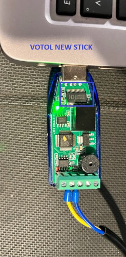

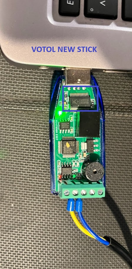

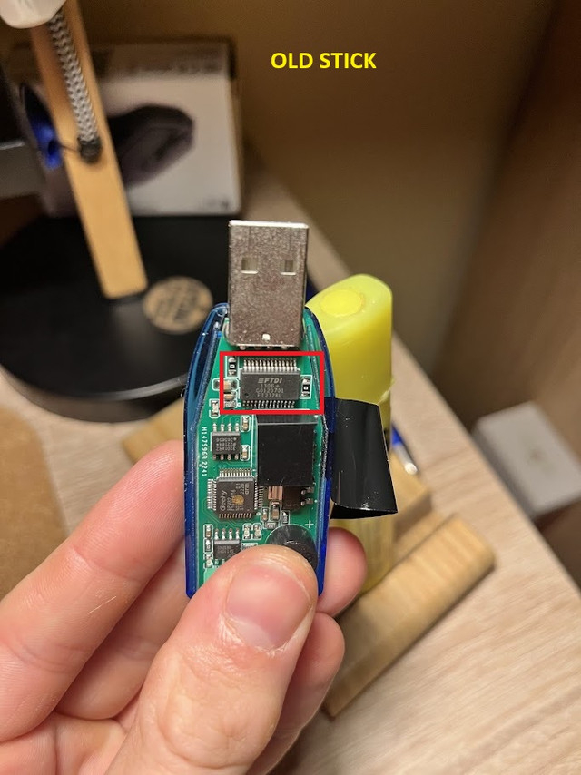

I also bought two sticks, one was “good” (the first one I bought now years ago from an Aliexpress link seen here on the forum) and the other one recently, actually change the serial chips between the two.
I attach “old” and “new” stick photos.
OLD
NEW
With both sticks I really tried a lot... I went a little “crazy”, and with neither of them I succeeded.
The thing I actually noticed is that when I do “RESET” connected to the scooter (which you rightly say not to do...) with both sticks, I hear the relay click and the controller reboots, “MCU TOUT” comes out on the display for a few seconds, evidently because the stick still has a wrong speed interfering with the CAN of the scooter, as you say.
This evening I will try again by doing as you say, configuring the controller unplugged from the scooter and plugging it in only afterwards. i will also pay attention to the change on PAGE3, do you use a specific version of the program? I have a v3.39 - 3.40 and one “patched” by an Indonesian guy, tried all 3 of course.
Also, when you plug it into the scooter is the scooter already on or do you turn it on later?
When should it automatically adjust the CAN speed?
Thanks again!

lorenzo.deluca hat geschrieben: Mo 16. Sep 2024, 13:49 Yes, I read your post but like all German ones the English translation is sometimes unreliable . :/
Well, I'll do my very best...
In the other discussion, we have lots of pics of both versions, here are mine: viewtopic.php?p=328451#p328451
Some explanation: viewtopic.php?p=329353#p329353
Your sticks are similiar.
What I declare for sure: Neither the USB-serial converter chip (FDTI vs WCH 9101) nor the used windows driver has any effect for a working or not working connection.
What confuses me:
So, the RESET seems not only reset the stick itself (I noticed that it disappears for seconds in the Windows device manager), but sends a kind of reset command to the controller. A short relay click and a controller reboot is normal after a configuration written to the Votol.
And more: a reset command is sent to the VOTOL via CAN. How can this happen if not the communication has not been set up correctly?
Maybe not. The MotorControlUnit (MCU) aka VOTOL is expected to answer and deliver data on the Silence CAN continously, which is not the case while the VOTOL is rebooting. A short "MCU Timeout" I never noticed before, but I payed no attention to the display when writing a configuration.
I use the EM_V3-40 only. (File details: file version 1.0.0.1, product version 2.0.7.1.)
I connect to the OBD before switching on the scooter, then powering on the stick. In the end, the order has no effect, I can always connect.
Good question. At least when the stick is powered on. Maybe with newer sticks/firmware with the CONNECT button. With no CAN connection, the red/green LED are steady bright for ~1s, then off. With a live CAN connected, they only flicker, ~10% of their maximum intensity.

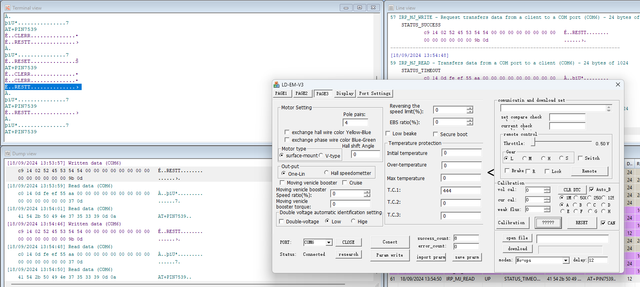

Here I am again, I am trying to look into the subject because in my opinion it is a question of understanding how to set the stick.
I know a bit about serial communication, so I started analysing like a man in the middle the COM traffic that the Votol software does with the stick, which is also very simple and minimal.
As I think we all realised, when we activate the ‘secret menu’, select Auto_B and press ????? and RESET the software communicates to the stick, and of course this is what happens.
But the thing that I can't explain, and I would like to ask some of you to try, is that whatever setting I select: with or without Auto_B, CAN speed change, A,B,C,D,etc., my software always sends the exact SAME serial message to the stick, which is a simple string of hexadecimal bytes.
I also tried connecting to the COM with a RealTerm-type terminal, sending the same binary strings and the key beeped, activated the TX/RX LEDs exactly as it does with the Votol software... so the commands are always exactly the same.
IMHO it doesn't make any sense that if I check Auto_B or not it sends the same message, otherwise how can the stick activate the Auto Baudrate functionality?!
These are the commands I've ‘sniffed’, anyone want to try their hand with their dongle and software?
Code: Alles auswählen
0xc9 0x14 0x02 0x52 0x45 0x53 0x54 0x54 0x00 0x00 0x00 0x00 0x00 0x00 0x00 0x00 0x00 0x00 0x00 0x00 0x00 0x00 0x9b 0x0d
RESET
0xc9 0x14 0x02 0x52 0x45 0x53 0x45 0x54 0x00 0x00 0x00 0x00 0x00 0x00 0x00 0x00 0x00 0x00 0x00 0x00 0x00 0x00 0x8a 0x0d
CONNECT
0xc9 0x14 0x02 0x4c 0x44 0x47 0x45 0x54 0x00 0x00 0x00 0x00 0x00 0x00 0x00 0x00 0x00 0x00 0x00 0x00 0x00 0x00 0x81 0x0d
I use Eltima Serial Port Monitor to intercept serial communication, but there are also freeware software to do this.
If we could find the correct message I could also make a small utility that would automatically confiure the stick, it would of course all be open-source :)
Thank you very much!

Yes, exactly.. BUT, anyone can try analyzing serial traffic while changing CAN parameters and click ?????, RESET ?
Because, as I know, in some way Votol software has to tell the stick to change its CAN parameters (Auto_B, etc...), otherwise it will continue to function as configured.. :?
