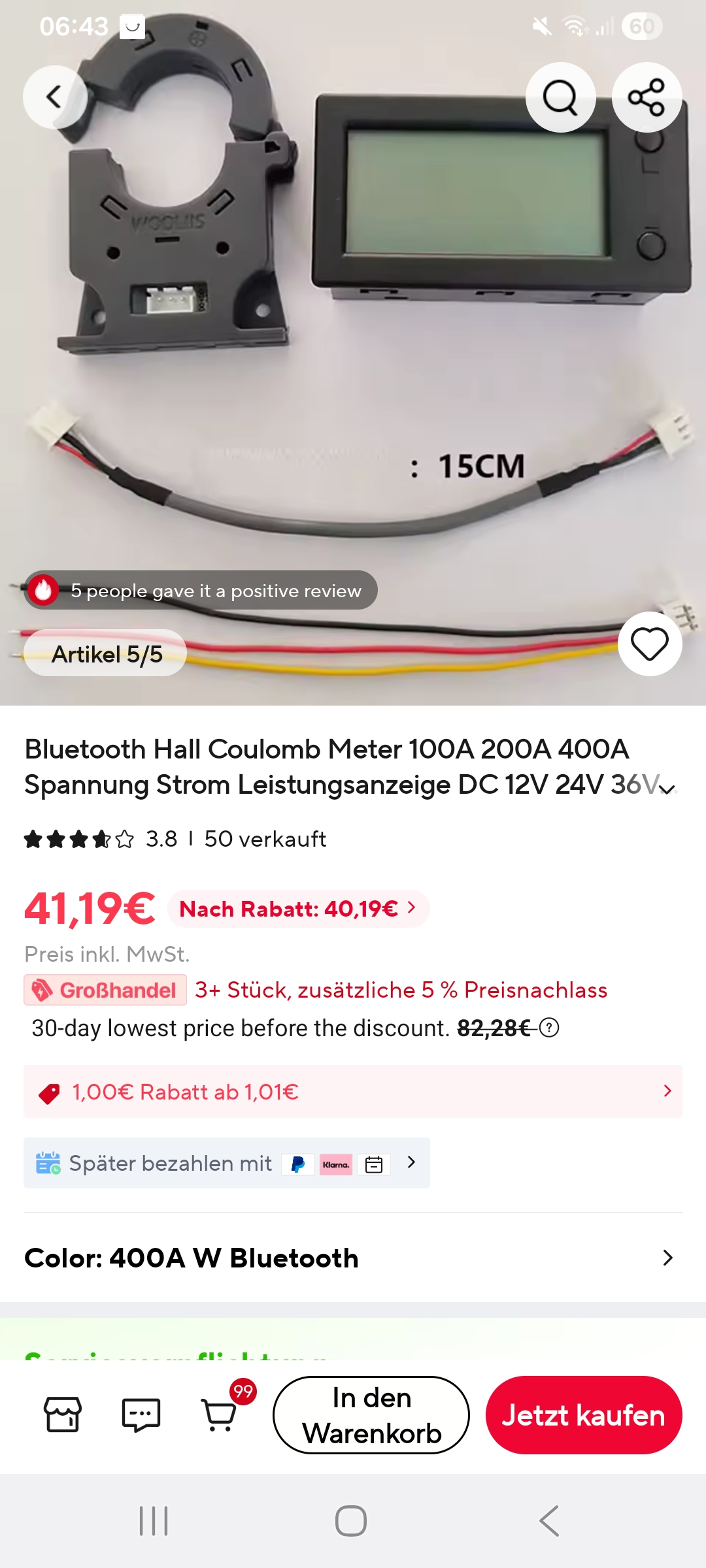

What about a 2 wire waterproof voltmeter (just a volt-meter), or this one (the round, external one is waterproof)?bob2.0 hat geschrieben: Fr 8. Mai 2026, 10:44 ...
The only snag is that I cannot find a 3 wire waterproof voltmeter to buy.
Or even a real coulomb-meter (with 300A shunt), that allows you to determine much better what's left in the tank (battery).
Of course, installation of the coulomb-meter, with inserting a shunt into the 4AWG wiring of the battery requires much more work.
Classico Li 05/2020 11k+ km & Z-Odin 12/2021 43k+ km

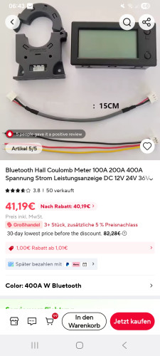

Or this one.
No need to cut or unscrew big wires.

Yeah. Or this one or that one (200A, a little bit cheaper).dominik hat geschrieben: Sa 9. Mai 2026, 06:44 Or this one.
I used such a coulometer with hall sensor for a while, but I always had the problem that it was pretty inaccurate measuring the current (the zero-point always drifted approximately +/- 0.3A, depending on the outside temperature).
Furthermore, it was not waterproof, which meant it had to remain in the "fuel compartment"—which is less practical if you want to monitor the voltage during acceleration.
