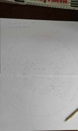

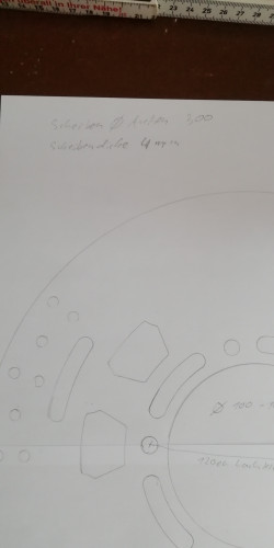

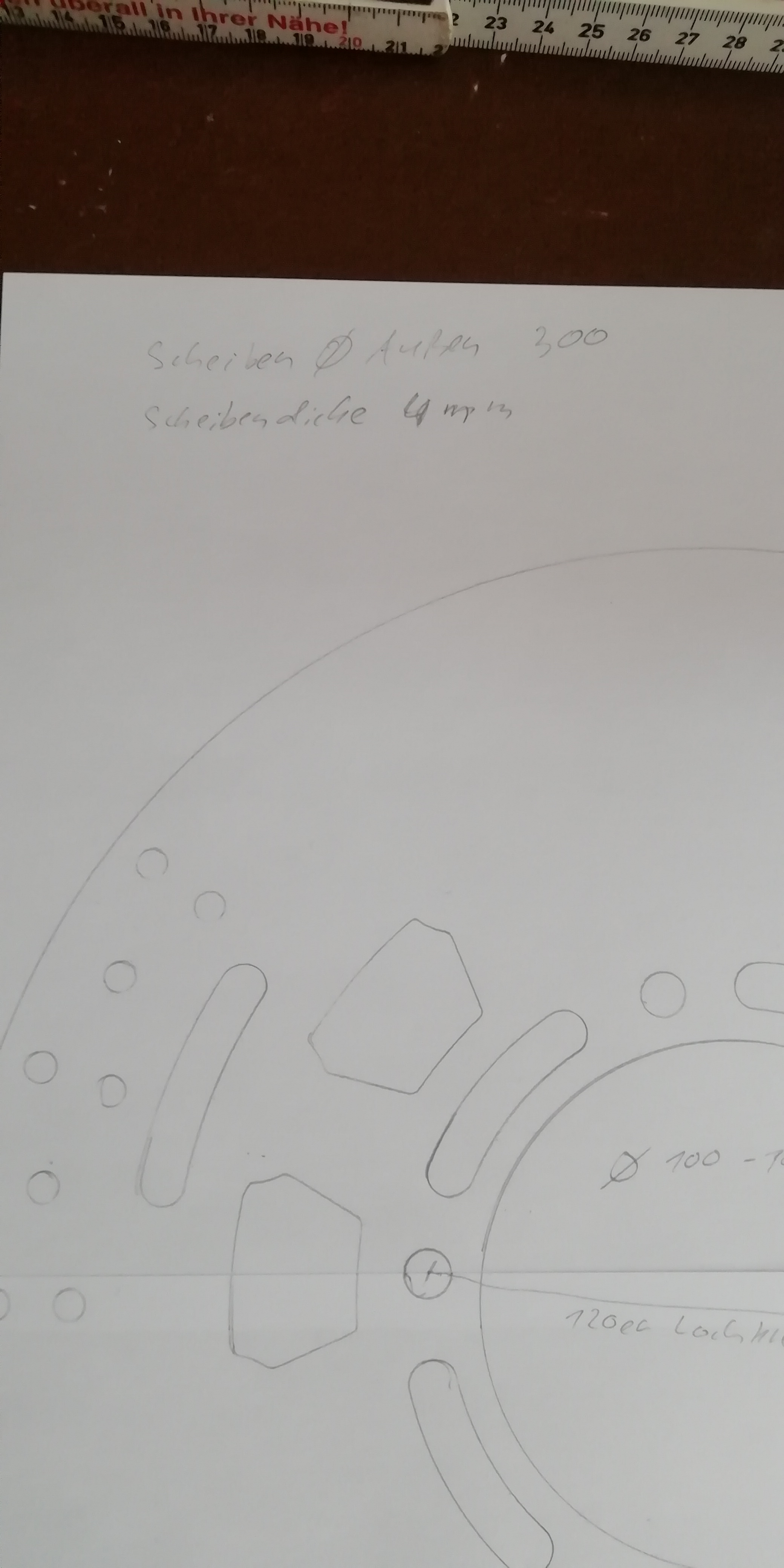

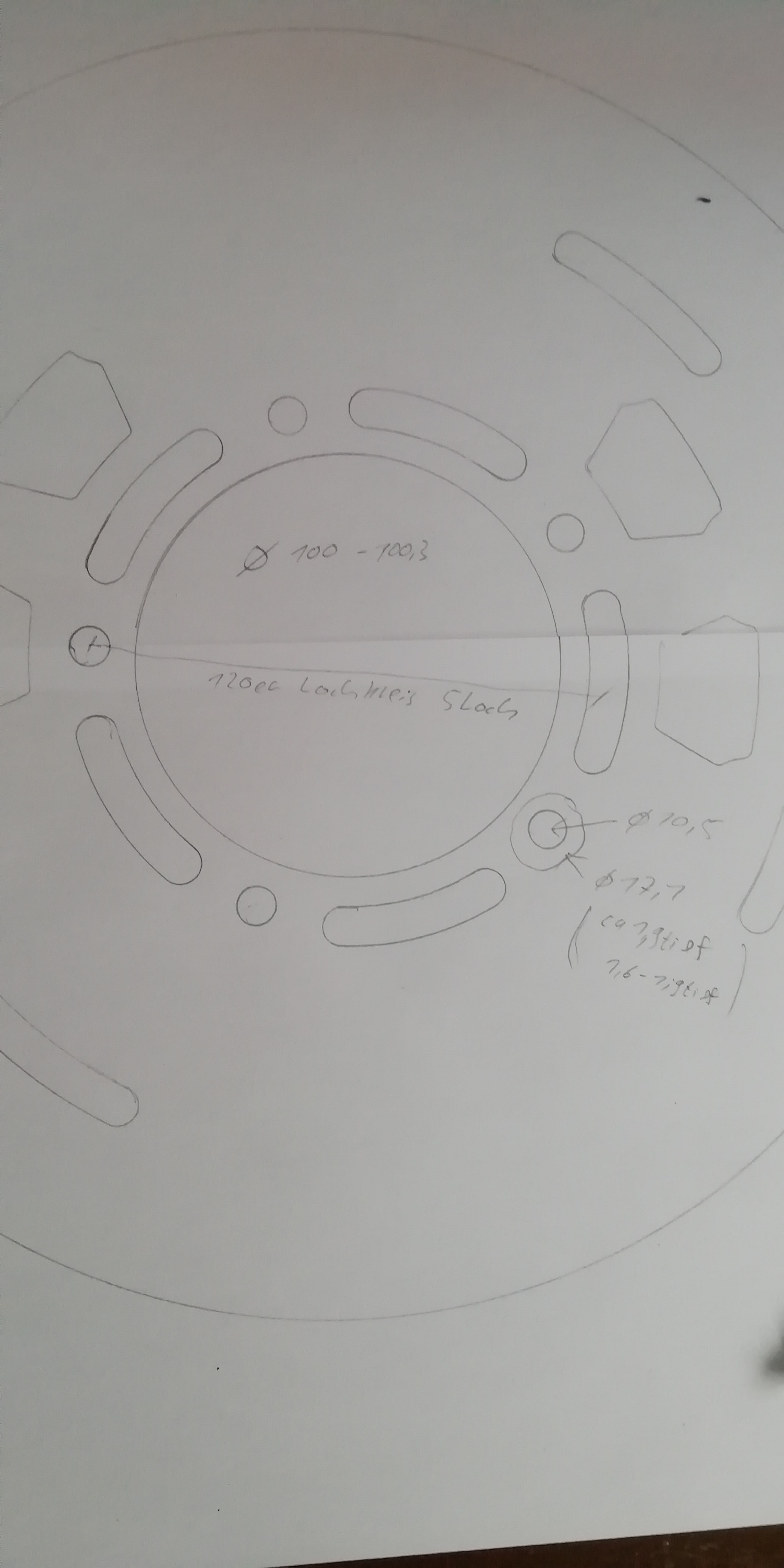

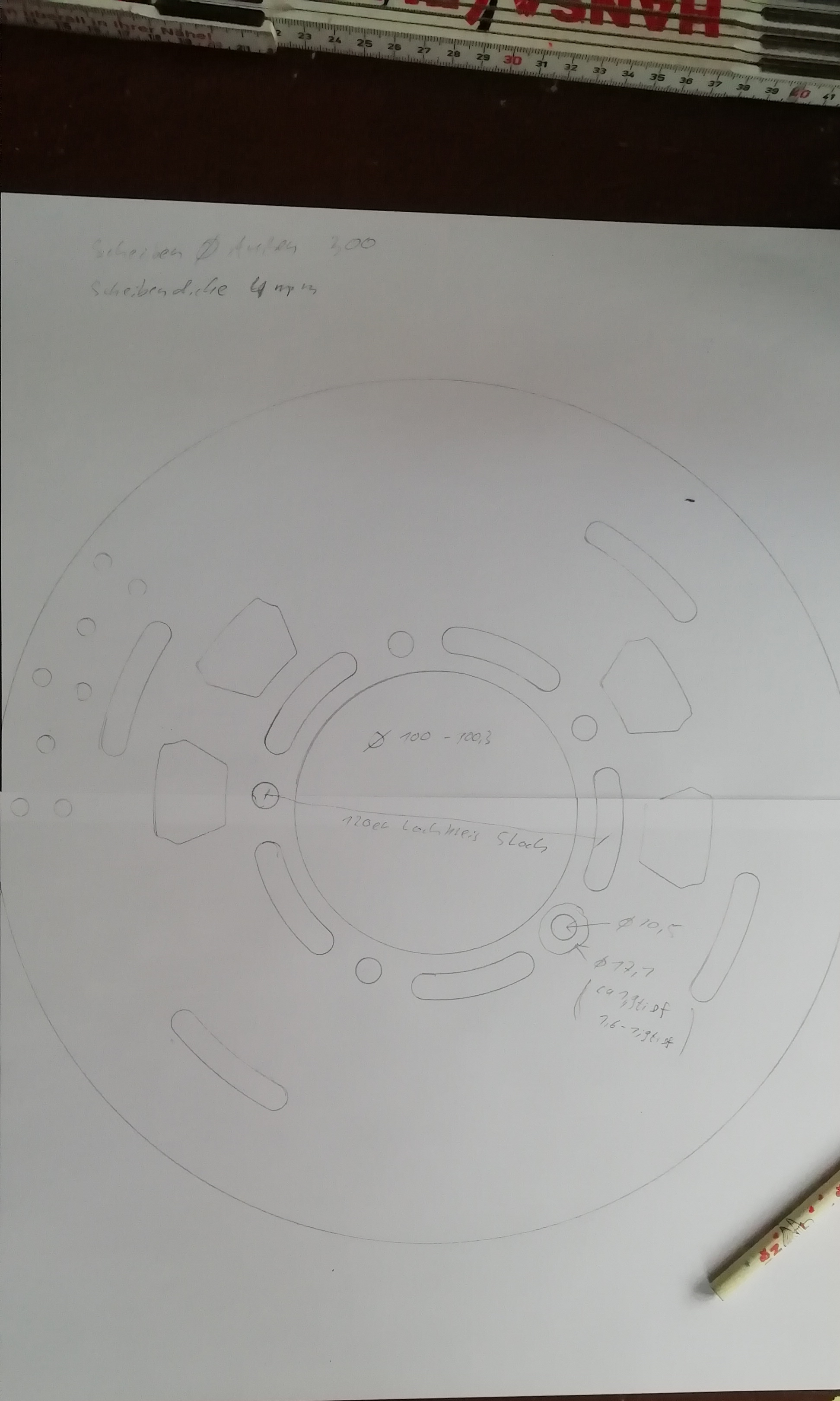

Hier noch die Skizzen ( Schmierblätter) meiner damaligen Messung .
Der Lochdurchmesser 10,5 ist auch bei unseren Bremsscheiben da die M8er Schrauben einen “Schaftzapfen“ hinten von ca. 9,mm hatten wenn ich mich richtig erinnere.
Die Scheibe ist allerdings nur 4 mm dick.

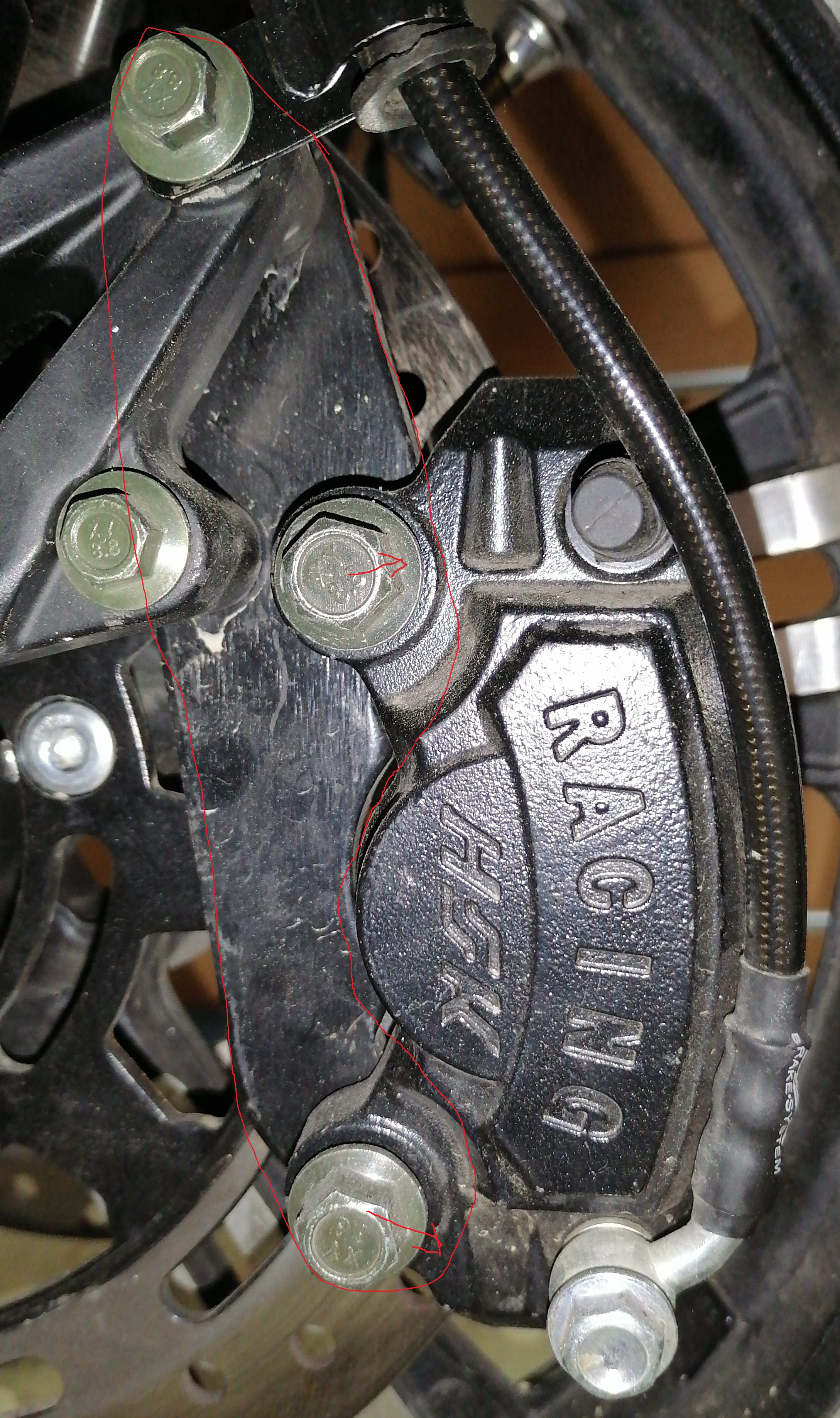

It seems that Jeff with "older" brakes (with red buttons) has no problem with 300mm disc but you with "newer" brakes can not use them. I have same brakes like you and as I checked it out, really, there is very very small gap between disc and caliper, have to measure it precisely, but it is not more than 1-1,5 mm (it seems that it should be enough but we know that it is a risk).
As I wrote, I believe that these discs are copies of something that already exists on some bike. TRW and Brembo are not the only one manufacturers, there is NG, EBC etc. so I do not surrender
