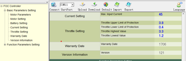

Where is in the controller shell I change the setting?
Is this the right one? “Current Setting” Max input Current: 45.

Re: quick start Lingbo Controller
Yes .. this is the value
Try 55A and Go step by step back, if any issue accure
If there is no issue and you aren‘t satisfied… you can go to 57A … but 10A plus should have a positive effect
