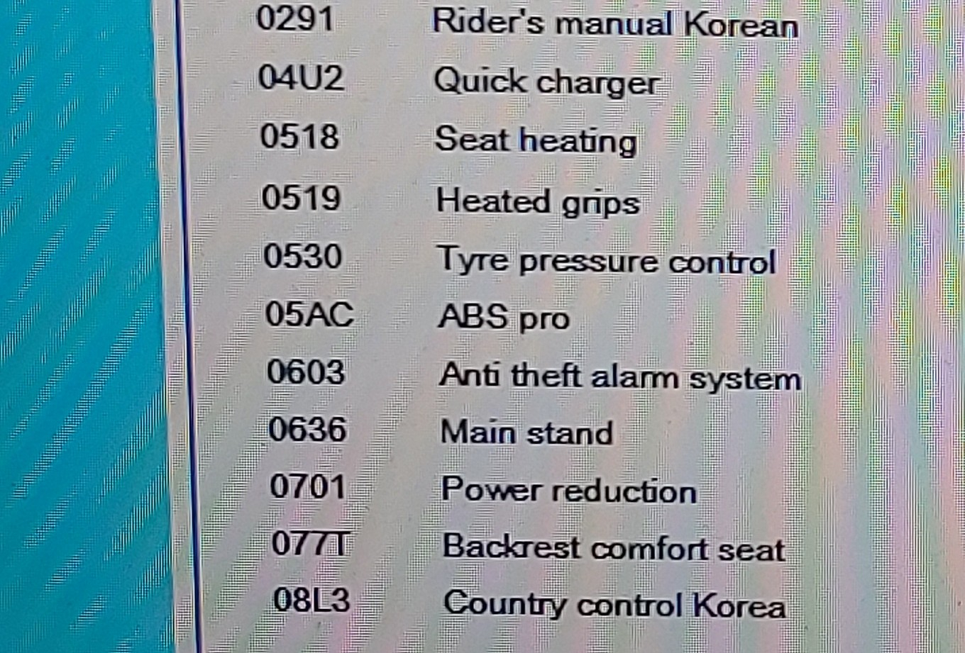

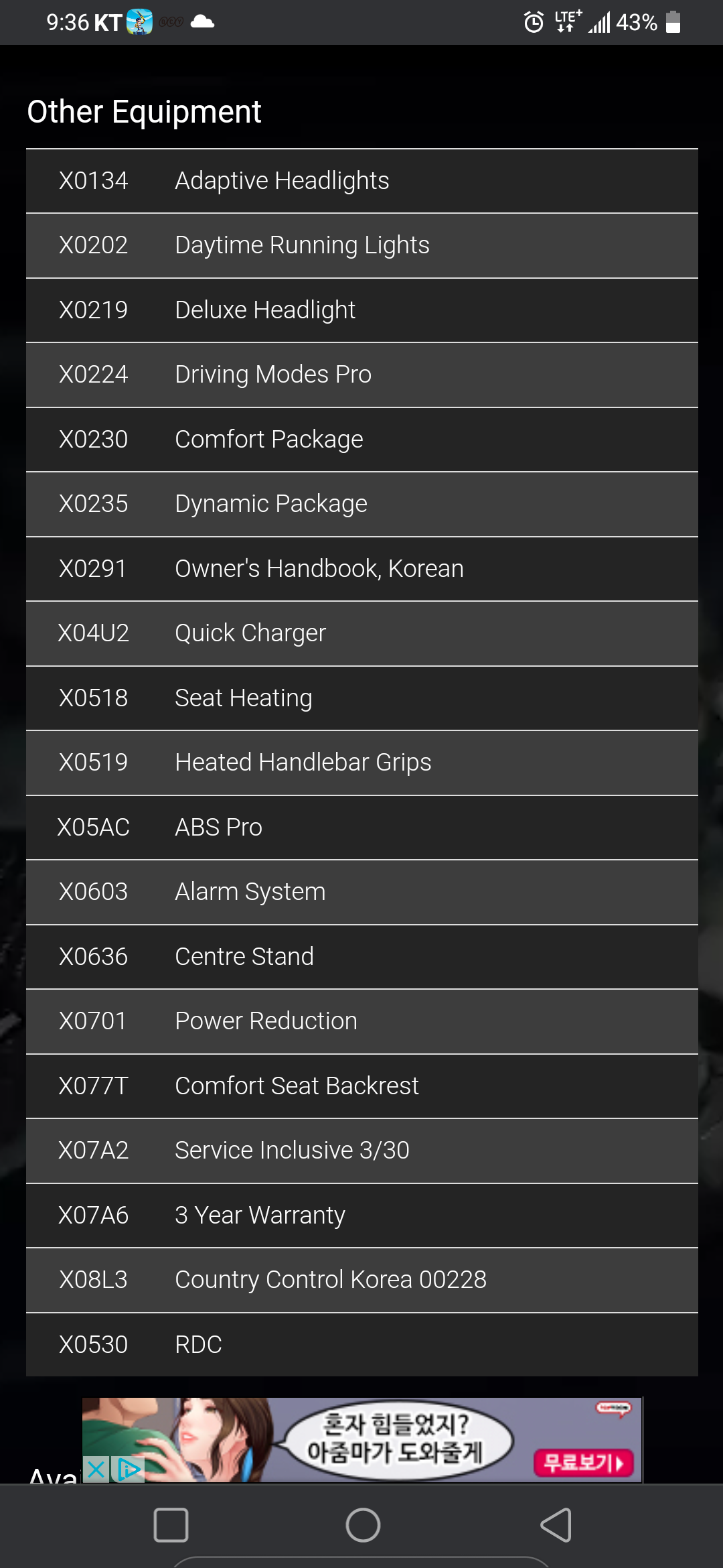

https://www.mdecoder.com/
If you go to the link above and check Vin, 701 is included. Could you check the vin on the link for the person who is riding a1 and upload the picture?
BMW decided to sell only a2 in Korea. However, Ce04 that entered Korea includes the 701 option. Please help the consumer to prove to the dealer whether it's a1 or a2.
