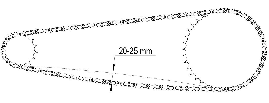

Habe am Wochenende die Kette etwas mit Papier gereinigt, weil sie bisschen Geräusche gemacht hat und jetzt rasselt sie übel. Hat jmd. die Kette schon nachgezogen und weiß wie es geht? Wäre sehr dankbar.

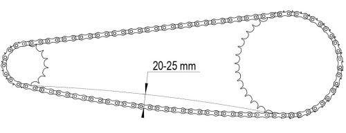

Re: Tromox Mino Kette spannen
Chains, sprockets and their tightness
(1) Measure the chain at the lower end of the middle of the sprocket;
(2) Measure the chain at 3-4 position of rear wheel, find the most tight chain position.
(3) When the tightness is correct, the swing amount of the chain at this position is 20-25mm.
Lubing the chain
Give the chain a squirt of lube every 300km, and fully lubricate it after cleaning at the 1,000 to 1,500km mark.
It’s best to lube the chain after a ride, not before, because the lube will better penetrate the hot links.
Spray lube on the inside run of the chain, not the outside where it will just fling off. Aim to get lube between the inner and outer plates and in between the rollers and side plates.
Thank you very much. Now i have 25 cm diffents
