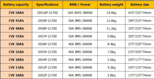

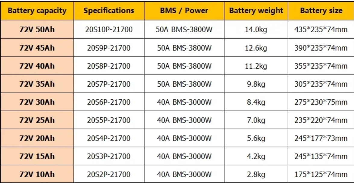

For example;
https://www.aliexpress.com/item/1005007185197459.html
"72V 20S4P 40Ah 21700 Lithium Battery Pack 3000W"
At a cost of ~Euro 100.
This one gives a dimension of
245 * 177 * 73mm
I don't believe for a moment that they can cram 40Ah into that space at 72V, so some further enquiries would be needed.
It says " 4P x 21700 cells", and those are usually around 5Ah, so probably it is a 20Ah pack.
But if we are aiming within 280 high/wide and 340 long, then we could pack 4 of those longways and still have space for two more at 90 degrees.
Whatever they are in actual capacity, the sum total of 6 will likely be over 100Ah and cost ~Euro 600.
That was my initial thinking.

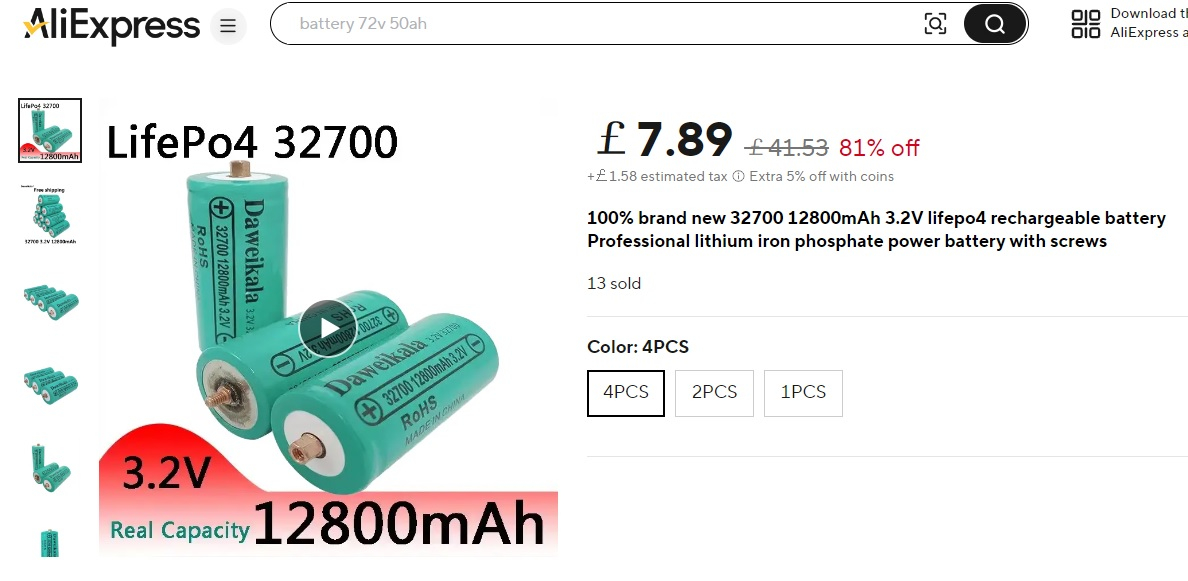

How about 256 of these?
I think these would cost ~£600 for 10 strings of 24 cells in each.
If the cells are packed in a 9 x 8 square, filling 285mm x 250mm, with each string 4 cells long, being ~300mm, then that is 9 x 8 x 4 = 284, or 12 strings of 24 cells each string. That's LFE / 24S, so at fully charged = 140Ah x 87V = 10kWh nominal.
Thoughts on the madness?

I once bought a similar battery pack (as in your first link) for my "spare can" project, look at this posting.
But it wasn't worth the shipping, so I ended up buying a proper eBike battery.
These chinese capacity and power readings, especially for lithium batteries, are often a fake.
You can buy 18650cells at AliExpress with 15000mAh, but if you're lucky, you'll get approx. 200mAh out of them.
Anyway, even a BMS (as in one of your links) with 3000W is a joke for our E-Odin.... it wouldn't stand the power for a minute.
With the genuine controller, the E-Odin draws about 125A when accelerating, so the minimum limit would be 11 kW.
Using the ND72530 (instead of the original one), my E-Odin draws a max. current of 150A. So the BMS needs to cope with 12.6 kW peak.
If I'd need to replace my battery, I wouldn't buy one with less than a 200A BMS (-> 16.8kW peak).
Furthermore (due to safety reasons) you need a pack/battery with a solid steel box, not styrofoam and shrink tube.
And, last but not least, you'll need to wire the battery (batteries) up with at least 16mm²/AWG6 silicon cable.
