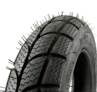

The best price for the Heidenau was still a bit more than I wanted to pay, so I thought I'd go with a Kenda K701 which is a winter tyre.
WhatsApp Image 2025-03-31 at 09.37.06.jpeg (75.19 KiB) 1723 mal betrachtet
The reason is that they do a 110/70 17 and all the reviews are extremely positive, indicating low wear throughout the year. It's like no owners had anything at all bad to say about them.
Who knows for sure. You try a tyre and you get stuck with it for a while. People can only talk about what they have, they can't try many different tyres. But I will be fitting it myself so I will avoid the fitting costs.
There was something else I realised too. The rim on the e-Odin is a 3.5" (that is what I measure it as) which limits the size options, according to this chart.
I cannot go smaller on the e-Odin rim (the chart says), nor a taller profile.
I will be changing off a 120/70 from another bike, which is still in good shape, so I think I will swap that over to the e-Odin first of all. The reason I am doing any of this is because I want to get rid of the castor shimmy on mine at 40 mph. If it is because of the tyre, then I will find out by putting on a tyre I know does not shimmy on another bike. If it still shimmys, then I have to take a longer look at the head bearings on the e-Odin, but they seem OK to me as far as I can tell.
