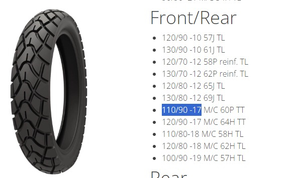

I was thinking of something like the Kenda K-761 as it is a cost effective general tyre, but like many of these dual purpose tyres there are limited size range.
The 90 profile would add 10 mm height, but maybe this is not a bad thing as the suspension is quite hard?
Has anyone else had these thoughts, something with wider terrain capability for the front because performance isn't something worth worrying about?

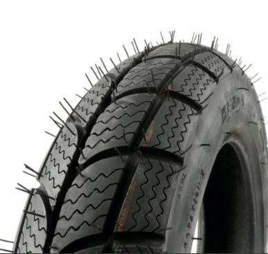

The best price for the Heidenau was still a bit more than I wanted to pay, so I thought I'd go with a Kenda K701 which is a winter tyre.
WhatsApp Image 2025-03-31 at 09.37.06.jpeg (75.19 KiB) 1645 mal betrachtet
The reason is that they do a 110/70 17 and all the reviews are extremely positive, indicating low wear throughout the year. It's like no owners had anything at all bad to say about them.
Who knows for sure. You try a tyre and you get stuck with it for a while. People can only talk about what they have, they can't try many different tyres. But I will be fitting it myself so I will avoid the fitting costs.

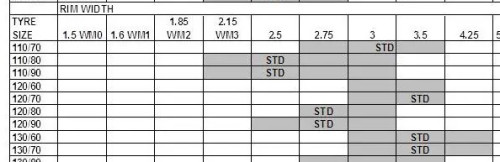

There was something else I realised too. The rim on the e-Odin is a 3.5" (that is what I measure it as) which limits the size options, according to this chart.
I cannot go smaller on the e-Odin rim (the chart says), nor a taller profile.
I will be changing off a 120/70 from another bike, which is still in good shape, so I think I will swap that over to the e-Odin first of all. The reason I am doing any of this is because I want to get rid of the castor shimmy on mine at 40 mph. If it is because of the tyre, then I will find out by putting on a tyre I know does not shimmy on another bike. If it still shimmys, then I have to take a longer look at the head bearings on the e-Odin, but they seem OK to me as far as I can tell.
When I take the wheel off, maybe I will find the front wheel bearings are tired.
Du bist sicher, dass du eine 3,5 Zoll Felge hast?
Die Odins mit 110er Reifen haben laut COC Papier 3,0 Zoll Felge
Die Odin mit 120er Reifen haben laut COC Papier 3,5 Zoll Felge
Meine Odin wurde mit 120er Reifen ausgeliefert und in den COC Papieren steht 3,5 Zoll auf der Felge steht aber 3,0 Zoll.
Haben wir vor kurzem erst festgestellt durch die Nachfrage in diesem Thread!

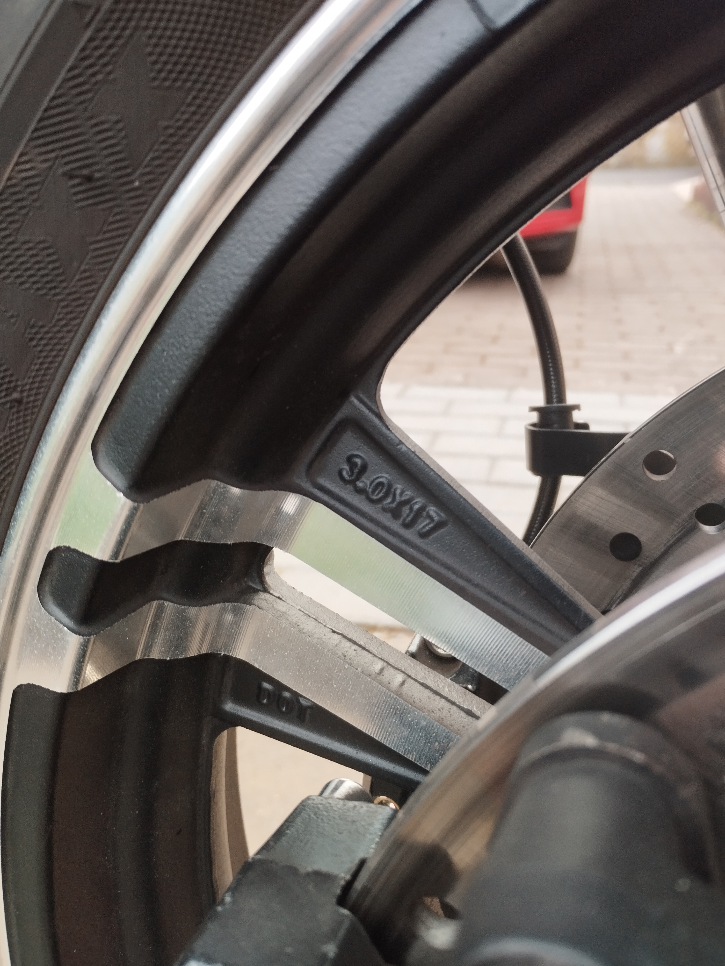

Mine is like your photo, it says '3' on it.
It seems like a wider rim to me than that.
Zimmermännche
Beiträge: 333
Registriert: Sa 31. Dez 2022, 16:32
Roller: E Odin 10kw Typ2
PLZ: 555
Re: Best alternative tyre options?
Beitrag von Zimmermännche »
bob2.0 hat geschrieben: Mo 31. Mär 2025, 19:39 Mine is like your photo, it says '3' on it.
Ja alles etwas komisch.
Laut COC habe ich 120er Reifen mit 3,5 Zoll Felge, auf meiner Odin ist auch ein 120er Reifen montiert auf der Felge steht aber 3 Zoll.
Kauft man die Odin mit den Standard-Chinareifen sind dies 110er Reifen und in den COC steht 3 Zoll...
