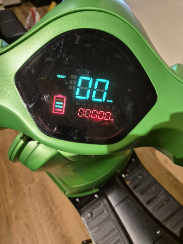

My e scooter, djjd cashmere , drives fine. Everything work well, but no speed signal to my digital display, speedo meter.
Al other functions on display works okay.
May be its from that the scooter was new, cause on odo meter also no km noted.
I checked the wirring, and the white cable, with a black mark goes to Pin 17 , at the 30 pin connector , from the controller.
I checked ofcourse the cable, the cable is okay.
When i put at the cable for example 12 v, my digital speedometer works okay.
So im almost sure, there is no output at pin 17.
Also checked the other wirring , hall sensor, throthle , and more, all works normally.
Anyone any advise here ?
