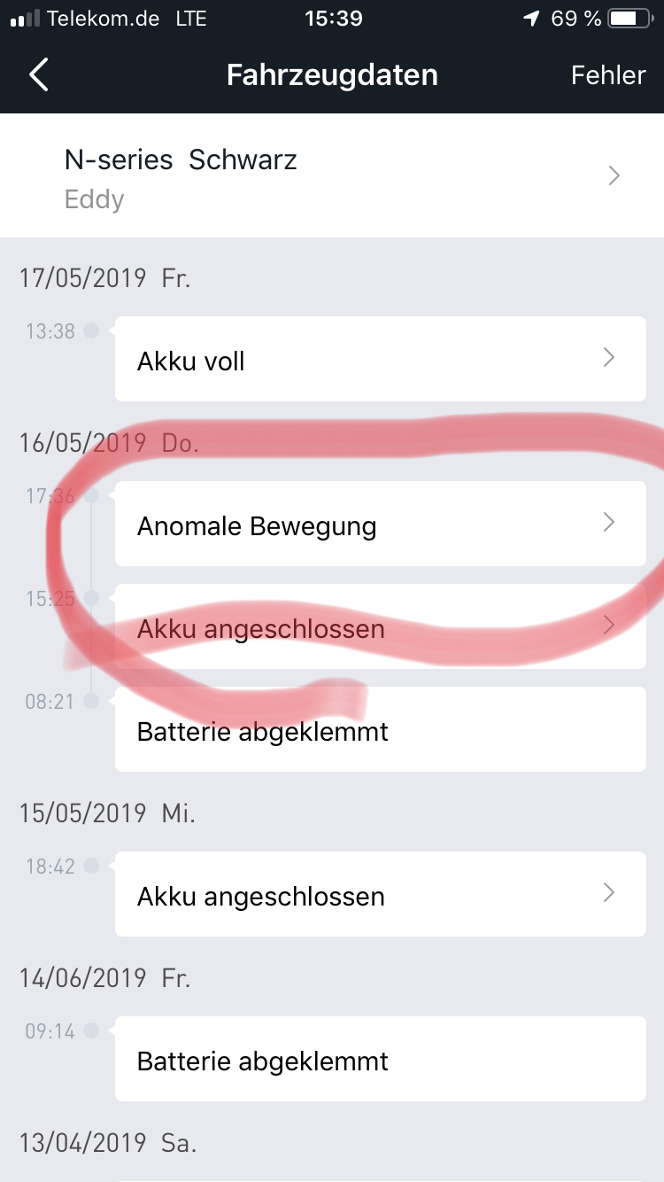

Hier mal ein Screenshot der „Alerts“

Can you normally reproduce the security message, for example if the ignition key is set to "OFF" or "Lock" and then the scooter is moved or shaken heavily?
Or is that abnormal movement shown alert without any explanation?
Have you ever received any of the other security notifications listed in the alarm settings?

My suspicion is that Niu is trying to get the anti-theft/alarm notifications for the ECU's (pcba version 2) working like the Ngt & Npro which do get a notification in the Niu App when for example the scooter has fallen over; when the scooter vibrates; when the scooter is moved when the scooter is parked (ignition key lock in the "Off" or "Lock" position).
Today I received 2x the unauthorized movement alert in the Niu App, these were the moments when I made 2x crossings with the ferry (about 500 meters each crossing).
It is to be noted that since today the push notifications come twice, while in the Niu App only one notification is shown.

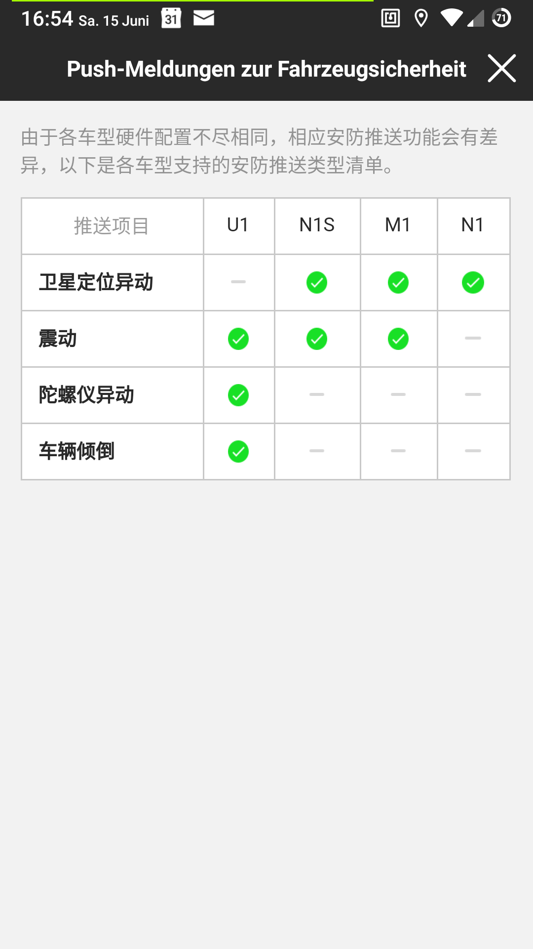

Thank you, it seems like the settings are different for the N1S (2018). I only can change "Anomale Sattelitenpositionierung".Cooper hat geschrieben: Fr 14. Jun 2019, 16:45 See the step-by-step plan below, screenshots are taken from an IOS device, but are almost identical to the Niu App Android version.
Sehen Sie sich den Schritt-für-Schritt-Anleitung unten an, Screenshots wurden von einem IOS-Gerät gemacht, sind aber fast identisch mit der Niu App Android-Version.
On the bottom i now saw a little info icon. But the table that is shown there is only in chinese, so i cannot read it
