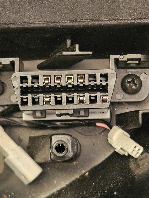

For an unknow reason, I had to change wireing to get it works with my SEAT MO,
Here is what works on my side, based in this numerotation:
OBD pin 6 (red wire on my ODB cable) to Serial-DB9 pin #2
OBD pin 14 (pink wire) to Serial-DB9 pin #3
OBD pin 3 (green wire) to Serial-DB9 pin #5
you can see below the ODB connector of my SEAT-MO :
I hope this will help :)

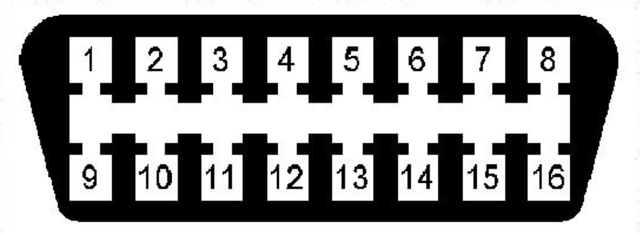

This is confusing. I had checked my cables many times.
With your OBD, no Silence debug tool should work.
Disregarding all mirror/upside down view errors:
- The only edge-located Pin 16 is (+).
- the two midst of the four pins in line (4,5) are GND (-> D-Sub9 #5)
- the vertical/row "pairs" are CAN and AstraSerial. CAN is the pair near to (+).
- Astra TX port should have ~ -5V to GND, maybe -3V. CAN voltages are different
Note that Astra module Ground is connected via the main battery multiple connector to scooters's GND. If the battery is out, you will not see the TX -5V.
