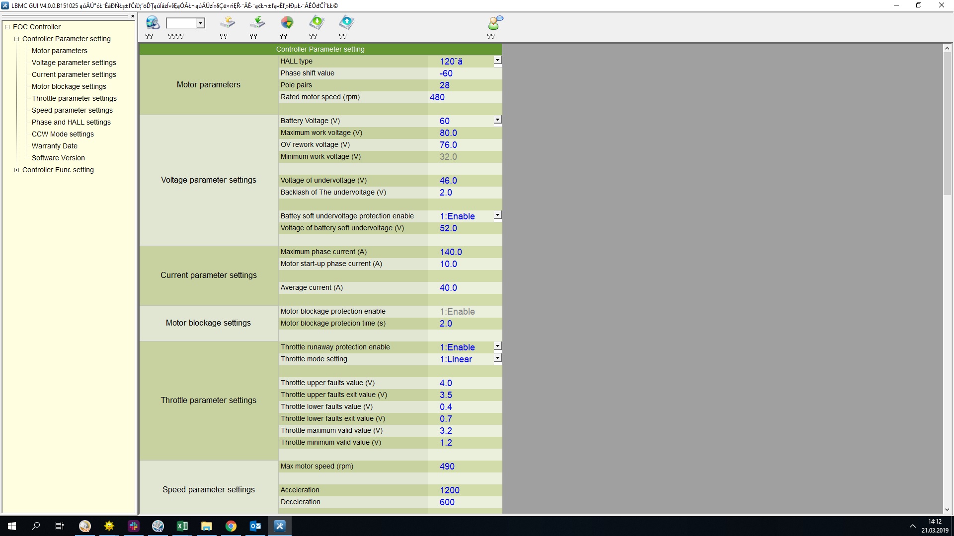

Yes, I just bought it today and it worked TX and RX are the other way around. It works. Now the question I always wanted to ask :) How to speed it up;) the speed limiter is turned off. can any of the parameters still change?
I have a ZNEN 60V300W 60V 35aH li-ion battery. which parameter is responsible for the max speed is there any guide to lingbo parameters? I am currently driving 50km / h my settings below.
Beiträge: 20954
Re: eGrace Controller programmieren
A strange question... What about fiddling with the parameters that have "motor speed" in them? ;)

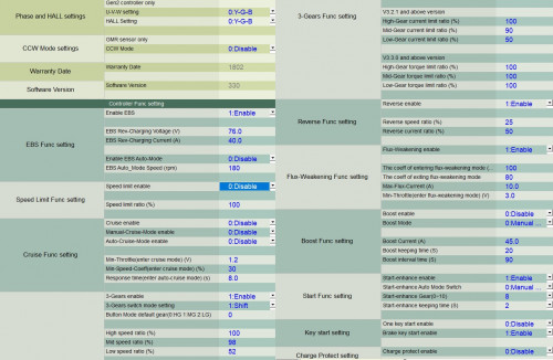

I paste the other pages from the settings below. Can a higher speed be obtained from this scooter? Is this max when it comes to this configuration?
Please guide me what I can change :)
Beiträge: 20954
You have deactivated Speed limiting and activated flux weakening, which both should take away a speed limit and actually slightly increase max speed via flux weakening. But those weakening settings must be tested with care as efficiency can suffer greatly and your motor may overheat if you overdo it.
The most important point to adhere to is to only change ONE setting at a time, test the result, tune, test, and only when that one setting leads to your desired or the optimally possible result go on to the next parameter. Otherwise you might easily change counteracting values and not notice any difference, or have unexpected results without knowing what exactly caused it.
Tuning controllers is very tedious work, even with such a simple GUI...
