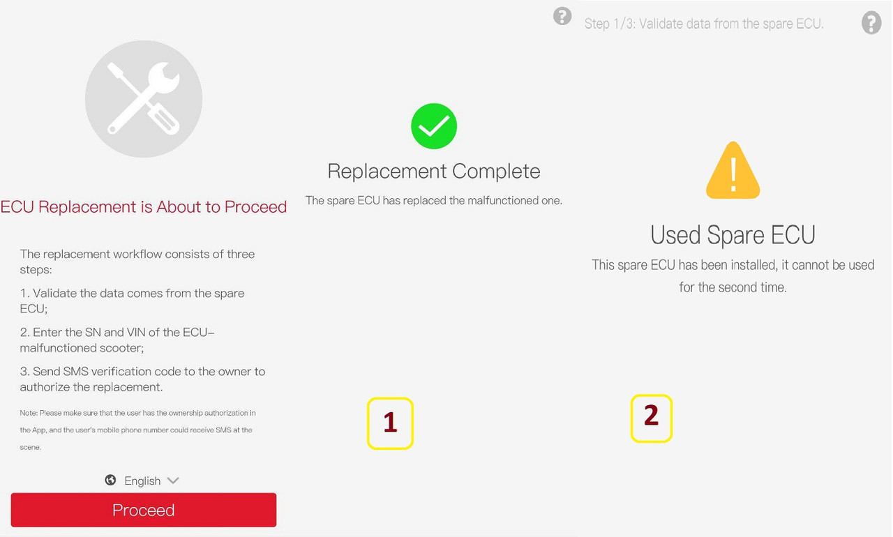

If you have saved a picture of the QR-kode (large sticker on the back of the new ECU) on your mobile device, you can read/scan it in the Niu App.
After selecting "Proceed" info screen, there are 2 possibilities;
You may continue the procedure until the end (screenshot 1) or
the procedure is ended (screenshot 2) .
In the latter case, please report this immediately to questions@niu.com and also put your importer in the cc.

6. There is short - but not always - a screen "Activating Sim-Card". I have this through more often and that does not always popping up.
7. Then "Uploading data from spare ECU, please be patient, this can take 5-10 minutes" "(ie the new ECU), it counts down 10 minutes.
Exactly here I was stuck and I have never seen the GSM icon on the speedometer. That was not the case with the dealer (at the time LTE at the dealers location was probably dead) and 12km away at my home not synonymous. The scooter shows error 67, which is "sim-card not paid or bad reception".
I've probably tried a total of 10x - nothing. [/ I]
So far nothing has happened in the app, the QR code was scanned separately. Only then should it continue like this:
8. Enter the serial number of the old ECU and the VIN. The booklet shows the number of the ECU above, the VIN below the QR code.
Only now experience Niu and the new ECU, in which scooter, the new thing was ever installed and it should be the data incl. Mileage transmitted.
9. The user gets an SMS with confirmation code and then everything should appear in the app.

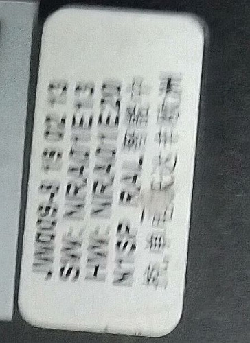

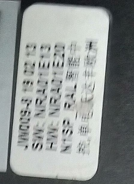

Software: Das dürfte tatsächlich der Fall sein, siehe Bild.
Was ich da lesen kann:
SW: NRA01E13
HW NRA01E20
N1SP_RAL *chinesisch*
Das ist wohl Software für einen N1S, was die Problematik mit dem Mode wunderbar erklärt (STW, danke!).
Daran kann es aber nicht liegen, daß die SIM nicht geht denn die ECU kann bisher noch gar nicht wissen, daß sie in einem M+ steckt.
Vermutlich ist der Rollertyp nur eine Einstellung in der Software und hier steht eben auf dem Sticker, daß N1S eingestellt ist.
Mit Glück hat sich das erledigt, sobald SN der alten ECU und VIN eingegeben wurden.
Wenn nicht, muss der Händler mit dem H1 (Diagnosetool) da nochmal ran.
Und natürlich auch, wenn der Link oben auch nicht geht, dann eben die FW nochmal drüberbügeln.
