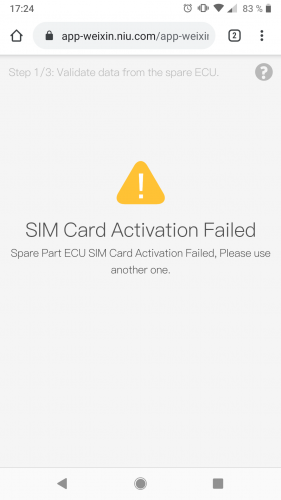

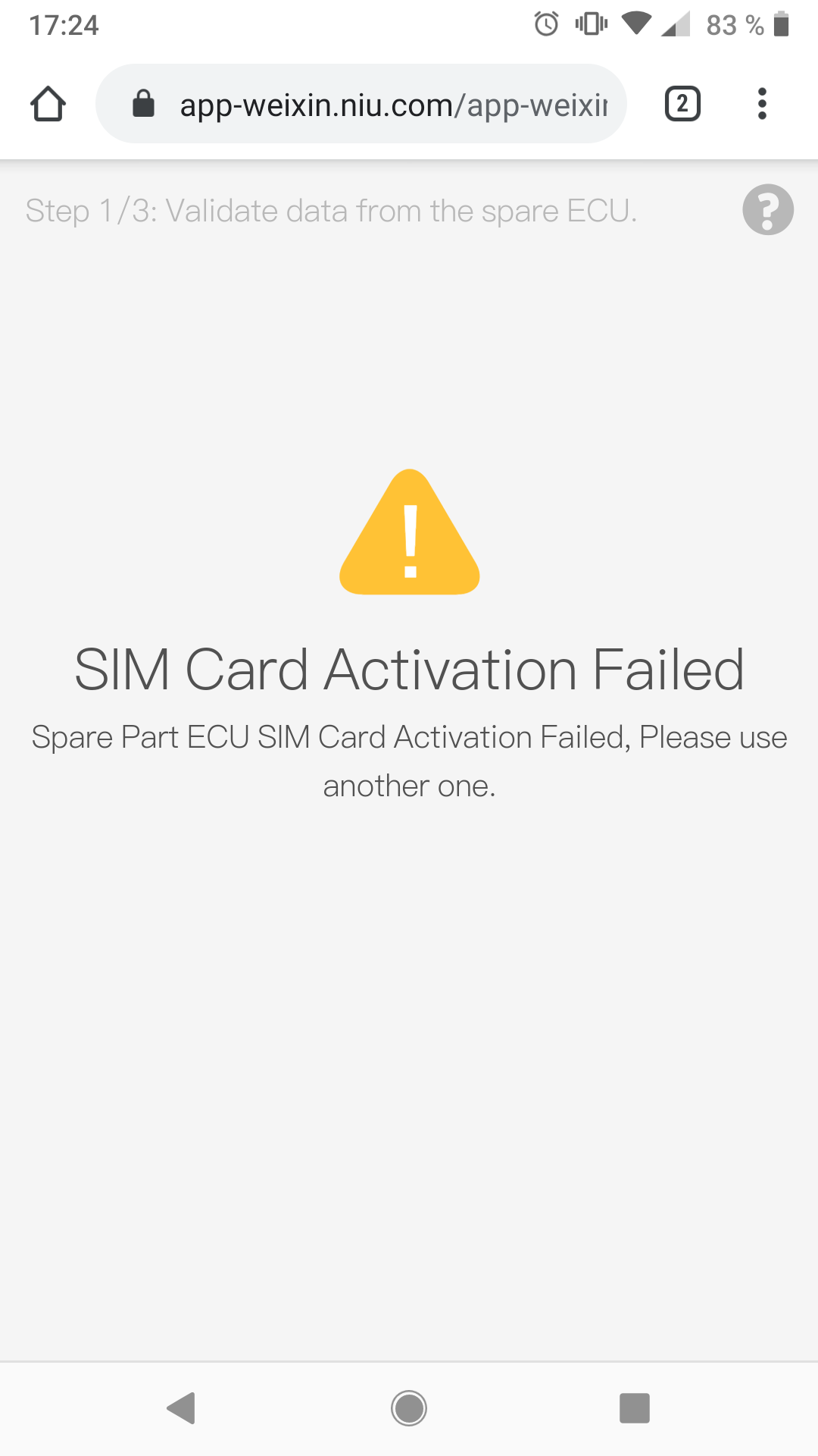

After I just tried again with the URL, I tried again with my mobile with the scan and the first time (after many attempts, maybe 12) I got the first time this message:
I retried and now I'm again at "Waiting for the Data" (for another 10 minutes).
My only clue is now, that the activation is usually confirmed by the server! At the attempt above it failed but usually it seems to be confirmed.
Or should I scan the new ECU from the Niu-app? Does it make sense to try this?

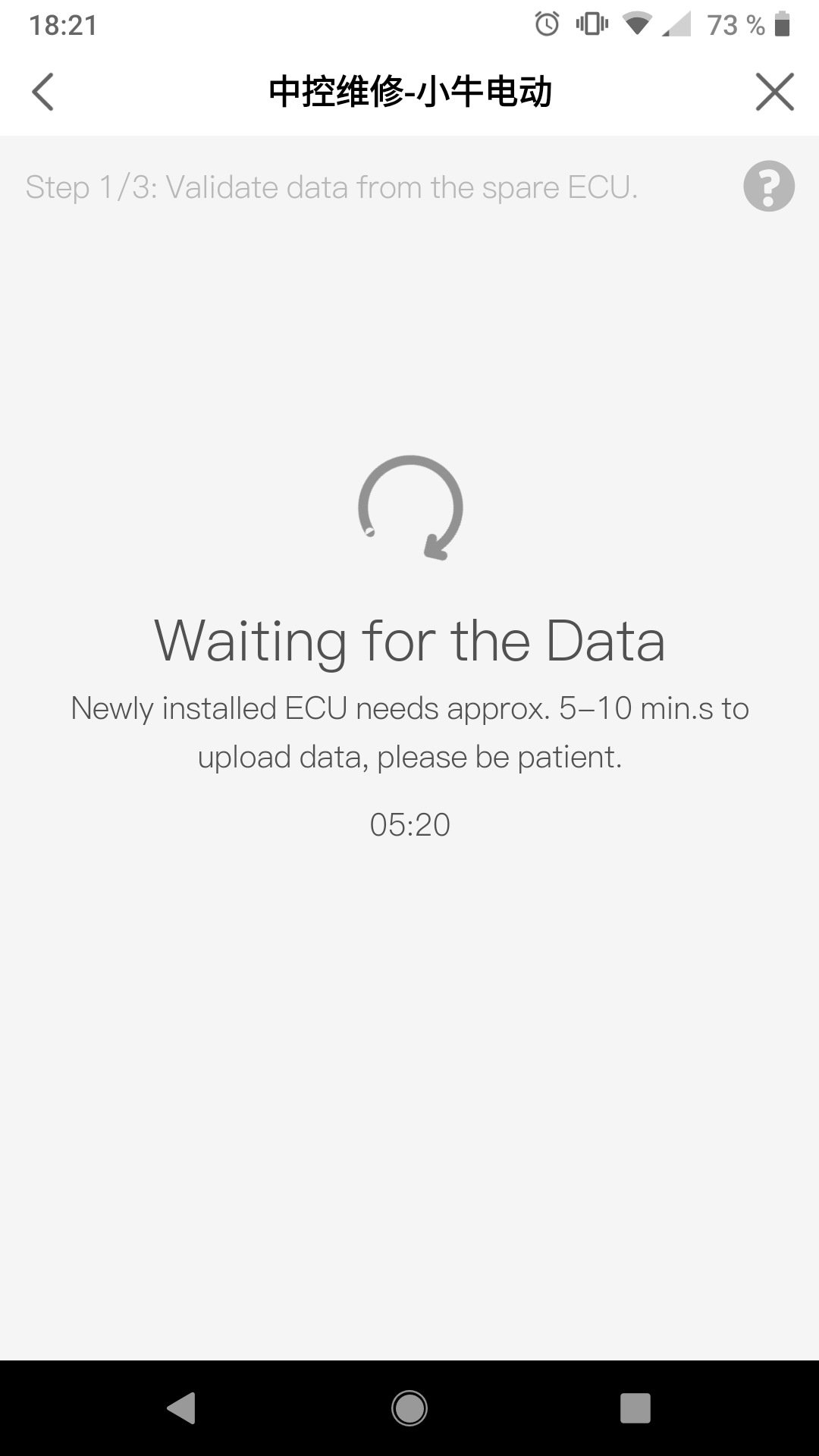

What I mean is from the Niu-App. I'm just trying now. It looks similar but I don't see the URL but some Chinese. But still "Waiting for the Data".
Vom Handy mit QR-Scanner oder PC mit der URL scheint alles das gleiche zu sein. Man landet auf der selben URL.
Was ich meinte ist aus der Niu-App heraus. Sieht ähnlich aus, nur statt der URL sehe ich oben Chinesisch. Aber immer noch "Waiting for the Data".
The Chinese is just: "Central Control Repair - Maverick Electric"
