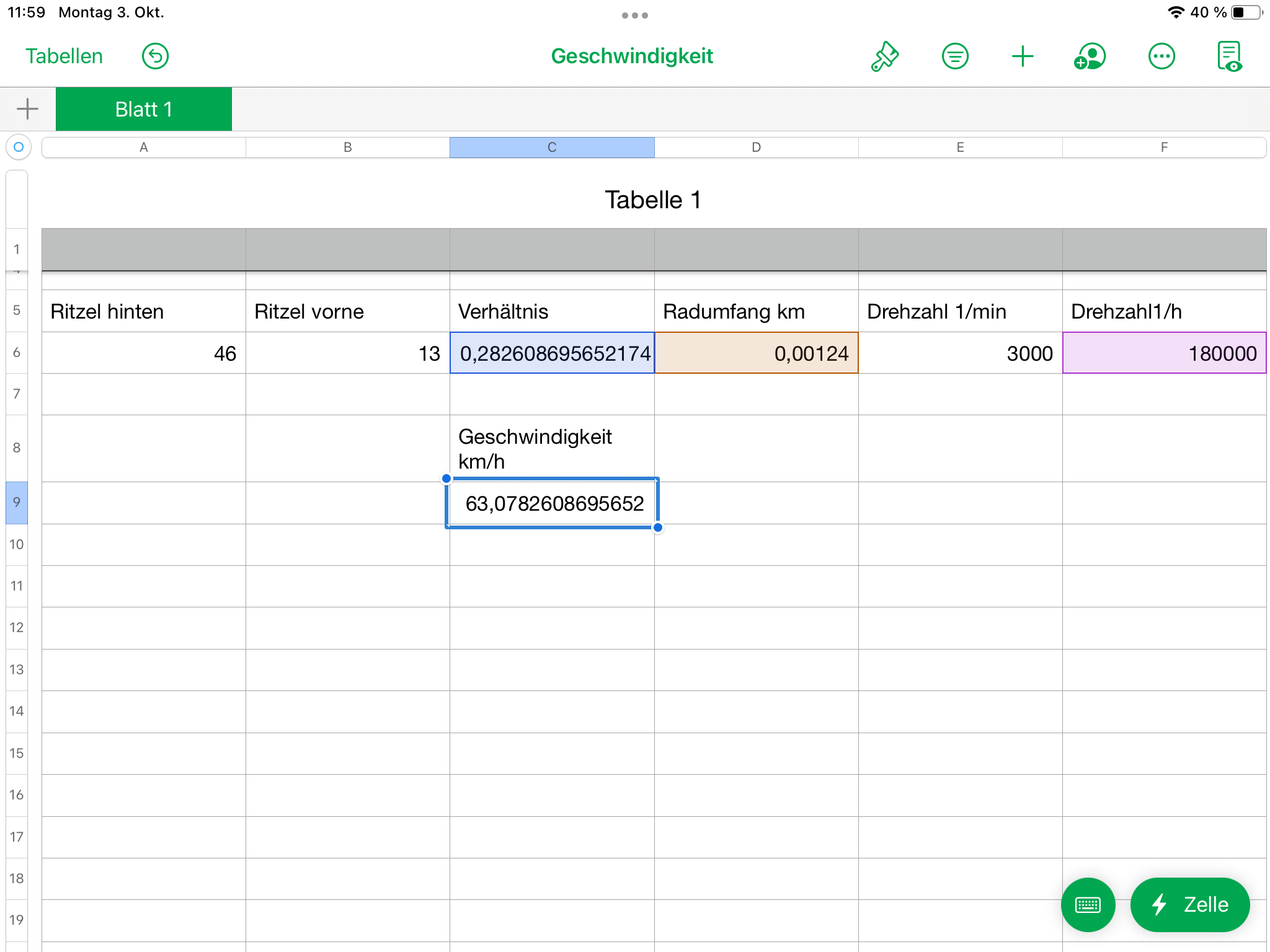

UntiI now I have never disconnected the VCU. I think you just have to pull out the plug. The VCU is located on the right side of the bike beneath the plastic cover. It seams like there is some kind of sealant which you would have to remove. Did you do that? If you push back the small lid of the VCU there is a tiny switch which will switch of the VCU. Maybe that will also work. I have reprogrammed the LINGBO Controller and increased the maximum RPM to 3000. It was set at 2250 RPM. If you calculate the theoretical speed with 2250 RPM you get a value of 47 km/h. With 3000 RPM you get 63 km/h. Unfortunately somehow the VCU is responsible for the speed limitation, so nothing happened. I will give it a try and see what happens when the VCU is disabled.
