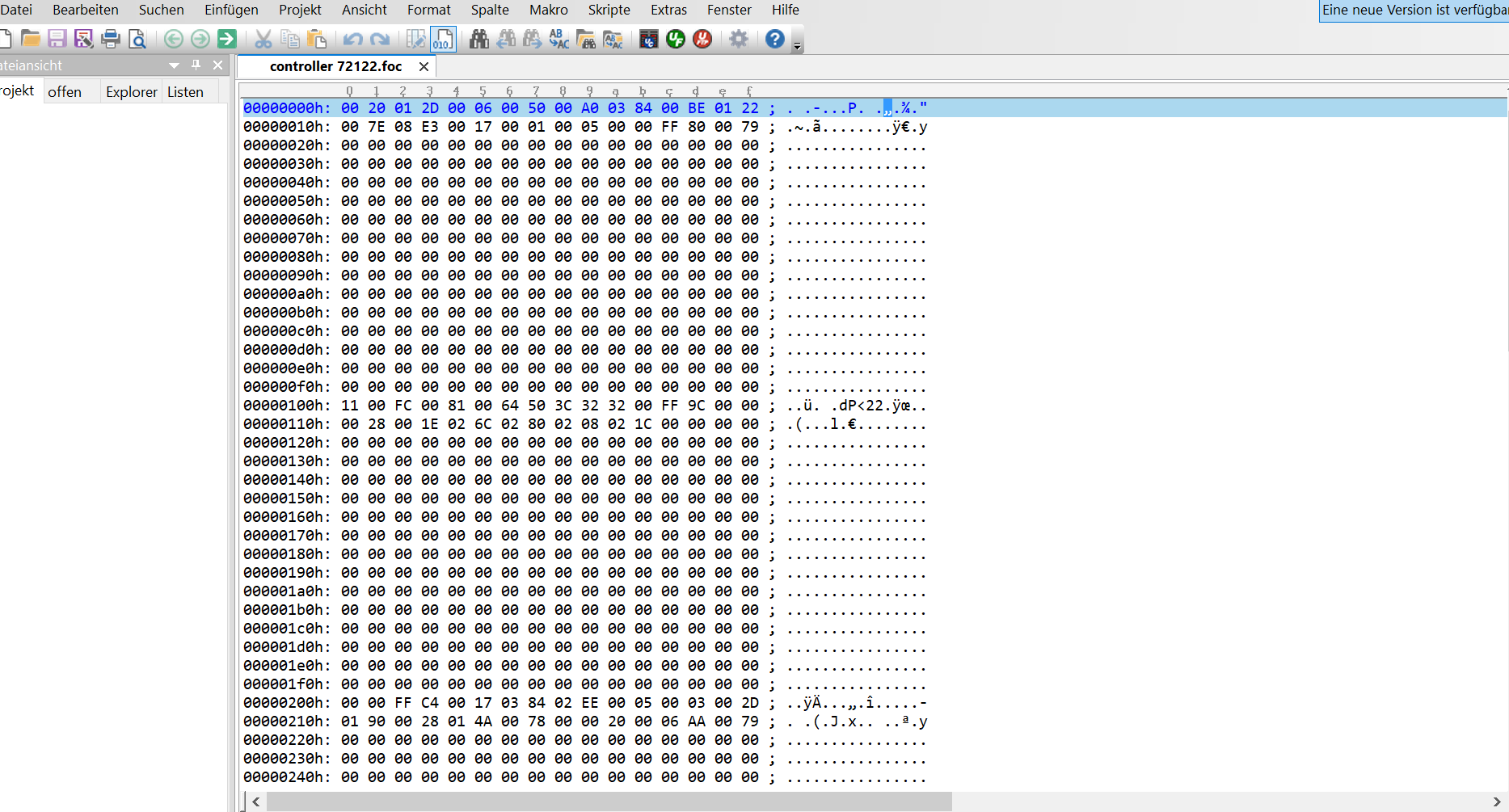

I have a new controller, it is suposed to be the Lingbo 72122 HK3A. Attached you will find the standard settings. And the FOC file. Do you know what Motor BEMF constant is? I cannot change it in the Lingbo software. I will try to decode the FOC file.

@deadropine
The FOC file do nothing with the speed limit. The only difference in your 072122 FOC file with the Tromox Mino FOC file are offset 001Ch:
072122: FF 80
Tromox Mino: 7F A0
FF (bit 8 = 1, activation "Throttle Upper/Lower Limit")
80 (bit 6 = 0, Motor BEMF Constant)
and current 072122 controller LB GUI settings.
072122: FF 80
Tromox Mino: 7F A0
