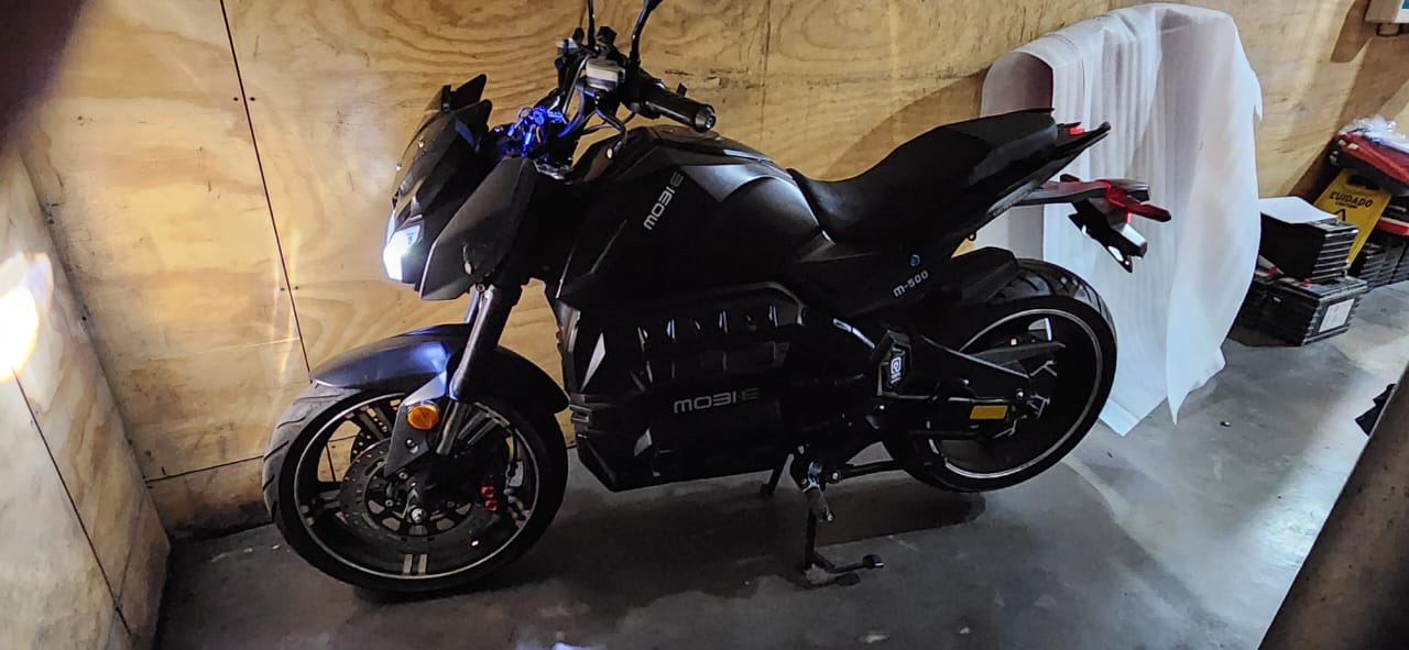

:arrow: This is my bike, I've had two crashes at low speed (10km/h), so you'll see that where the signal lights are, it's gray and not black like the rest of the motocycle

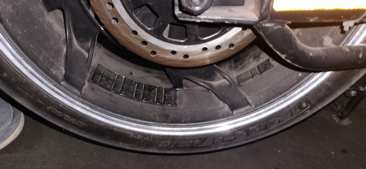

:arrow: Here feiben tire, year 2022. So its quality could have improved.. I think so...but I doubt it :lol: . You can see the amount of weights that had to be attached to improve the dynamic stability of the tire.

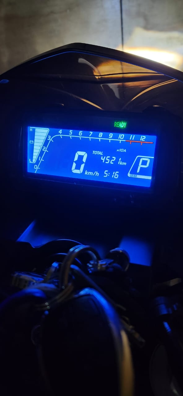

Speedmeter.
