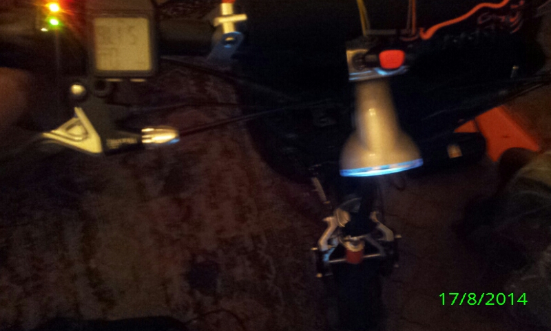

Hello
I discovered your forum yesterday and today I ran out. :shock:
This morning I normally share (fully charged battery and full).
At my first stop (I deliver the newspaper) no way to start, no juice. :evil:
I then put my second full battery and also I have some electricity (the front and rear lights and horn work) but no gas in the handle as if the engine was dead.
The decontrol seeing red green yellow battery lights.
Are you aware of this type of failure?
What can this be?
Thank you very much
