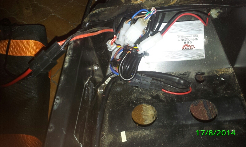

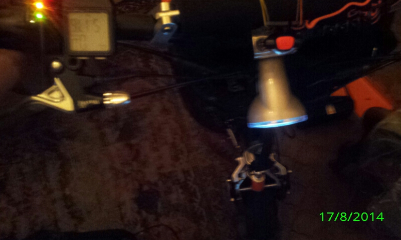

Beitrag von John_F-57 »
the dc-dc-converter is it ?
> everything seems connected
the lights work
> the handle rotates normally
I tried it with a new fuse, it's the same thing.
This battery is almost new.
Is it the engine?
Is the throttle?
In your opinion
Thank you very much ...

Beitrag von dirk74 »
Kann jemand aus dem Unterforum, der sich mit dem Mach1 besser auskennt, ihm helfen?
Licht geht (offensichtlich der dc-dc ok), aber der Motor bewegt sich nicht ...
It's obviously not the dc-dc-converter.
Without a multimeter it's hard to find the error. Buy one - it's not that expensive.
I'm not familiar with the Mach1. If it is equipped like a full sized scooters, trouble-shooting might be the same. Most scooters have a throttle which is supplied with +5V and depending on the angle it outputs a voltage from 0...5V to the controller. Check that (use your multimeter in voltage mode).
Check the lines and connectors from battery to controller that there is no interruption (use your multimeter in voltage mode).
Deactivate the fuse. Disconnect the three engine phases. Check the resistance with your multimeter from one engine phase to an other (use your multimeter in resistance mode). There should be no short-circuit (0 ohm) or no infinite resistance (kiloohms or more). Repeat with all phases.
If you are not familiar with electricity, better ask a specialist to assist you.
