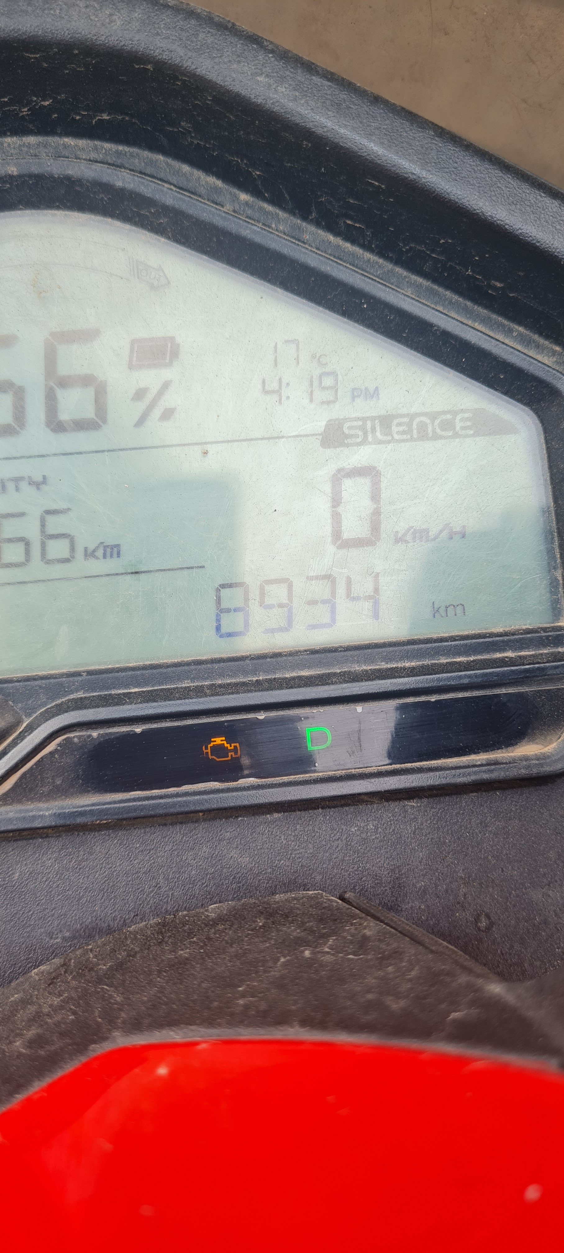

Hello, I received the cable today and I managed to connect the software to the Votol controller.
But I have only managed to increase the speed in the 3 modes.
I would like to be able to assign a speed to each mode, for example: eco=40kmh
city=70kmh
sport=maximum speed
Also, a light came on indicating some engines error.
Thank you all for your answers.
city=70kmh
sport=maximum speed

PAGE2 -> block "Three-speed"
As in the default settings, % are nearly the same as km/h, set the value in the left column for different modes, Low(%) = ECO, Mid(%) = CITY, Hige(%) = SPORT. You should read 31/50/50 per default, set to 40/70/100.
Read https://www.elektroroller-forum.de/view ... 80#p385080 for a full comparison of low and high speed settings.
Be aware of legal consequences. If you do so, it's on your own risk. We neither can prove that the S01 LS will behave like the HS version nor that this may not cause severe technical issues.
Watch the OBD (engine) fault, it should get off after the 5th restart. If not, and if you have any OBD diagnostic hardware (for cars etc), try to read the engine fault. I get a P1019 when it's getting cold, without any damages or loss in drive capabilites.
