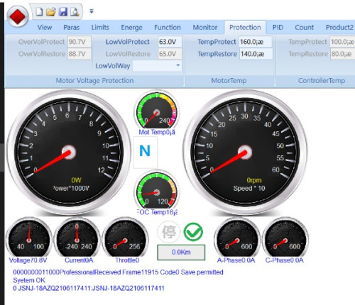

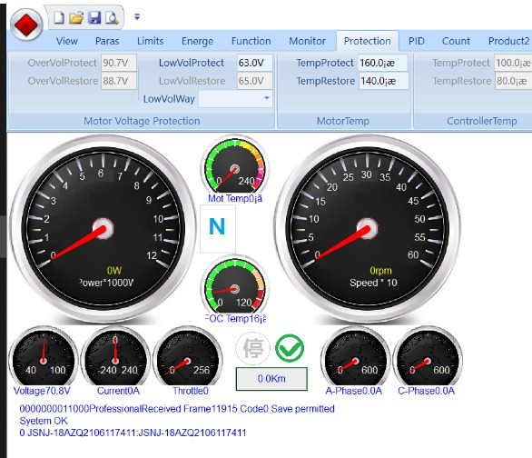

The USB lead I had seemed to work fine with my PC so I just plugged it in to the motorcycle and it all worked fine.
I cannot see any issues, apart from the motor temp is reading zero, which I can't see why that would cause a restriction as the battery voltage drops.
Battery voltage is slightly under what I think it is, but by fractions of a volt.
Controller temp seems fine.
These settings, this current battery charge, 'couldn't pull skin of custard'. Well, it can, just.
So, I am none the wiser.
At least now I have all the settings, so I can go ahead and swap with the new controller I have. Then, we'll see if it is some strange MOSFET failure, and not opening the gate fully.
If you can take anything out of these screen shots, I can give you any from the other menus.
'Mystery'.
