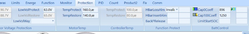

Does anyone know what those coefficients are at the far right?
"Cap0Coeff" and "Cap100Coeff", "LimitStartSOC"?
What do yours say on your controller?
I've no issue with power restrictions at the right voltage, I feel I just need to change the derating slope.

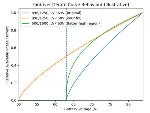

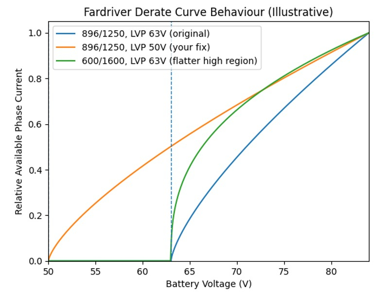

According to chatgpt (I'll take its output as guidance). it seems those are indeed the coefficients that control the ramp down.
I got it to arrive at this prediction. I can go test it, now.

The capcoeff are for the battery SOH Meter and the upper one can also stop regen before your BMS needs to cut.
The ramp is made with low vol protect and low vol restore and low vol way.
There is no current reduction until low vol + low vol way is reached.
I still have 1400A phase current and 400A battery current, when the voltage is above 65V. My low vol protect is set to 63V and low vol way ist 2V. I have 21S Li-NMC battery.
So if your battery is good you can set your low vol protect to maybe 3V/cell or even a little lower. But 50V is far to low. Your BMS will probably cut out during driving when your battery gets under 60V.
You can check the values out when you set your low vol protect to 2V under you actual battery voltage, than the controller limits current as soon as the voltage drops.
So you will see reduced power directly from the start.
