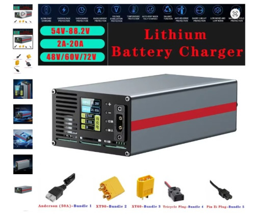

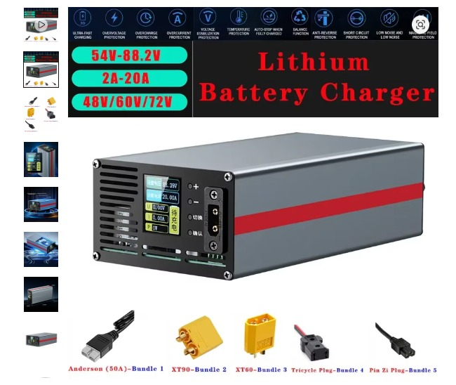

Yes, I also put an order in for one of those, too, but it got cancelled and I just never bothered again. I just charge up the day before I use the bike.MarcS hat geschrieben: Mo 11. Mai 2026, 12:37I want to charge 80% only most of the time, and once every two months charge up to 100% and let the balancer work.
You can get them where you can set both the voltage and current. Obviously, you set a lower voltage to achieve 80%. It will creep up to that voltage, as if it is in the slow constant-voltage phase of charging.
TBH, I did have a worry I might accidentally set it to more than 84V. So, I did not worry much about losing the order when they cancelled it. Like I said, I like my 8A because it is smaller than 10A and fits the tank box.
Like I say, I did not get one like that (and the one I got is not available now) but here are examples;-
(This is NOT a recommendation, just examples of what is available)
https://www.aliexpress.com/item/1005007633351010.html

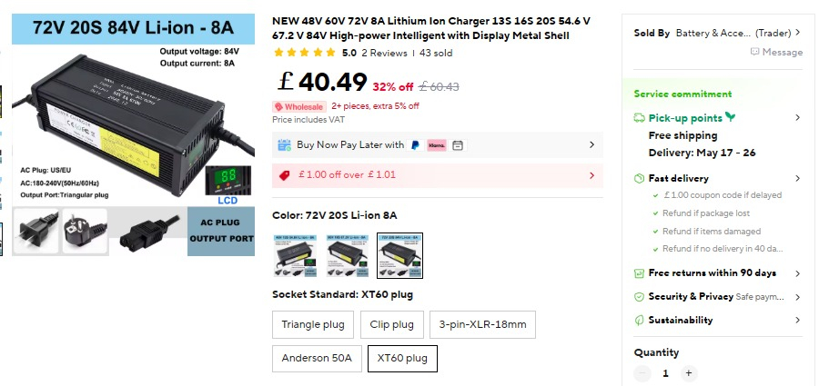

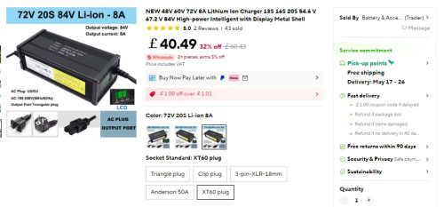

and here is an 8A charger, similar to the one I use.
