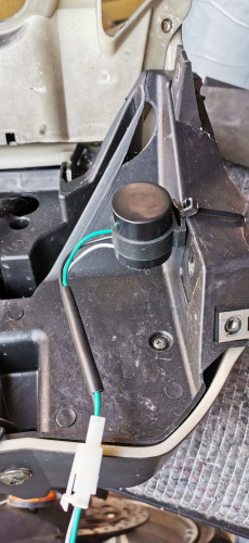

There are more robust flasher units available, and cheaper than the Dayi official offerings.
This works fine (for now, for ever? I presume it is a lower power handling), comes with a little rubber mount, and is fully potted.

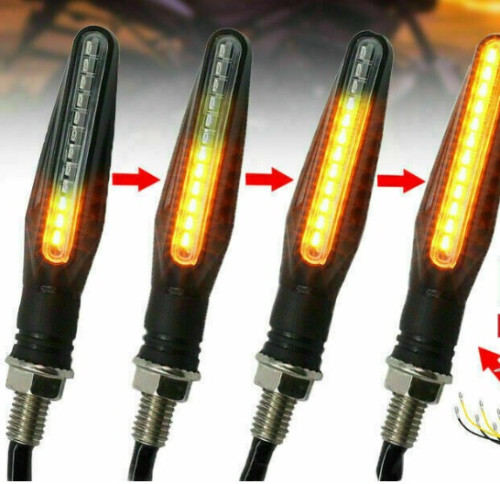

An alternative to replacing the flasher is to connect the lines so the light power runs permanently, and install this sort of indicator.
These require a continuous current signal, and do all the fancy flashing themselves with internal electronics.
So, you take out the flasher unit and connect at the connector. (I will figure out which leads, later.)
A flasher unit that is not there can not fail!
I am not too keen on this style, however, they will be brighter than the smoke-effect originals and also because on motorcycles the indicators are close together, this should help others see which way you are going.
I am doing this along with replacing the rear stinger for a tidy tail.
