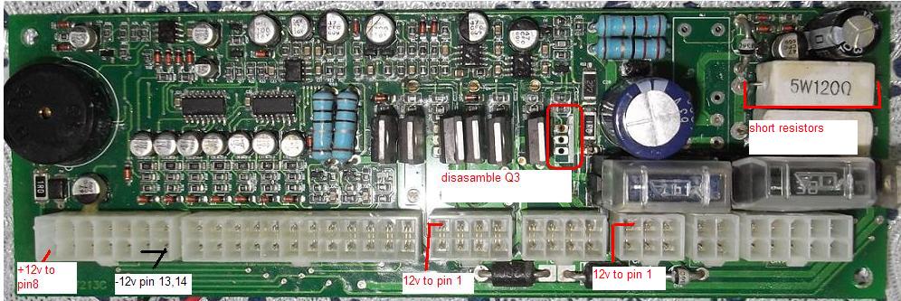

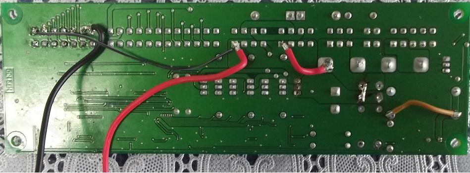

It is a 3 phase brushless dc motor with 120° angel. A controller is not a frequency converter. 72V and 37V cut off voltage seems to be okay. I think you need a seperatly DC DC 48V to 12V converter for the MSU (is to be modified) so the speedo meter will work.
The Q3 from the MSU is to be unsolder and a bridge over the 5W120Ohm resistor is to do. I would take a 48V 4,5kW Kelly. You can set the parameter with a PC and you have 2 years warranty..
