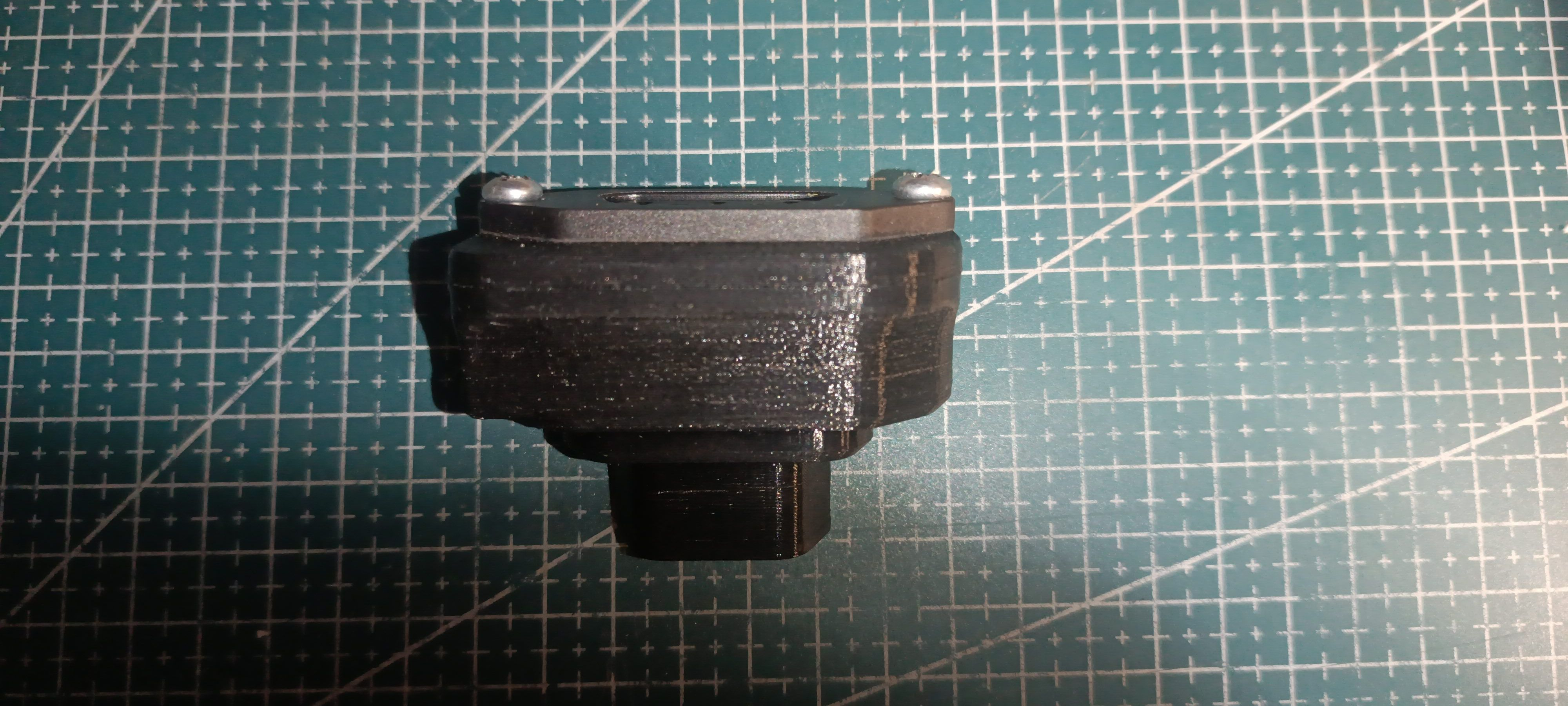

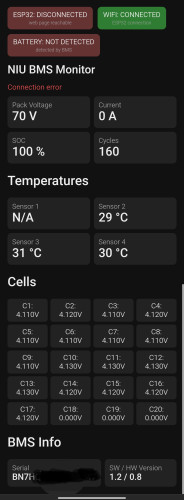

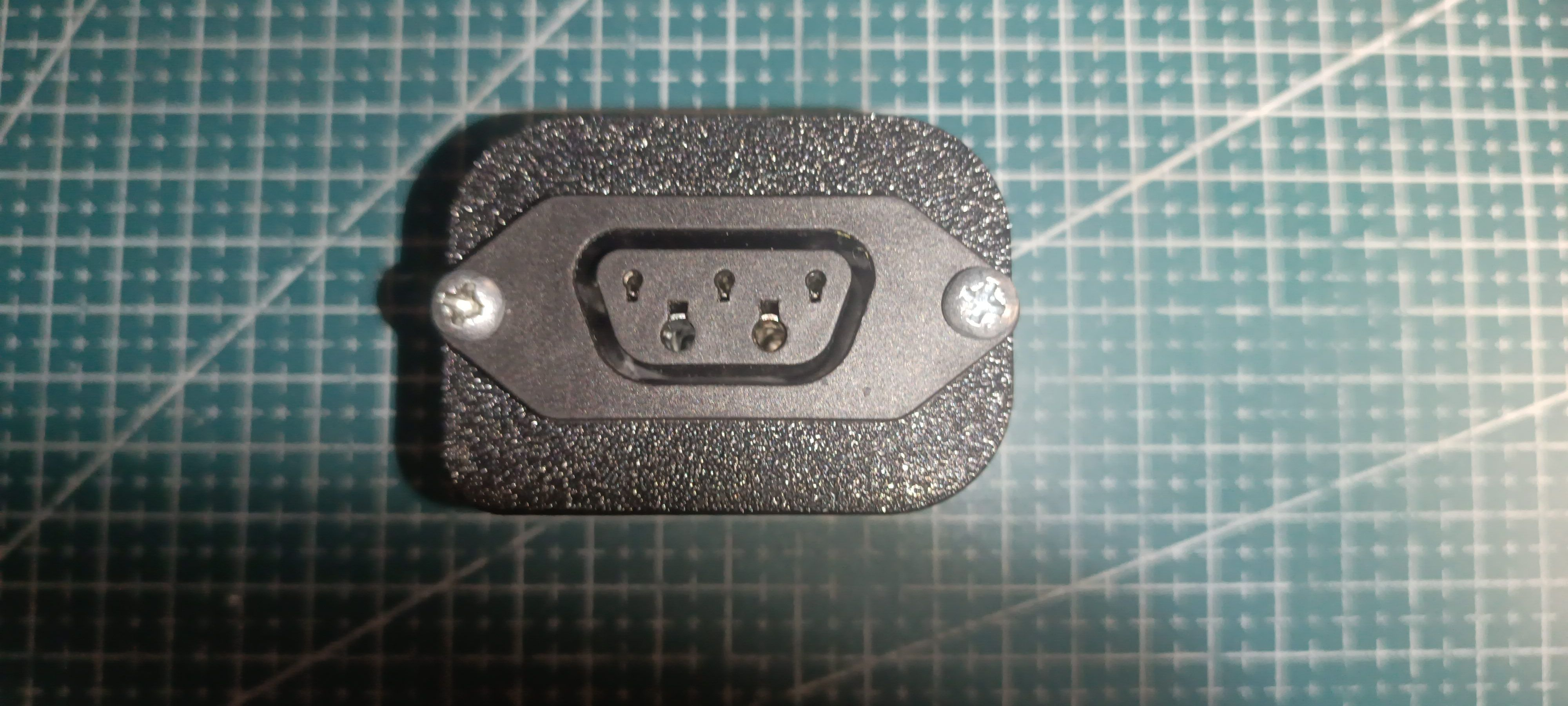

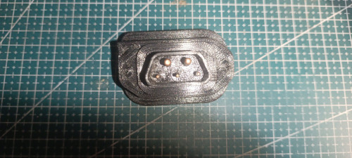

Hello everyone I needed to know the battery data, I built this object. It connects via wifi,I have all the battery information,even charging. Future implementations to be evaluated: connection to the smart home, for remote control or automation.

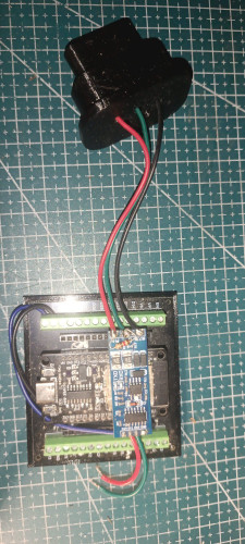

this was my proof-of-concept, it is based on an ESP32 and a module rs485.
proof-of-concept
proof-of-concept

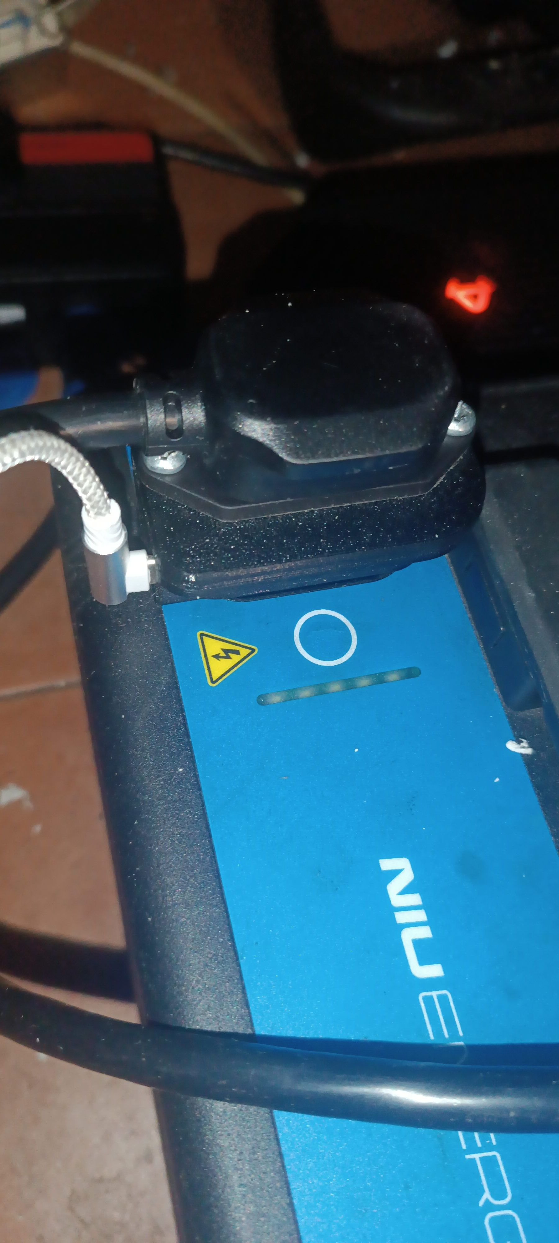

the final result, my first post, is to make it more easily transportable, robust and implement more advanced functions that ESP32 can offer, in addition to the reading of the battery data, the possibility of being controlled / connected to the network create automations, such as: during the winter, when the use of the bike is more limited, the possibility of keeping, the batteries, in storage mode.to avoid problems caused by the continuous complete charge provided by the charger, or vice versa by its complete discharge.with the possibility of reading the data, while it is charging, with the addition of the port for the charger.
in charging reading the data

I bought the socket, it has components that are difficult to recover. The socket and all the casing is printed in 3D.

on this project I focused more on batteries. the information obtained is live.with the possibility of being able to be saved in order to do SOH (state of health) of the batteries, I can not guarantee the accuracy, compared to the use/methods of professional products, I think it can improve the accuracy with a greater amount of data collected.these are the other features that can still be implemented with the current hardware, but I cannot guarantee their current success as I have not tested them.
