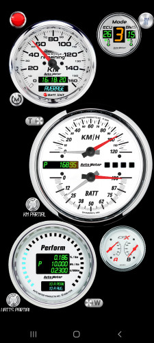

As a TC50 user and with a little help of a Telegram users of SuperSoco we have decoding the relevant messages of the RS485 messages of the T line of bykes and the CAN messages of the CPX scotters. We have spend the last year improving an unofficial Android app with this knowledge of internal byke messages and with a lot of usefuls features that each member suggest, as Firebase upload, MQTT and IFFFt control of chargers, etc, etc. We have all this info and app on the Telegram group and our github site, look for SuSoDevs ( i don´t know if links are allowed here ).
Not the 100% of the messages are decoded, but let me know what do you need and I will help you if they are on our list.
Our last Android version main screen:

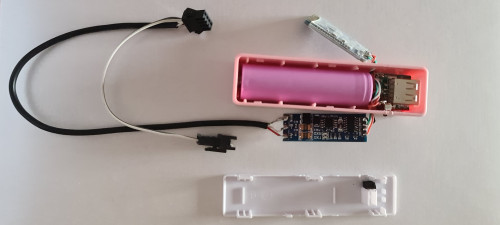

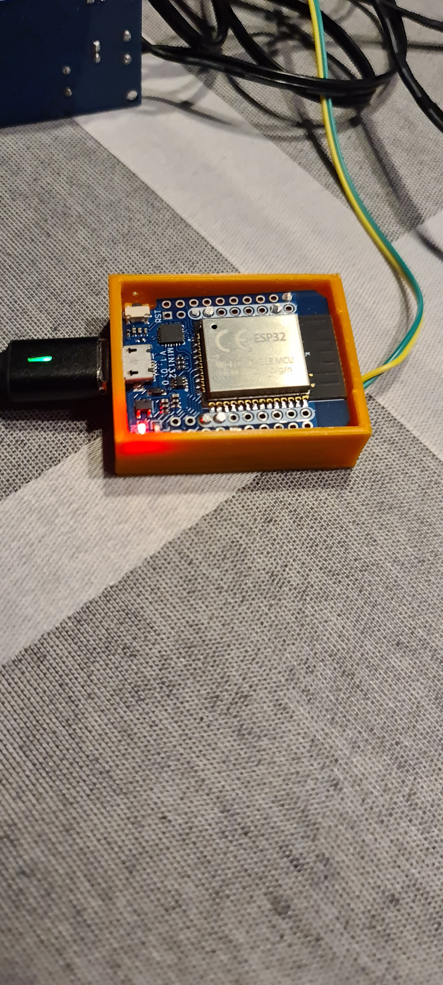

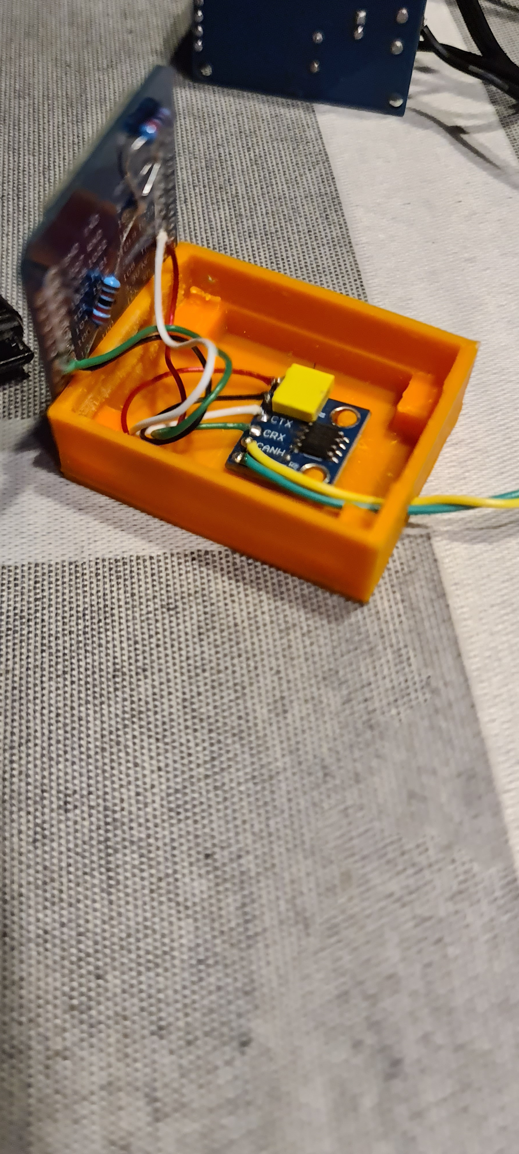

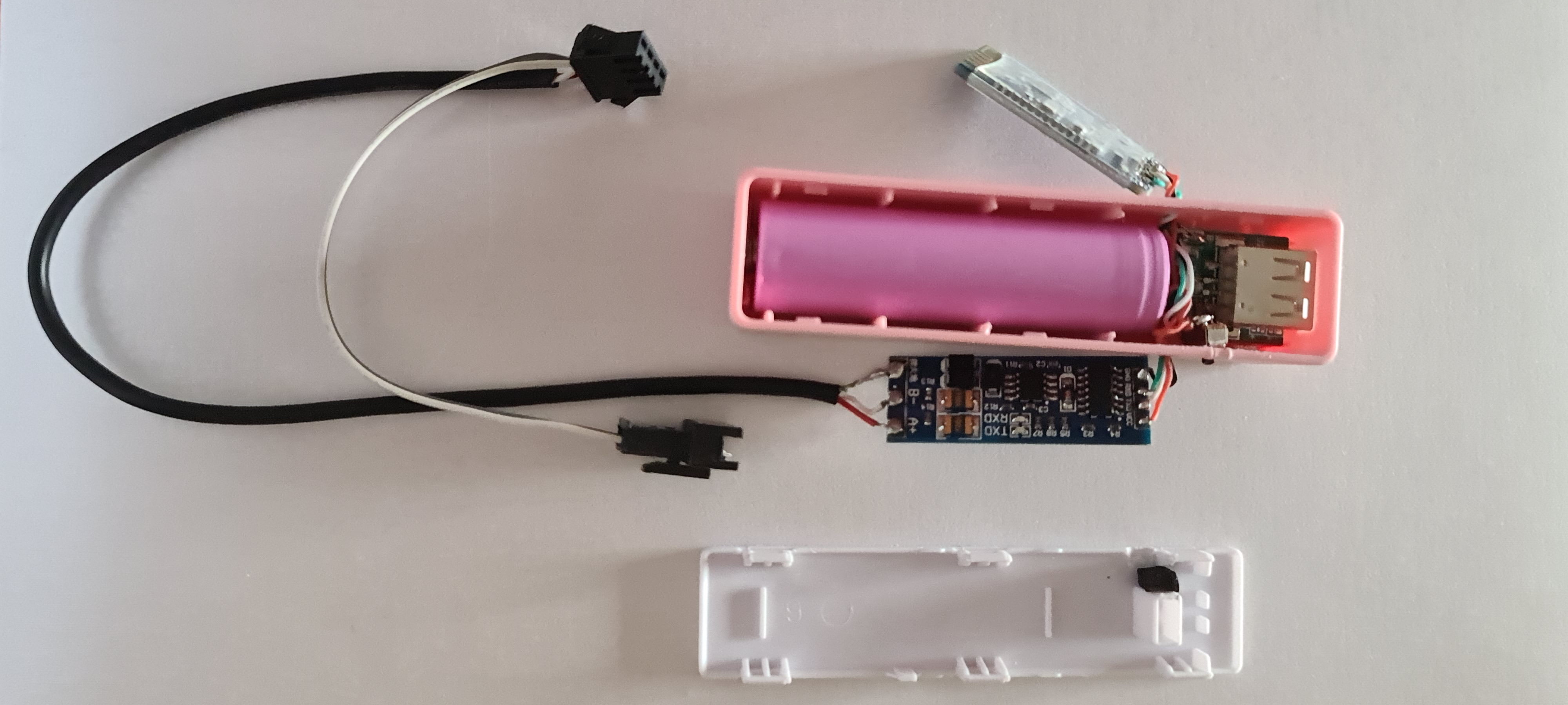

In the documentation you have all the relevant info and details of the interface needed. But answering your questions:
>>How do you do the connection between app and bike?
In the case of TC-MAX, TSX, TC50 and all the T-line that is the same RS485 protocol, we use a simple interface of two modules, one rs485 to TTL module with an universal Bluetooth v2.0 module, type HC-05. In the case of CPX that uses CAN protocol, we use a ESP32 with a litle CAN transceiver module.
>>Do you use a seperate µC and a bluetooth-chip?
Only for the CPX Can protocol, read the Hardware secction of the repo.
Hope you find usefull the app!!
