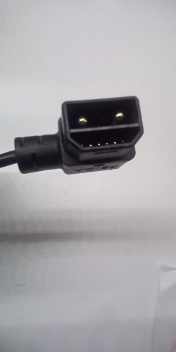

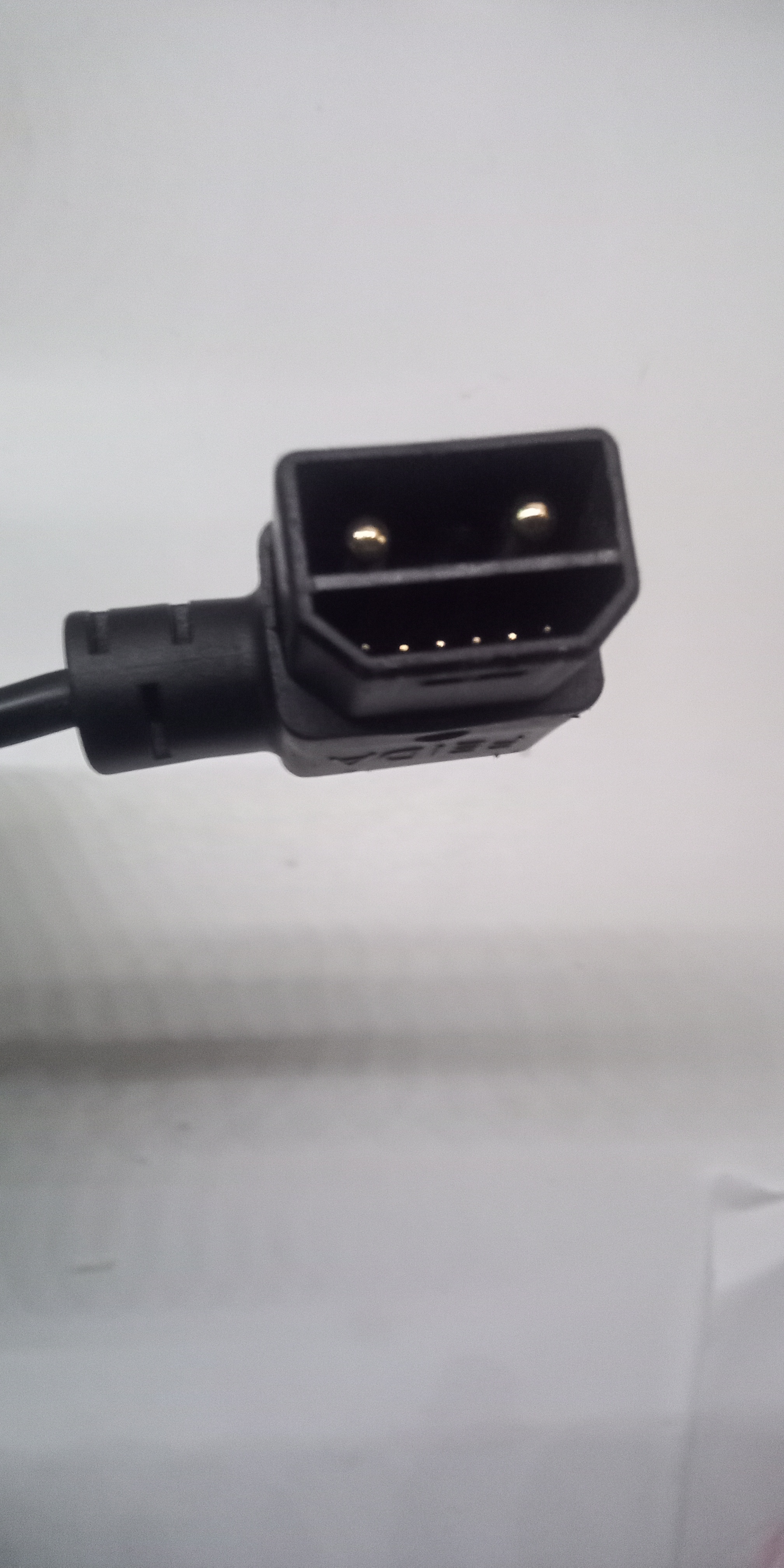

ok interesing ..... i made a foto of my plug i wonder is that the usual or does the 2.0 come with different ones (google says its called HG-F.B-Z850B custom made / rare ) ? since the link i posted the plug seems to be a different yet it is posted as a official part for the 2.0/3.0 so i'm a little confused ......
those chargers of yours what plug/connectors come with it ? i guess 2 ways to charge it, anderson plug is on the battery as a 2nd option
most chargers eg. on ali express don't even show the plug, so often theres no way to know ,
the easiest (to me) if there would be adapter for the various plugs, but i have not seen any so far, so how did you solve it anyhow getting the right plug ? so the easy part is to get one that supports "LI ION" + 84v , but the hard part seems to get the fitting plug (which for electronic nerds i guess is easily solvable as well)

The plug is the part that you have to work around, if you get another charger.
But those little pins do nothing and are not special. There is no 'communication' with the bike, other than a 'safety earth' contact that stops the motor if it is connected.
I guess, you could argue it is the plug you are paying for, with a 'genuine' charger. Some do come with that connector, I forget what it is called.
But I recommend considering replacing that plug and make your life easier.
I think that plug is terrible and badly placed. Mine has a different plug/socket fitted and they are better, easier and cheaper to buy so I just replace them on my chargers.
But, yes, solving 'the plug' is part of the problem of getting another charger.

If you want to use the genuine charging port (at the rear, underneath the seat), you can use a conversion cable or use a male 2+6 plug that fits.
But I wouldn't risk more than 15A current (20A should be the nominal limit for this kind of connector, if you trust chinese specs :roll: ).
You can find a lot of them at AliExpress, like here, here or here (just a few examples).

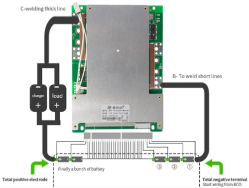

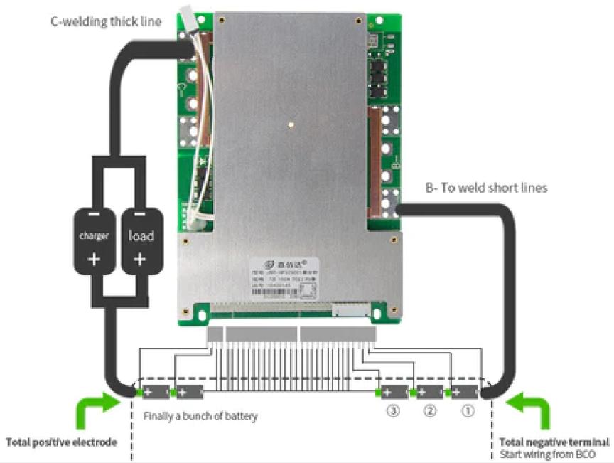

So, the charge port is basically just exposed battery terminals (via thin wires)?
The thing is this; I was considering installing a few extra batteries in my top box with an 'ideal' active diode from them to the battery. If I were to do that, I might as well run a new charge port to the back of the ideal diode, then it'd not only be safer but I know what's actually going on.
If there is zero extra protection using the charge port, then maybe there are better solutions. Is that right? It does nothing (for safe operation), using the charge port than the battery terminals?

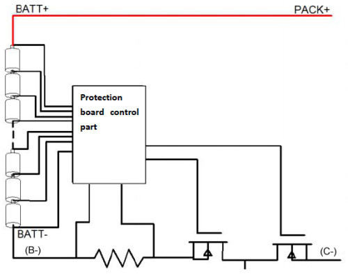

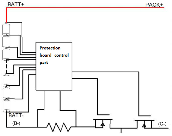

I thought the BMS could shut off an over-voltage/over-charge scenario.
Yes, why shouldn't it?
There are still some MOSFET between the cells and the negative battery terminal (C-).
So the BMS still can do it's job to protect the cells and cut off power if there is a shortcut or overload (>150A) .
bob2.0 hat geschrieben: Sa 16. Mai 2026, 09:47 ...
Exactly. Just yesterday, I measured the cable cross-section for the charging port, it is approximately 4 mm². So the charging port ist fit for about 40A.
This aligns with the types of chargers that DAYI previously offered: the standard 10A charger (which is included with the bike), a 25A model, and even a 40A model.
However, as far as I recall, the 40A model was subsequently discontinued.
The "battery connections" on the large, heavy-duty Anderson connector consist of the positive terminal of the cell packs (the thick red 6 AWG cable) and the C-terminal (the black 6 AWG battery cable) of the BMS.
So there is still protection.
