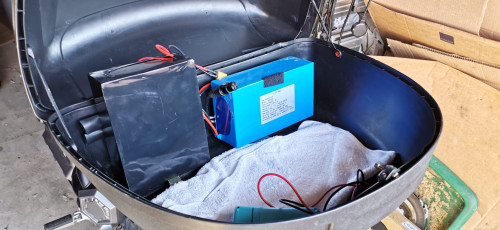

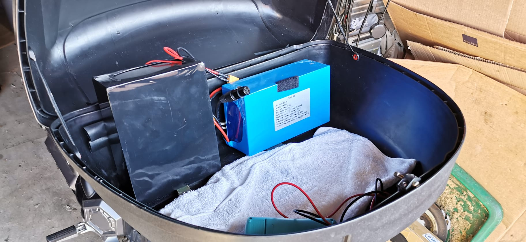

I was aided in this extra speed by having installed an extra 16Ah in the top box, from batteries I have bought. I have some more on the way, they are 2 x 10s8p, listed as 30Ah, but I doubt that. Maybe 20Ah. The Aliexpress listing says they are 3.5kg each, which is 16~20Ah by mass of '10s'. (I've bought 10s because my pedal bike uses 36V, so, this way, I have a variety of batteries for both my pedal bike and the e-Odin.)

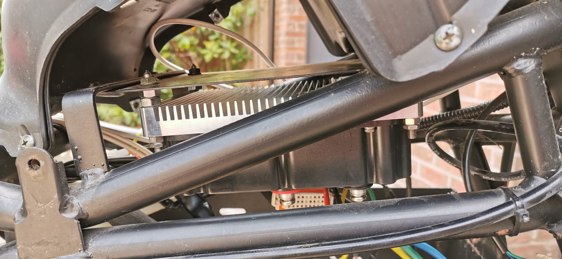

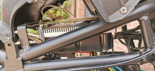

What seems certain now is that before I was limited by the controller derating. Now, it does not seem to derate at all, and TBH my bigger concern now is whether it might actually drive the motor long enough to cause that to overheat? The weather was mid-20s, and as there seemed to be no controller temperature issue, then I think my 'gap' (heat sink suspended under metal plate by a cm) is sufficient and I'm not currently seeing a need for holes or active fans.
