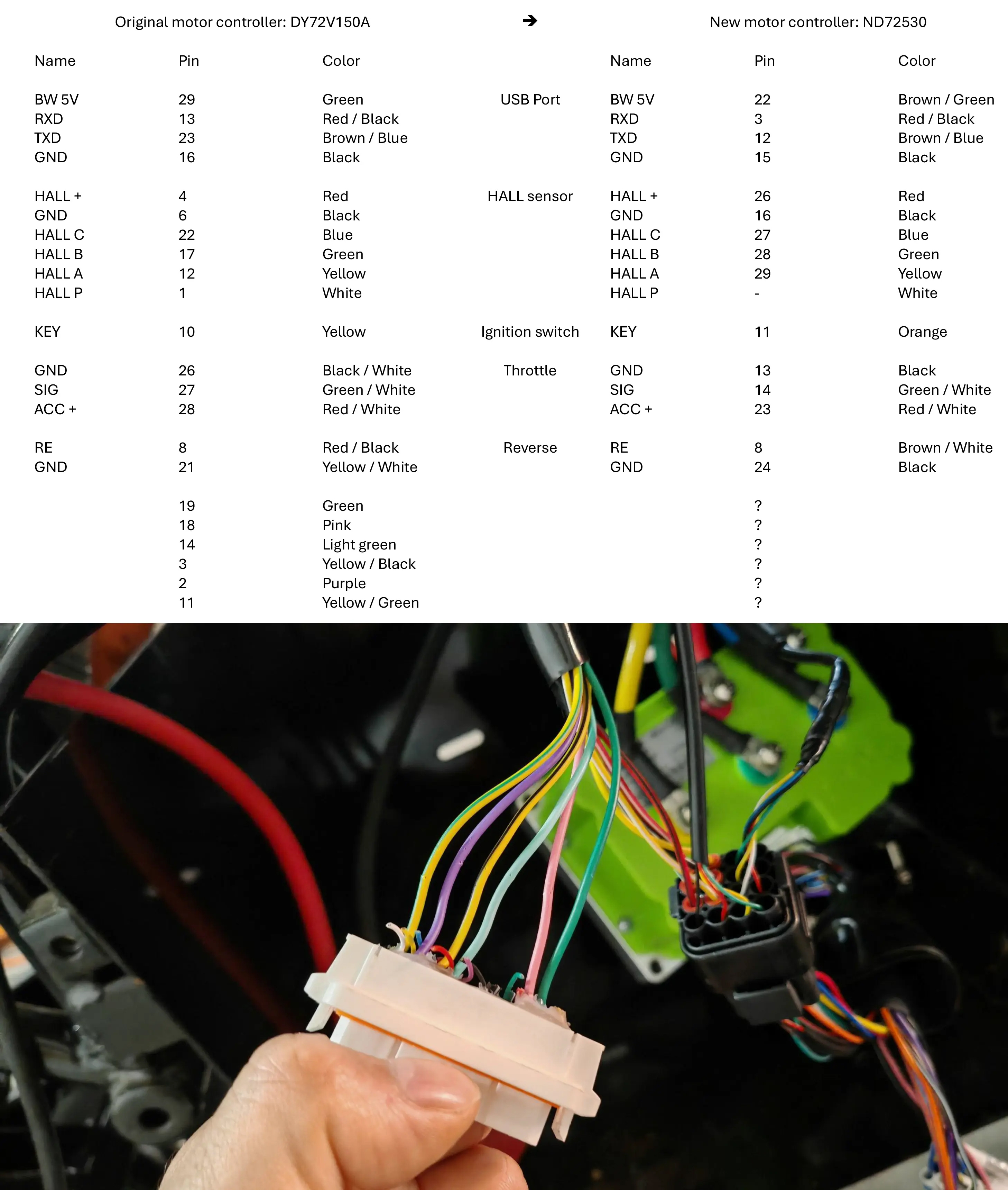

Hello, I have started replacing the original DY72V150A motor controller with an ND72530. The pinout of the two motor controllers is different, so I am making new wiring. I have been making good progress, but now I have run into an obstacle, I don't know how to wire the S (gear) and P (parking) buttons. I have made a table of the work I have done, and I would like to ask for help in completing it. Thank you.

Stand das mit dem -AMR schon immer in Deinem Profil ???
You do have an E-Odin 2.0 with AMR and want to use an ND72530 ???
This will not work (as I recently discovered with the defective bike I bought at easter).
The AMR Motor Version needs an ND72680b, because the AMR motor has an encoder instead of hall sensors.

I just swapped the controller straight over, did not change any wiring.btcenter hat geschrieben: Sa 8. Aug 2026, 11:02 Hello, I have started replacing the original DY72V150A motor controller with an ND72530. The pinout of the two motor controllers is different, so I am making new wiring. I have been making good progress, but now I have run into an obstacle, I don't know how to wire the S (gear) and P (parking) buttons. I have made a table of the work I have done, and I would like to ask for help in completing it. Thank you.
I am not sure your table is credible (whether for AMR or not). Why do you say the pinout is different?
